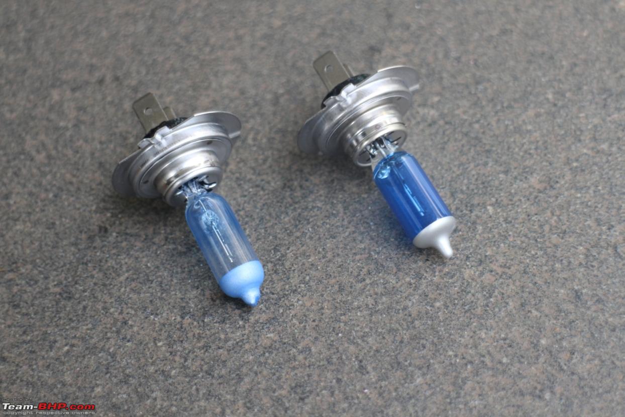

Was trying out 2 types of bulbs which were readily available in the market, for Yeti's fog/cornering lamp - H7. I was looking for Osram NB unlimited but was not easily available, so tried out the available ones meanwhile. Just sharing the results below...
H7 Bulbs - Philips Blue Vision Ultra 4000 K and Osram Cool Blue Intense (Hyper white edition) 5000 K
Auto Lighting thread : Post all queries about automobile lighting here-img_1983s.jpg
Color - This one looks whiter than stock but still yellowish. Not a perfect match with the whiter OE xenons which are around 4,300K.
Light output - Much better light output compared to the other bulb. Not just marginally better but very noticeable improvement over 5000K bulbs.
Verdict - Scores on performance but not the perfect replacement for fogs to match OE Xenons.
Color - This one looks white. Not so bluish but a little more whiter than the xenons, so not a perfect match with the OE xenons which are around 4,300K.
Light output - Not happy with the output. You can barely make out that the fogs/cornering lamps are ON if the Xenons are ON. If it is on a rainy night, it is pretty useless.
Verdict - Scores in aesthetics but poor on performance.
There are some bulbs like Philips Crystal vision, Osram NB unlimited, etc. which are claiming color temperature in the range of Xenons (OE). But these were not readily available as mentioned above. Osram distributor even said that they don't have the NB unlimited in H7. I guess I will have to find an alternate source to get these bulbs. Will share the results once I get those bulbs. Thanks.
ajaypjayaraj is offline
