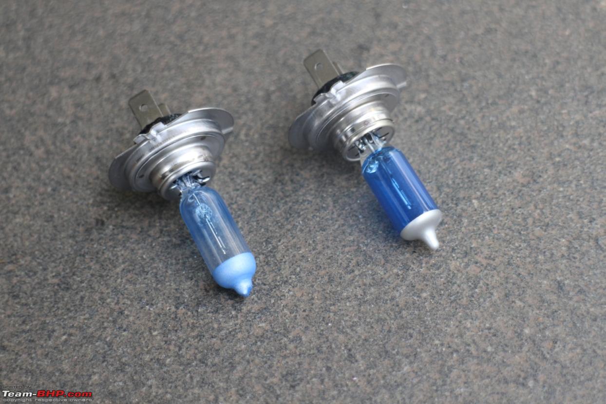

Originally Posted by ajaypjayaraj View Post
Was trying out 2 types of bulbs which were readily available in the market, for Yeti's fog/cornering lamp - H7. I was looking for Osram NB unlimited but was not easily available, so tried out the available ones meanwhile. Just sharing the results below...
H7 Bulbs - Philips Blue Vision Ultra 4000 K and Osram Cool Blue Intense (Hyper white edition) 5000 K
Attachment 1274505
Attachment 1274506
Color - This one looks whiter than stock but still yellowish. Not a perfect match with the whiter OE xenons which are around 4,300K.
Light output - Much better light output compared to the other bulb. Not just marginally better but very noticeable improvement over 5000K bulbs.
Verdict - Scores on performance but not the perfect replacement for fogs to match OE Xenons.
Attachment 1274507
Color - This one looks white. Not so bluish but a little more whiter than the xenons, so not a perfect match with the OE xenons which are around 4,300K.
Light output - Not happy with the output. You can barely make out that the fogs/cornering lamps are ON if the Xenons are ON. If it is on a rainy night, it is pretty useless.
Verdict - Scores in aesthetics but poor on performance.

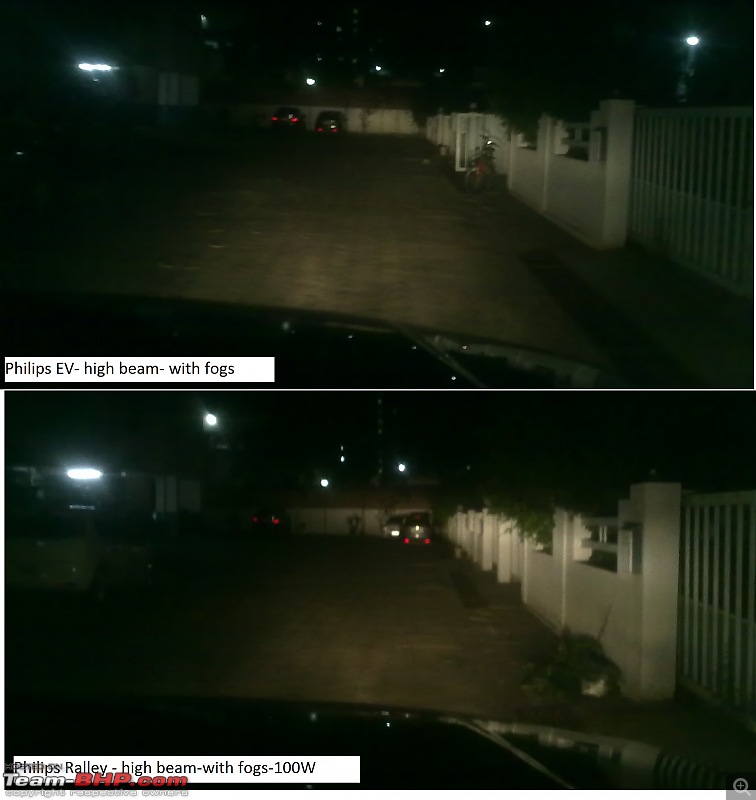

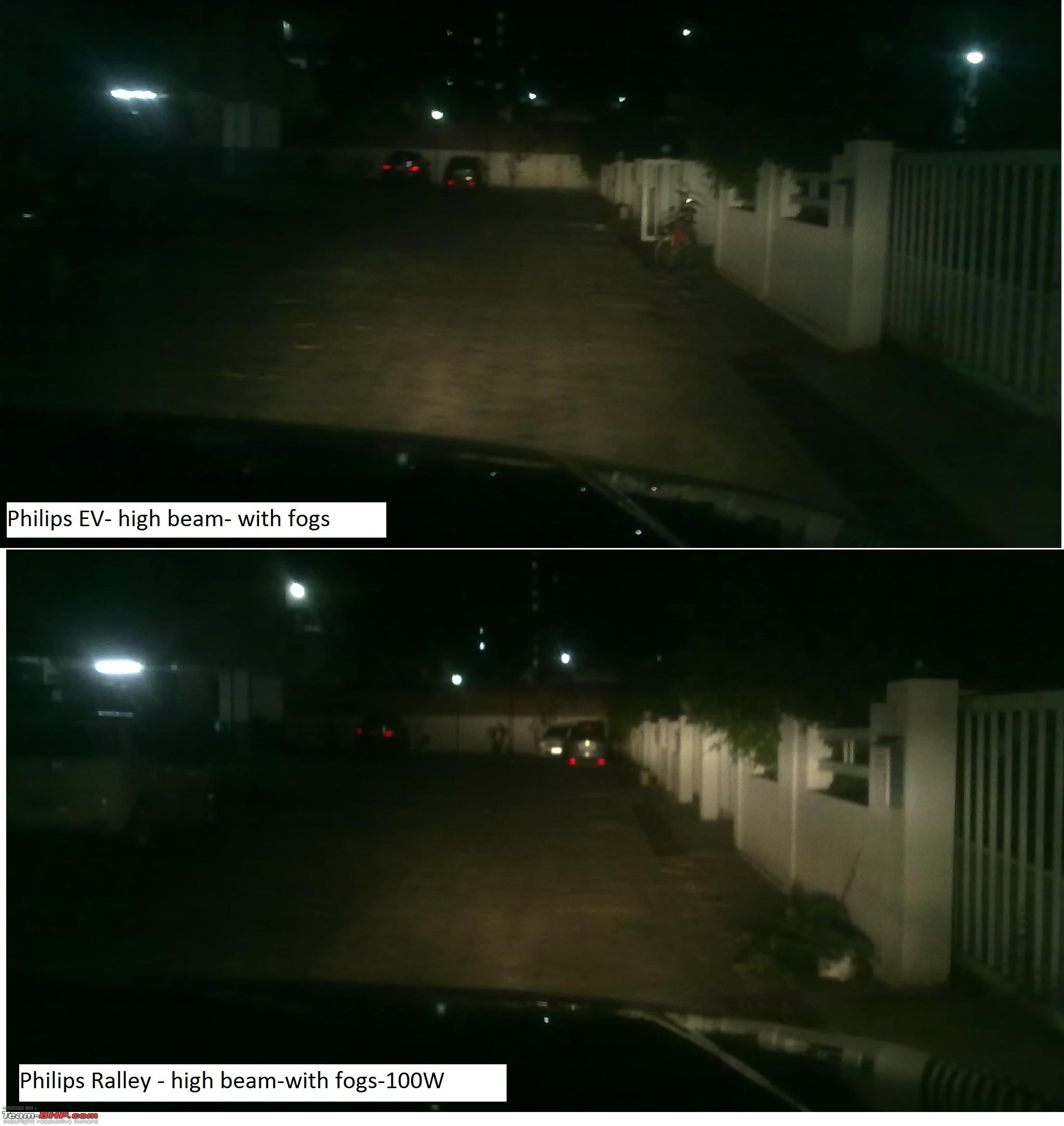

Finally Upgraded my Safari's stock 60/55W-which were upgraded to Philips EV60/55W; with a 100/90W Philips Ralley recently with a Roots wiring Harness. This was done over a month ago, uploading the pics now.
Here are the pics of entire process (Well not all of it).
Decided to drill small holes to let the wires in, after marking the exact up & down position of the cover.
Drilled the hole, let the wires in. Drilled an additional hole to take the output for the controller that goes in to relay to switch Hi & low beams. I have not loaded the pics but sealed the holes with heavy fevicol to keep it air-tight.
Connected all required wiring. Have not uploaded the pics of connecting wiring harness.
Uploading the comparison pics directly. Last four. Both old & new, high & low beams with & without stock fog lamps turned on.
Any comments/suggestion to improve it or pointing out any error, are most welcome.

Auto Lighting thread : Post all queries about automobile lighting here-high-beamwith-fog.jpg

There was no need to drill back covers. Now the problem is water will seep in to headlights and will ruin it. Fevicol is solvent in water. There was another way which may take 30 mins more by taking out light but more efficient

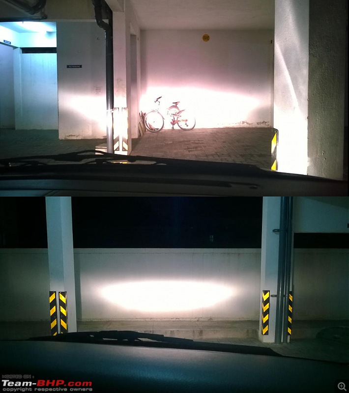

Since now I could shoot pictures in manual mode with my phone, I shot a comparo of Osram NB in my WagonR and the Rallys on the SX4. Used the same exposure and ISO, ISO400 and 1/25s shutter speed. Here is this for those who want to know the difference:
First the low beam. On top is my SX4 and below WagonR.
Auto Lighting thread : Post all queries about automobile lighting here-lowb.jpg
Both lamps have good spread, and the center is bright. However, as we go towards the edges, the Rallys give a more consistent spread. Hence the NB is Good for the city commuters IMO
