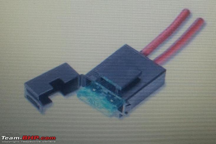

Does anyone know where I can source a fuse box like this one in Bangalore?
I can find the actual fuse, but not a single fuse box like shown. I tried JC Road. This is of the auxiliary lights on the car. The fuse box has actually melted along with the fuse. So both need to be changed. The lights are 100W with complete wiring kit, relay,etc. Advise on how to prevent this from occurring again is appreciated.
I found these at a spare parts shop. The holder was decent but the fuse looked bad hence I got them separately from the same shop.
Could you tell me which spare parts shop you got it from in Bangalore? Also, how many amps was the fuse?
When you say the fuse looks bad, do you mean the quality of plastic?
Any idea if increasing the amps on the fuse would prevent such an issue? Why is it getting so heated up in the first place? Did you also face the same issue?
I got it from a rather big spare parts shop near M M Industries, KR Road, BSK.
The fuse provided was of 30A rating. However the quality of plastic moulding as well as the metal on the contacts was looking dirty and corroded which pointed towards bad quality. Hence I threw the fuse provided with the holder and brought a separate fuse from the same shop which I used with the holder.
This was used in rewiring an old bike so I used lower rated fuses. Didn't use this for any lighting related purpose. It can get heated or melt due to multiple reasons. One is if the quality of plastic is bad. Two is if there is continuous arcing in the contacts which generates a lot of heat. Three is if the wires aren't meant to handle such high current. Hence, increasing the fuse rating has nothing to do with reducing heat. Rather its unsafe to overrate a fuse since the fuse is supposed to burn at the moment current draw crosses the normal limit. Hence, check out all the factors and then decide on the action plan.
If you can manage to get Bakelite or ceramic holders for the fuse, I guess they can stand more heat.
Else, use two holders with two separate fuses for left and right lamps. This will split the current and hence split the heat too.
