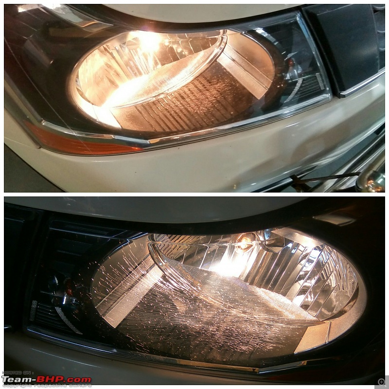

Hi,
Look at these pics of my Xylo's stock headlights, both were about 1 year old, and we're replaced under warranty. These web like patterns started to appear about 6 months after I bought the car. However the replacement headlights have not developed such patterns till now and I hope they won't in future as well. Even while they were replacing the headlights I rejected at least 5-6 of them as they had black spots on the inner chrome strips. So, OEM = Quality may not always true, but OEM = Peace of Mind is usually always true.
Headlights are very important components of a car both aesthetically and functionally, so choose OEM.
However if you don't want OEM, I would suggest:
1. Go to the Mahindra spare part dealer, usually they keep both, OEM & non-OEM. You can visually inspect the product before buying and can check quality beforehand. Prices will be lower as after GST online product prices have increased significantly and you will get some warranty even on the non-OEM headlight.
2. A lot of shops and scrapyards sell refurbished OEM headlights for as low as 30% off the actual price. You get the original stuff for a bargain. I usually do this for older cars of mine. But this could be time consuming.
Also you said the front glass is deteriorated, could you elaborate? If it's the white smudge that appears on the headlights, you may try the toothpaste trick to clean it.

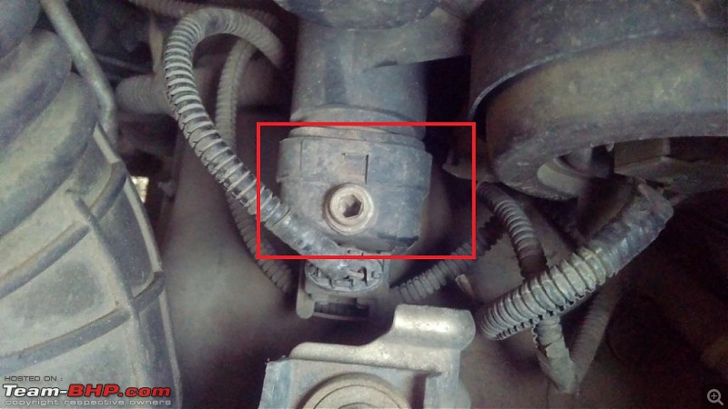

the difference may be because some of them come without the headlight leveling motor - i have been given conflicting information about whether the motor from your current HL can be removed and fit into the new assembly.
industrybuying seem to have a lumax assembly. Lumax is a more established vendor, and the cost is only slightly higher
please check with the your mechanic about swapping leveler motors, and if they can't, confirm with the seller if the hla comes with its own motor before buying
Auto Lighting thread : Post all queries about automobile lighting here-img_20170722_183011.jpg
Auto Lighting thread : Post all queries about automobile lighting here-img_20170722_183045.jpg
The above pictures are of RH Headlight. As seen from the above pictures, I think the Motor can be removed and fitted to another headlight i.e. it can be swapped. There is a Removable Lock seen above the Headlight Level Adjuster Screw. I will check tomorrow in daylight.
Thanks for the M2All Picture. I have checked M2ALL and spoke to Customer Support. He replied that he will revert to me on Monday as the Relevant Team is not available.
Thanks, I'll check that out.
At least for M&M & Maruti, the leveller motor is swappable, and comes as a separate unit, not part of HL assembly.

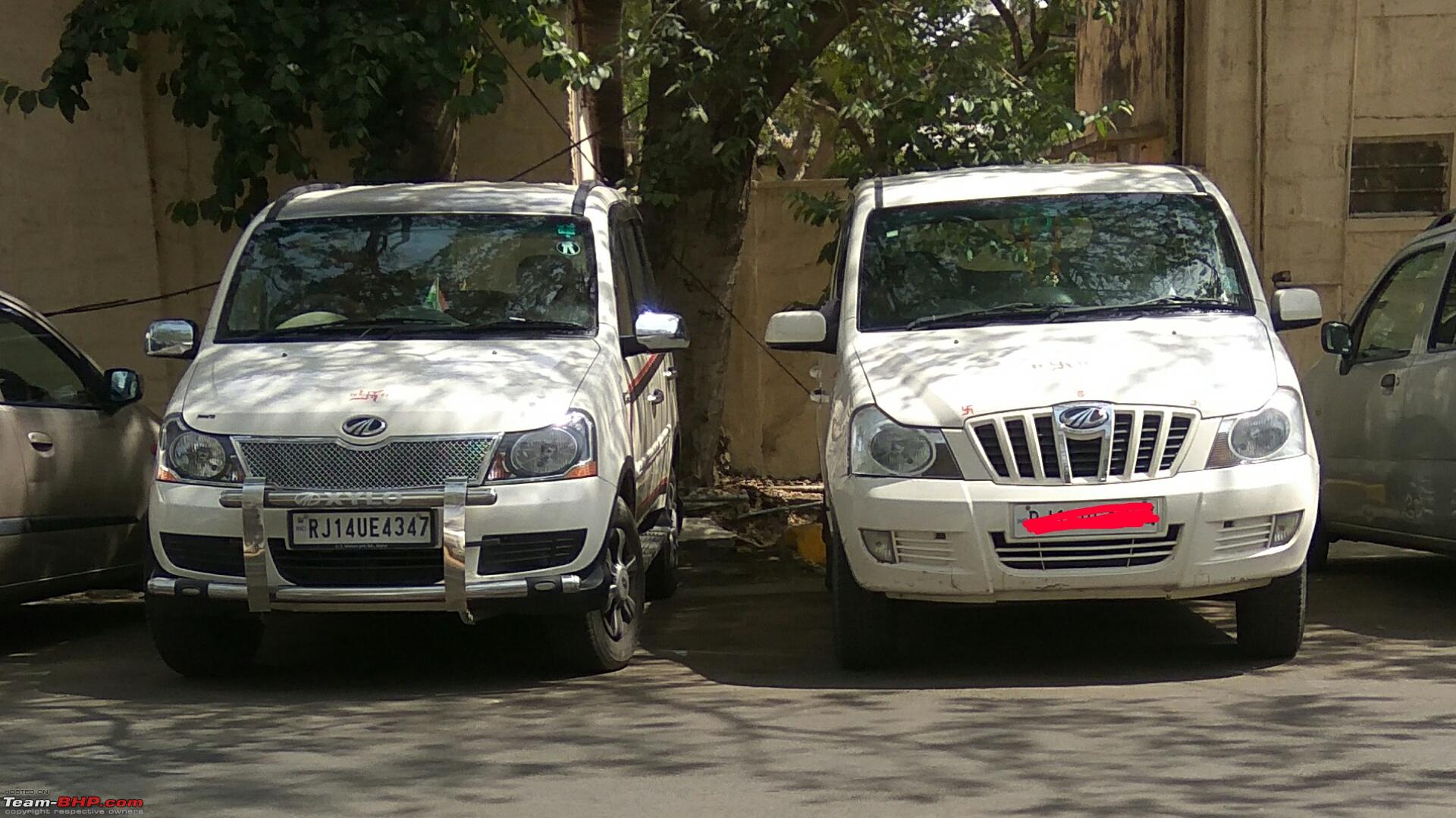

Originally Posted by IndigoXLGrandDi View Post
BTW, I would like to fit the Headlights of Refreshed Model if they are compatible (the mounts match) with our Xylo and the price difference is not much.
Yes they are compatible I believe as I have seen a couple of 1st Gen Xylos running on the new gen headlights. Price as per m2all is ₹4105. But do buy after visually inspecting them as I had to reject atleast 5-6 before choosing the one with the least flaws.
Posting a picture of my Xylo, you can compare new gen headlights vs the old gen. New gen definitely looks way better.
Also check OLX, search under spares parts category you might find people around your area who can provide you a better deal.
