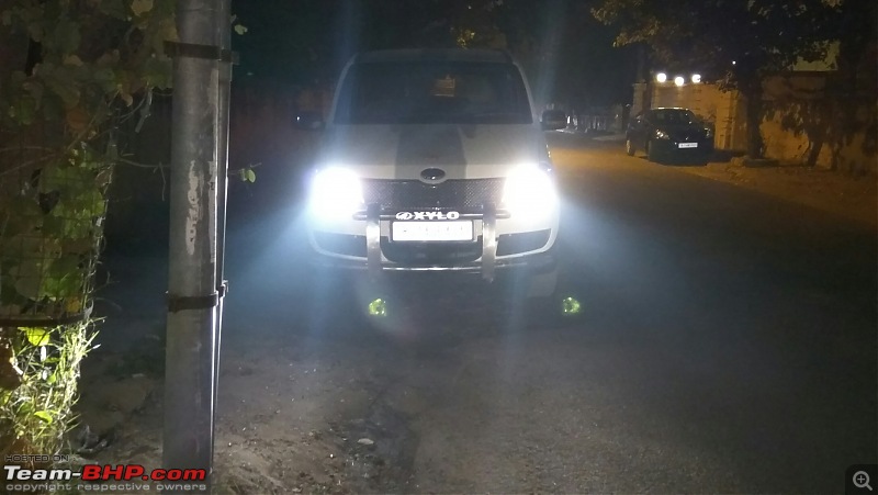

I had installed Philips H4 X-treme Vision Plus car headlight bulb (12V, 60/55W) in my Xylo last year, and though the gains maybe be marginal but are significant.
I'd bought them for ₹206 each from cloudtail, amazon last year in October.
On long straight highways on highbeam the two headlight beam spots are clearly visible.
Color temperature is 3700K and doesn't hamper visibility in rain or fog.
Posting head on pics of headlight to give color comparison between stock and upgraded headlights, though I could not take pictures to compare there different beam and spread patterns, I can assure you the throw and spread of X-treme visions give you significant gains over the stock. Even in these pics you can clearly see the spread of X-treme vision is better than the stock Philips 60/55W that came as stock.
Auto Lighting thread : Post all queries about automobile lighting here-img_20170806_114151.jpg

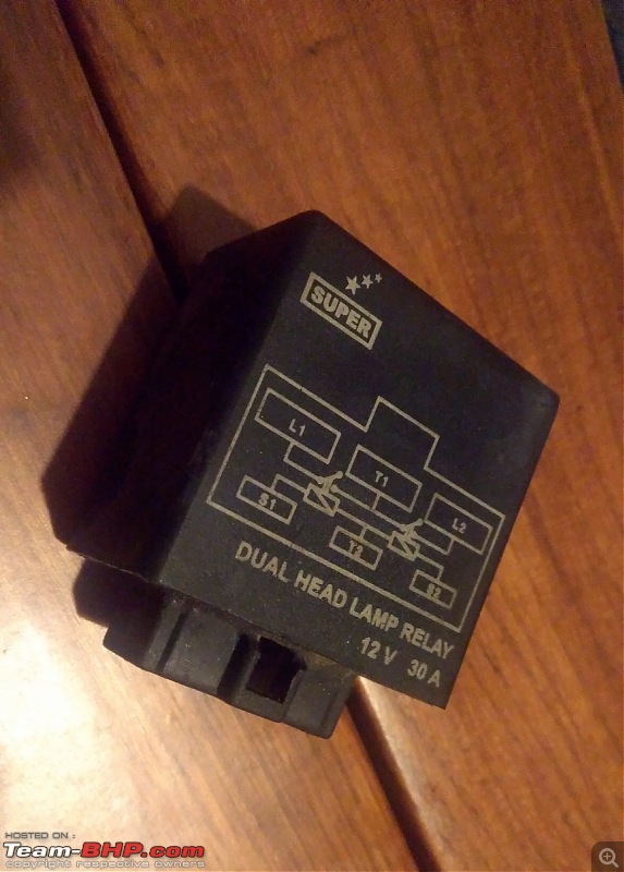

It seems the relay box of my alto has conked off. The electrician asked me to source just the relay box(12V, 30A) and said rest of the wiring can be used as it is. Is it possible just to source the relay(Not the entire kit)?
If so, could you please suggest some places in and around south bangalore where I can source the same? Are there any particular brands?
Very much possible to get just the relay at any Automobile spare/accessory ship and that would cost you around 200-300 INR only.
Regarding Brand, generally you may not get the same make as your Kit but whichever you get should work. Just make sure you carry this with you to get the right one. I see that what you have is "Super" which is quite popular and you should get the same as many stock these.
JK Automobiles on JC road is a popular shop. So is Popular Automobiles on AM Road (Off JC road). However, even a good accessory shop should be able to sell you just the relay.
You can try other brands like Roots or Phillips if you don't get the above said brand. Any automobile spare part shop should be able to sell you this.
