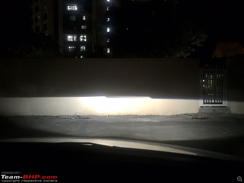

Guys!! My electrical issues don't seem to getting resolved and it is driving me nuts.
So as mentioned earlier, I got the HID wiring kit changed to Morimoto on Sunday and upgraded the car's headlight high beam fuse to 15A. Everything worked absolutely fine. Used the car on Monday and on returning from work in the night and after say a 15-20 minute drive the high beam fuse blew again. My installer asked me to upgrade the fuse to 20A but if it blows again then not to go any further. I did the same on Tuesday night and again everything worked fine.
Now here is the weird part! Last night while driving the car again for like 15-20 minutes; both high beams failed again but this time the fuse has not blown. How do I know this? Because the high beam indicator is showing on the dash board when ever I use the stalk to flash or move it to high beam position. Unlike before, the low beams remain ON whether I move the stalk in flash position (before only RHS high beam used to work) or whether I move the stalk to high beam position (before RHS high beam used to flash for a split second and both head lights used to shut off).
Now here are my observations :
- After changing the fuses, the headlight (high & low beams) work perfectly. It is only after a certain period of time of use (15-20 minutes) do the high beam stop working which is either a blown fuse or as in the current scenario no blown fuse but no high beams.
- I feel there seems to be some shorting somewhere and I suspect it to be at the LHS projector. I am not sure though.
Anyone faced anything like this before? I feel totally helpless.
My installer coming to check again this Sunday.
graaja Dr.Naren SunnyBoi
So I believe that my problems have finally been sorted out. The issue was as suspected; a shorting LHS projector. Of course, this meant opening the headlight again (3rd time) to rectify the issue. We did not have to change the projector but route the solenoid wire differently as it was getting pinched.
Now if you all have noticed my initial post, there were many who noticed that the RHS projector cut off was tilted a bit with a blur. So since I was there with the XP team, I decided to sort that out too. We aligned the projector which rectified the tilt but did not rectify the blur. Since I was not happy with that, we ended up changing that projector. However, surprisingly the slight (much better than before) blur still existed especially after fitting back the headlight glass. Without the glass the projector gives a nice sharp blue cut off.
The before and after results are below. Please note that the first pic is aligned as per the projectors on my Jetta in terms of height and cut off on a different wall as compared to the second pic. The second pic is not yet aligned with the height. I will have to align my current set up on the same wall as the first to make a fair comparison.

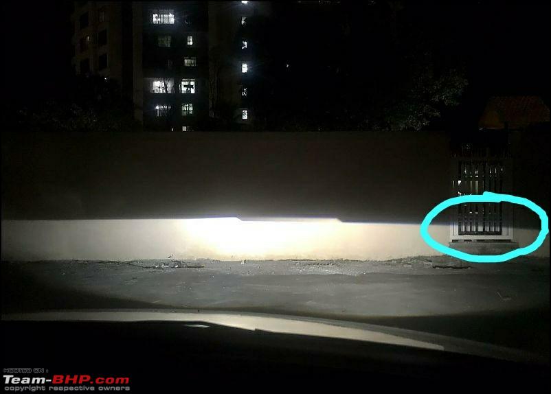

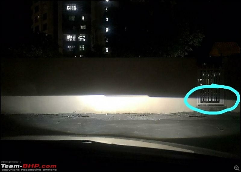

Originally Posted by Epic View Post
[The before and after results are below. Please note that the first pic is aligned as per the projectors on my Jetta in terms of height and cut off on a different wall as compared to the second pic. The second pic is not yet aligned with the height. I will have to align my current set up on the same wall as the first to make a fair comparison.
The headlight lens will reduce the sharpness and blue colour in cut off for any projector setup. The alignment is fine and you can adjust the height as per your need.
I am not sure if it's only in pics. If its in real also, The Hotspot is fully off in RHS projector. There should be good amount of hotspot around the Z line which is totally missing in RHS projector. I too had the exact same problem in XP Mini Super projector in Baleno. They had tried bulb seating, bulb change, projector shield mod (jugaad?) and finally did some shield mod in one projector and changed another projector.
Missing Hotspot in RHS
Auto Lighting thread : Post all queries about automobile lighting here-img_20170920_104025.jpg
If you talk about perfection.. There is lot of bowing at edge in RHS projector. The cut off is going down to ground. This won't affect you much practically on road. So you can live with it, but not the hot spot issue. If the hot spot is not around the Z line, it should be much higher (This is why I wanted to see high beam pattern also). When the hot spot is much higher than Z line.. It will illuminate trees and not the road .
The bowing at edges :
Auto Lighting thread : Post all queries about automobile lighting here-img_20170920_104016.jpg
