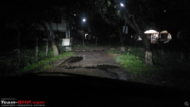

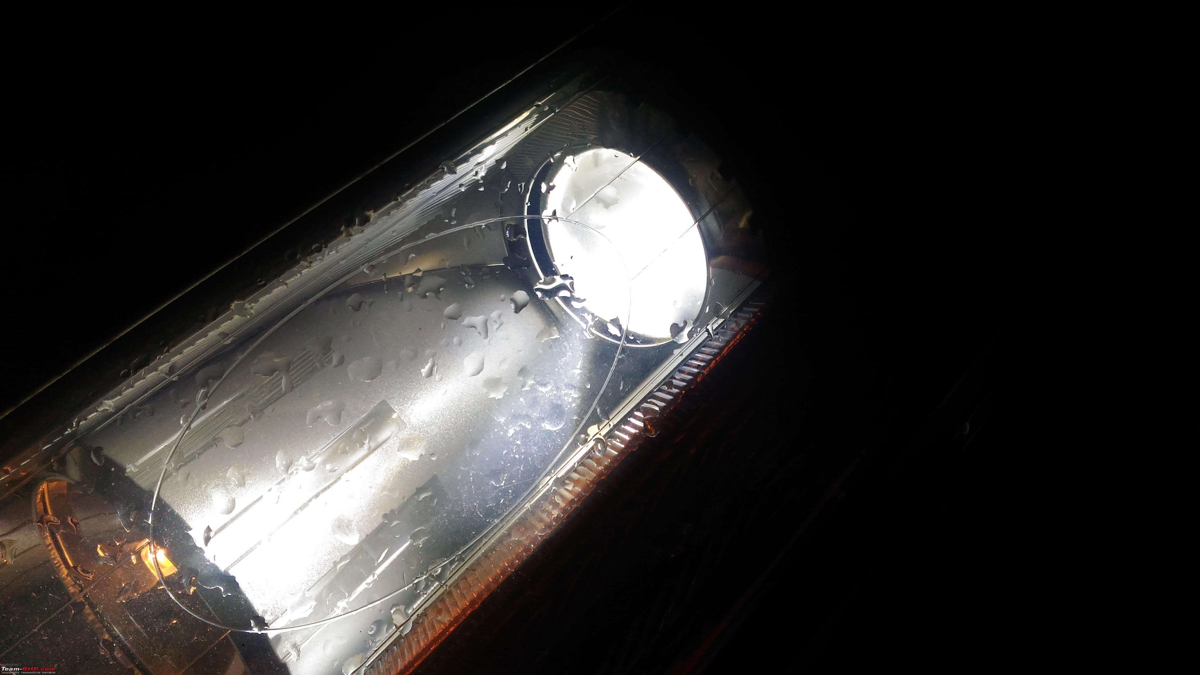

After a good 4.5 years of driving my Aria with poor stock low beams - mainly due to the projector lens, decided to go for LEDs. Found a good pair on Amazon.com while I was traveling and installed them sometime last week and I will let the pictures do the talking.
I was not able to caption the pics - Mods may please help me on this.
From top to bottom - With no lights, with LED low beam from drivers seat, LED low beam from the outside (approximately 50 feet away), color temperature and LED low beam as viewed from near the LH headlamp) and beam pattern.
In the excitement of fitting the LEDs, I forgot to take a 'before' picture for reference

Which LED's are these? Can you share the link from amazon.com?
https://www.amazon.com/dp/B01I3GKGN8..._8pmhBJeornshf
This link is for the H7 type. Cost $56 approx. 40W and 4800 lumens per bulb is the rating.

Thanks. Is it a direct fit for H7 type socket. Do share more details on fitment process.
Yes, it is a direct fit in the H7 socket. No wiring harness / splicing needed. The only alteration you would need is that you need to drill a hole in the rubber caps (plastic in some cars) that is used to seal the headlamps from dust and moisture. The reason for that is there are 4 flat strips that extend from the rear of the bulb. These strips are for heat dissipation and need to be outside headlamp unit for better heat exchange. Better the cooling, greater the life of the LEDs.
I have attached a picture for your reference. There are a few LEDs that have a embedded cooling fan with fins. They are much safer bet than these strips for cooling but it depends on how much space we have behind the headlamp to accommodate the unit. In my case there is not much room so stuck to the strips.
