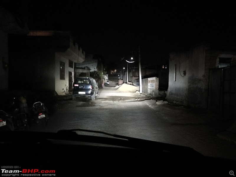

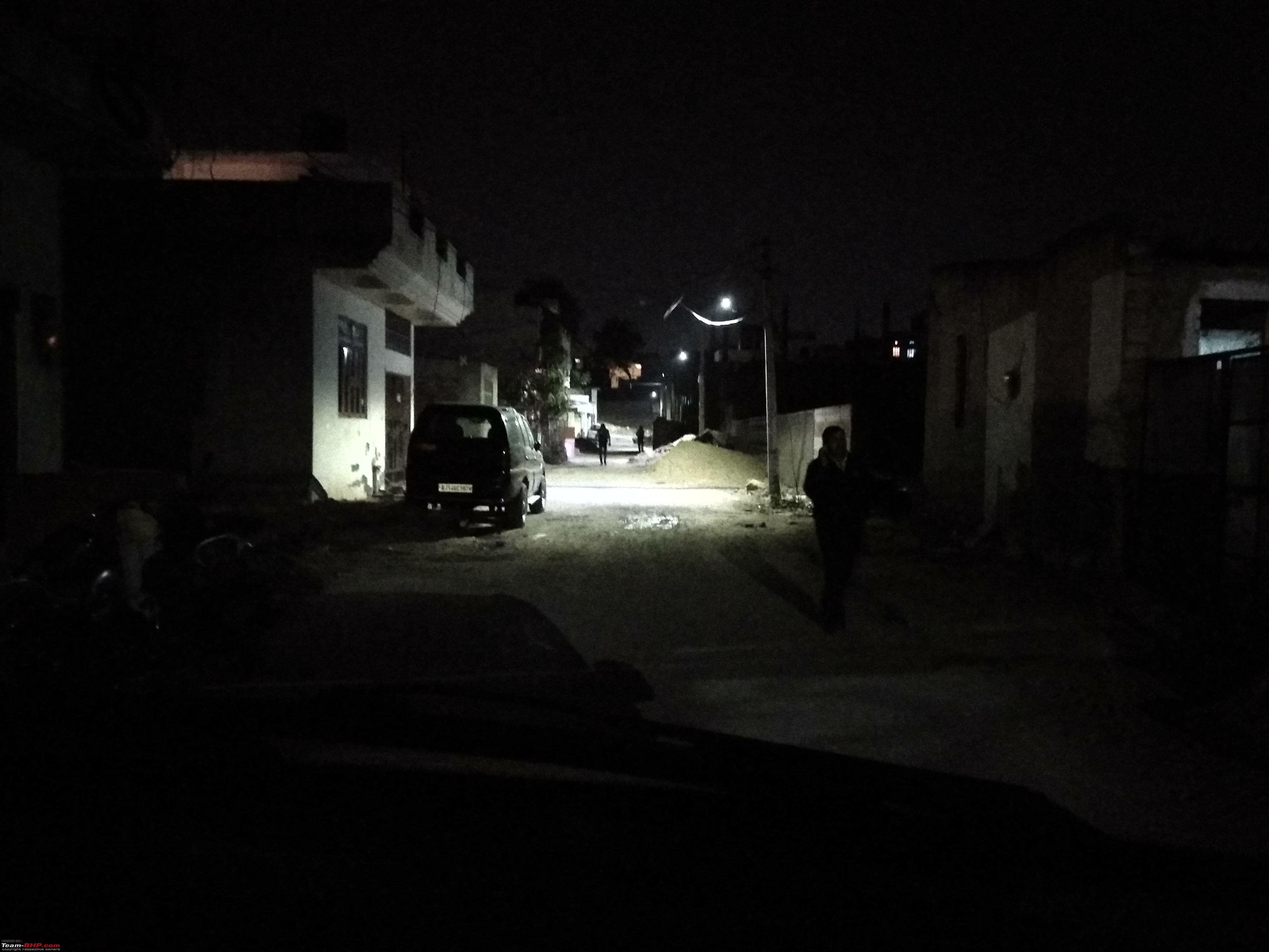

I recently received my first pair of car headlight LED bulbs. The first impression are here:
http://www.team-bhp.com/forum/techni...ml#post4347783
Next morning, I installed both the bulbs and waited anxiously for the darkness to fall, but as the fate would have it I was down with the flu by the evening. I never knew karma would punish me with fever for installing the LED bulbs or was it because I judged them too early without even giving them any chance to prove themselves.
Tonight at around 9PM I felt that I was alright enough to go for a short drive. So asked a friend to come along and begin our search of a dark or dimly lit street and the best we could find for tonight was this and that's how it looked with car headlights completely off.
Auto Lighting thread : Post all queries about automobile lighting here-img_20180203_205209_hdr.jpg
This is low beam, notice the cut off line, although no where near what can be termed as sharp, it still does exist. Also look how with absolute awe that gentleman is staring at the headlights.

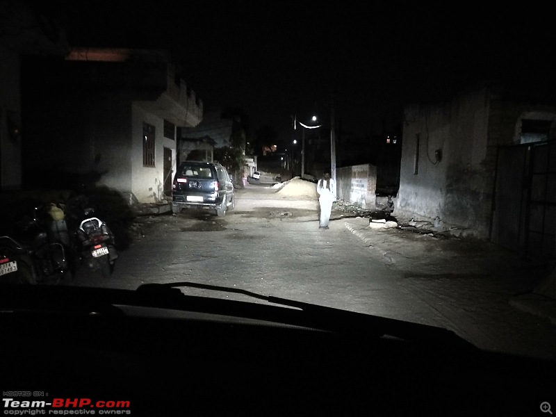

Auto Lighting thread : Post all queries about automobile lighting here-img_20180203_205030_hdr.jpg
This is high beam, and it is as bright in the darkness as a thunder bolt (same color too), the gentleman who was staring at the headlights a moment ago, vaporized into the thin air as he couldn't face the pure awesomeness.
Auto Lighting thread : Post all queries about automobile lighting here-img_20180203_205045_hdr.jpg

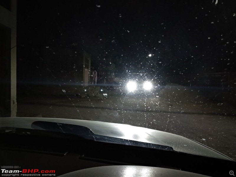

Now it was time to check whether it will blind the oncoming mortals with candle lights with its supreme brightness which can even vaporize a curios human being. The windshield was not the cleanest and the cameraman was not in his fittest, so please don't mind.
This is low beam, and the focus is set right onto the driver side headlight. You might call it a glare but in all honesty it wasn't too bad to be considered as a glare at all. Pictures don't do justice here, or may be I did not take the picture like it should have been captured because to the naked eyes it seemed pretty acceptable.
Auto Lighting thread : Post all queries about automobile lighting here-img_20180203_223401_hht.jpg

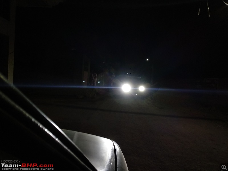

The menacing high beam, this is where all the hell breaks loose, you are staring right into the eyes of the monster and there is nothing else but the darkness surrounding it. There it's just too much brightness, I wish I knew a word that exaggerate brightness it was that bright for a simple car headlight.
Auto Lighting thread : Post all queries about automobile lighting here-img_20180203_223450.jpg
Even when I got out the result was pretty much the same. And I could personally tell you that it is really too bright to look at head on.
Auto Lighting thread : Post all queries about automobile lighting here-img_20180203_223508.jpg
You haven't mentioned the brand name anywhere.
I searched your first post also, but couldn't find the brand name there too.
Originally Posted by wrongturn View Post
On High Beams There is light everywhere, on road, nearby trees, on houses along the road and on their first floor balconies. You feel illuminated
It simply jolts it's victim like a thunder bolt. Everyone responded to the high beam flashes and I mean everyone, in one way or another.
Your own words just speaks for itself how much light scattering there is, and how terrible a glare it is to the oncoming side.
A few pages back on this same thread, I had shared a short review of my disappointing experience with insanely expensive Philips Ultinon H4 LEDs .
Believe me, retro-fitting LEDs in halogen reflectors is more of a hit-or-miss thing.
And there is no escaping from the light-scatter and glare problem, even in the best retro-fitted LEDs in halogen reflectors.
Philips claims to be the least in glare & scatter compared to all those chinese H4 LEDs, but in my experience even Philips had considerable glare, and I can imagine how much glare the other cheaper ones would be creating.
On dark narrow streets inside the city limits, the high-beam may seem to be all-illuminating, with so much of light scatter everywhere including tree-tops.
But take it to the open highway and you will realize how useless that high-beam is.
As there are fewer obstacles on highway for the scattered light to reflect back to us, majority of the unfocused light gets scattered to infinity instead of illuminating anything ahead.
Also whatever remaining focused white light is there on the road, gets submerged by other normal yellow-halogens frequently.
You will wonder where did all that superb brightness go, once you reach the highway.
Atleast that is what I felt from my experience.
