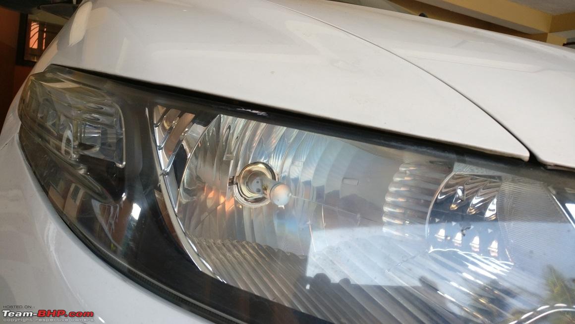

Facing a problem with the headlights in my 7 year old Honda City 2011 (previous generation).
The headlamp reflectors have become somewhat dull and milky in color and not very reflective. Not sure what caused this. I have used only 60/55 bulbs and last year I got a Philips Ultinon LED bulb (which was a huge improvement BTW though quite costly), but this doesn't emit much heat. No 100 or 130W bulbs used and I have always made sure the dust caps were sealed well so not sure what caused the reflector damage.
Pic attached but not sure if it clearly shows the condition of the reflectors.
Anyways what I wanted to know is; what are my options?
1) Is there any way to clean the reflectors to bring back the shine? If so is there anyone in Trivandrum/Kochi who can get this done?
2) Should I get a new set of headlamps? Any idea of the cost involved (I'm thinking around 10K?)
3) I'm tempted to install 100/90s with relays now (since the reflectors are gone anyways). Is this a good option? With the current reflectors I don't see any major light scattering. Just that it's a bit weak.
4) Are Bi Xenon projector fog lamps a good idea? I'm wary of messing with the headlamp assembly (so not considering projector retrofit inside headlamps). If additional foglamps will help in highway driving I can look at that option. Currently I do a lot of Kochi-Trivandrum drives and I really need good strong headlights. Please keep in mind that this is a SMT model so I guess the bumper needs to be cut to make provision for fog lamps.
Your ideas please
Auto Lighting thread : Post all queries about automobile lighting here-headlamp.jpg
Your ideas please
LED do produce a lot of heat but less when compared to halogen/HID lights. Check whether the heat sink is working properly. If not, that's causing the issue. That's the main reason why am still hesitant in upgrading to LEDs.
Let me try and help you answer some of your questions:
1) Try the old method of cleaning using a toothbrush and paste. You can find a lot of DIYs on Youtube. 3M does headlight restorations but can be expensive. Do try approaching some detailing outlets and check with them. In cochin, do check with DBS tires since they do detailing (We are regular there).
2) Too early for that I guess after seeing that picture. New set can cost around 8k-10k.
3) It might even worsen the scattering and produce even more heat. If the output isn't bad, I would suggest to stick the current setup.
4) Messing up with the bumper sounds tricky in your case since you will need to make provision for the fogs. I don't recall the bumper design but you will need a trusted mechanic to get the job done. But a projector fogs should improve things but can blind the oncoming traffic (but that's the case on TVM-Cochin stretch being 2 lane highway).
Thanks for the suggestion, but I believe this kind of cleaning only polishes the lens surface. Since reflectors are inside the assembly and I guess it can be cleaned only after opening the headlamp by heating in an oven (or at least that's what the youtube videos say). Sounds like a messy process but if there's someone who can do this reliably I'm thinking it might help.
It's actually quite bad now. The pic I shared doesnt clearly show the problem with the reflectors. They are kind of milky and not very reflective. Almost as if there's a very thin layer of white powder on the surface. On highways it's quite difficult to see the road. Since it was progressive deterioration I didnt really notice it. But recently when I drove a Celerio with stock headlamps I found it lighting the road much better than mine.
I'm thinking bi-xenon projectors so that I can put them on low beams when there's oncoming traffic.
ar@v1nd is offline

Originally Posted by ar@v1nd View Post
Hi Guys,
Not very clear from the picture if the dullness is in the reflectors or the lens. Usually, it is the lens cover which degrades first. I've had very good results polishing the lens of my previous car which looked similar and the dullness was the lens cover. I had it done at 3M.
First step for you would be to confirm where the problem is.

I have uploaded one more pic with less glare. The pictures don't really show the dullness clearly but if you see the area highlighted in red, you'll get an idea. Normally you'd expect the reflector to be shiny like a mirror but as you can see it is kind of dull and milky in color. The entire reflector area is like this. And trust me, it's not the lens. Lens is clean and I already got it buffed from a detailing shop earlier.
Auto Lighting thread : Post all queries about automobile lighting here-headlamp2.jpg
The headlight assembly can be removed and cleaned up with soap water and then dried with hot air at a FNG if there are dust accumulations. I don't whether such treatment will be beneficial in your case. You can check with a FNG you trust.
archat68 is offline   (1) Thanks
It looks like permanent discoloration due to the heat from the bulbs, I don't think any type of cleaning would have any effect over it.
Is it having minute cracks or peeled off reflective coating?
Did water entered the assembly any time?
I had the same problem with fog lamp reflectors, getting them changed was the only alternative I had.
francis_vaz is offline   (1) Thanks
Hmm.... No cracks or peeled off coating. And I don't think water could have entered. I have replaced the bulbs myself and always ensured that the dust caps are sealed. Headlamp has no impact damage either so ideally water should not have entered.
Regarding heat from bulbs, no high wattage bulbs were used except Osram NB+ and Philips Xtreme Vision (IIRC). Both were 60/55W. And the Philips LEDs appear to be much cooler than the bulbs (at least on the surface). The heatsinks also are fine and I would expect the LEDs to get damaged/switched off in case of extreme heat before reflectors get damaged. The whole thing beats me.
Thanks. I'll check that out. Any recommendations for a good shop / FNG in Trivandrum who can get this checked for me?
