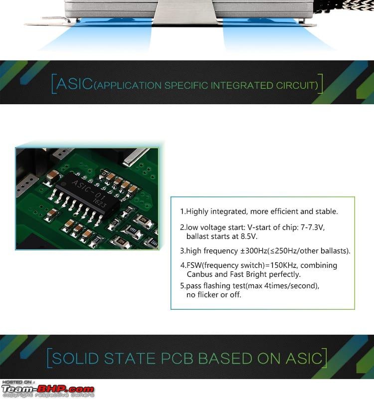

After waiting for FCA for a year to come up with a solution for the weak headlights on the Jeep Compass, I finally got frustrated enough to upgrade to HIDs. During my research for the upgrade I considered all the top brands for HID & LED including Morimoto. I also bought 2 pairs of Philips HIR 9011 halogens as advised by Behemoth in the forum. Thanks for your advice Behemoth, the light output from the 9011 are better than the stock headlamps. Not your fault that I was still not satisfied with the throw and lumen output. I got a couple of scares owing to the low throw distance of the halogen lamps.
I came across a hobbyist by the name of Abhishek (+919818952900). This guy has invested a lot of time to understand the different kits and components used in the making of a HID/LED lamp. He started out to get upgrades for his own cars and then ended up getting lamps made to specification and delivered for friends and then friends of friend’s cars. I was convinced by his in-depth knowledge on the subject and went for an HID imported by him under the brand name UGlare. The said set emits 3200 Lumens at 4500Kelvin, so it is not white but whiter than the stock halogens. The stock headlamps were ~1650 Lumens so increased brightness is immediately visible, and the throw distance is marginally longer, they being limited by the shutter-like mechanism that regulates the low & high beams. I believe if the headlamp housings/projector housings can be tilted a trifle upwards the throw distance for low beam will be satisfactorily increased. Abhishek/UGlare has provided 2year warranty for the HIDs.
Below are the specifications of the HIDs for the benefit of others in the forum if they’d like to upgrade:
  • ASIC, highly integrated, more efficient and stable.
  • Copper + PET material package for input and output wires, high level quality, strong electromagnetic interference shielding function.
  • Precisely constant power output reaches ±0.5W, no matter the voltage from 8V-16V, the output power is always maintained at 35W to protect the car electronic system.
  • Smart Canbus system – approved by 99% vehicle, like BMW series F10/F20, Dodge Ram Truck series, Mercedes Benz Series, Jeep series, etc… No error message & No extra Canbus cable request.
  • 24 months warranty
Canbus Ability Fit 99% Cars
  • Input Voltage 9-16V
  • Maximum starting current 5.5A 13.5V
  • Steady current 13.5V 3.1A 24V 1.7A
  • Output power 35W / 55W±1W
  • Operation frequency 200Hz
  • Operation temperature -40℃~+105℃
  • Rush starting voltage 23000V±3000V
  • Radiated EMI susceptibility S95/54/EC;
I’m happy with the upgrade and would readily recommend the same to fellow jeep owners.
Auto Lighting thread : Post all queries about automobile lighting here-t4_05.jpg

Great to know that you finally upgraded to HID.. I too have been sitting on the fence for a long time. The 9011 bulbs while being a 50% improvement over stock still are lacking the levels put out by HID. HID lamps at 35W put out around 3500 lumens which is much higher than the 2500 of 9011 bulbs. When driven at 42w (some ballasts) or 50W (Morimoto) they can out upto 4200 lumens.
In fact I also have a pair of HID Asic ballasts from Dmex and HB3 4300K 35W HID bulbs sitting with me since the past 6 months but I just did not want to risk the warranty yet. Maybe I will put them in after some time.
In your HID bulbs do you get any shadow from the Bulb rod ? Some users have reported a shadow from the bulb rod with HID. I will also most likely take the HID path soon as the headlights of the Jeep Compass in the Limited version are absolutely pathetic!
This is what I got:
https://m.aliexpress.com/item/327967...st.32796715744

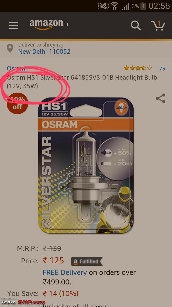

I wanted to upgrade my Honda Activa's headlight bulb to LED as the output from stock halogen is just not good enough. I saw some videos on YouTube and noticed that whoever does this, they splice the battery wires to the LED bulb supply and say that LED bulbs need 12v DC.
But, don't our normal halogens also operate on 12v DC supply that is generated from the scooter's dynamo?
Do we really need to send power to LED bulbs via battery?
Can't I just replace the halogen with LED call it a plug and play upgrade?
This is because unlike 4 wheelers having alternators (which produce alternating current) to charge the battery, 2 wheelers use dynamos which produce direct current.
Plus normal halogens are rated at 12v 35w DC .
Auto Lighting thread : Post all queries about automobile lighting here-screenshots_20181004025709.png
No
Yes
No
Alternator / dynamo both produce only AC current. Rectifier circuit converts AC to DC. In most of the 2 wheelers head lamp circuit is powered by AC (after passing through the regulator) supply only.
Where did you see the word "DC"?
All automotive bulbs are DC 12V and not AC.
Also, LED's are plug and play. You just replace the halogen bulb with LED. Only additional component is the LED driver circuit.
All cars have DC but not all two wheelers. Headlamps and tail lamps of some entry-level scooters and bikes use AC.
If you're sure that the stock bulb is DC, switching to LED is plug and play upgrade. Otherwise, you need to feed DC current to the LED driver through a relay or something.
If your headlight bulb can be powered on without the engine running, then it's DC. If it powers on only with the engine running and light from the bulb fluctuates at idle RPM, then it's AC. If light intensity remains constant irrespective of RPM, it is DC.
