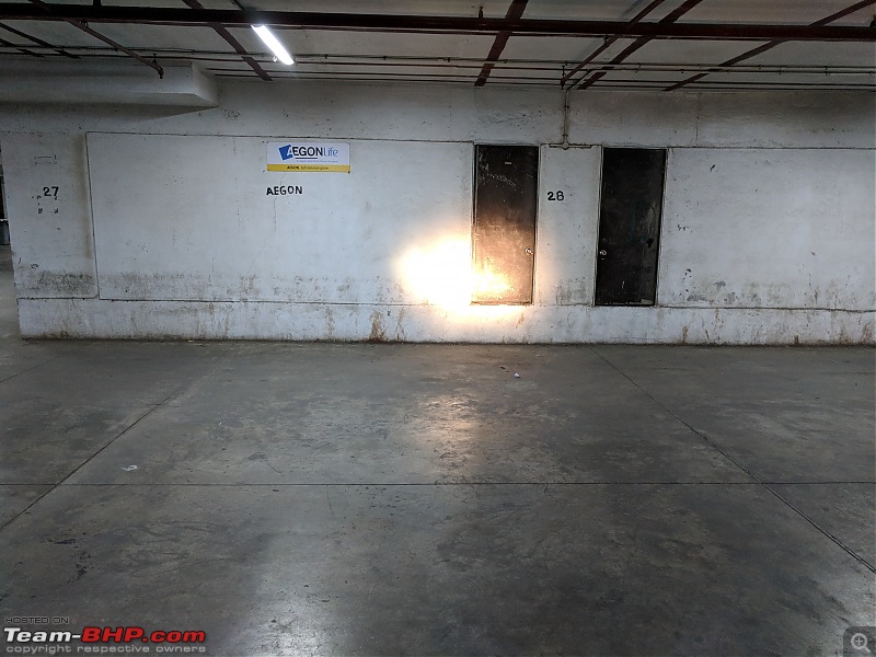

I had ordered similar bulbs too. They didn't go in the high beam holder. The ones with a fan have issues.
These LED's have copper fins for cooling that need to be spread out and can be easily slotted in.
Here is a video showing them in action and some images.
The build quality
Auto Lighting thread : Post all queries about automobile lighting here-img_20181211_153247.jpg
Osram Night Breaker unlimited halogen on right and LED on left
Auto Lighting thread : Post all queries about automobile lighting here-img_20181211_200517.jpg
