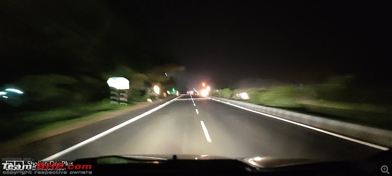

OUT ON THE OPEN HIGHWAY
Auto Lighting thread : Post all queries about automobile lighting here-img_20191206_200730.jpg
Auto Lighting thread : Post all queries about automobile lighting here-img_20191206_200735.jpg
Auto Lighting thread : Post all queries about automobile lighting here-img_20191206_213820.jpg
Auto Lighting thread : Post all queries about automobile lighting here-img_20191206_213823.jpg

For those suffering from poor lighting on the pre-facelift Ecosport; this is a pretty good option for the perfect lighting upgrade without burning a big hole in your pocket and without risking electrical safety by using big relays and higher wattage bulbs.
Cheers & Safe Driving
Surya-TJet is offline   (6) Thanks

Re: Pre-Facelift Ecosport Lighting Upgrade - Lower Cost - Higher Benefit
Originally Posted by Surya-TJet View Post
Hi Guys,
I tried to use Hella Rallye 3003 with 100w Philips Rallye Bulbs.
Attachment 1964598
Hi Surya-TJet,
Can you please tell me how you mounted the Hellas on the Ecosport?
If you mounted them on brackets clamped to the crossmember, can you please share the dimensions of the brackets? I need this so much and would be of great help.
Thanks in advance.
Awesome light output by the fog projectors by the way.
Prakritij is offline
Originally Posted by Prakritij View Post
Hi Surya-TJet,
Thanks in advance.
Hi Prakritij, thanks for your comments.
I fitted the Hella Rallye 3003 on my Ecosport by looking at this thread listed below. Specifically, this post.
https://www.team-bhp.com/forum/offic...ml#post4017828 (Ford EcoSport : Official Review)
I did the measurement long back; don't exactly remember it. But the clamps have to made atleast 2" wide and has to be atleast 5mm thick for arresting the vibrations. Or else; it will keep on vibrating / oscillating too much; thereby damaging the mounts / clamps.
Why do you want to go the Hella Rallye route? Any specific reason? Why not look at the bi-xenon fog projector instead? Much more discrete, equivalent performance and lesser price compared to Hella.
