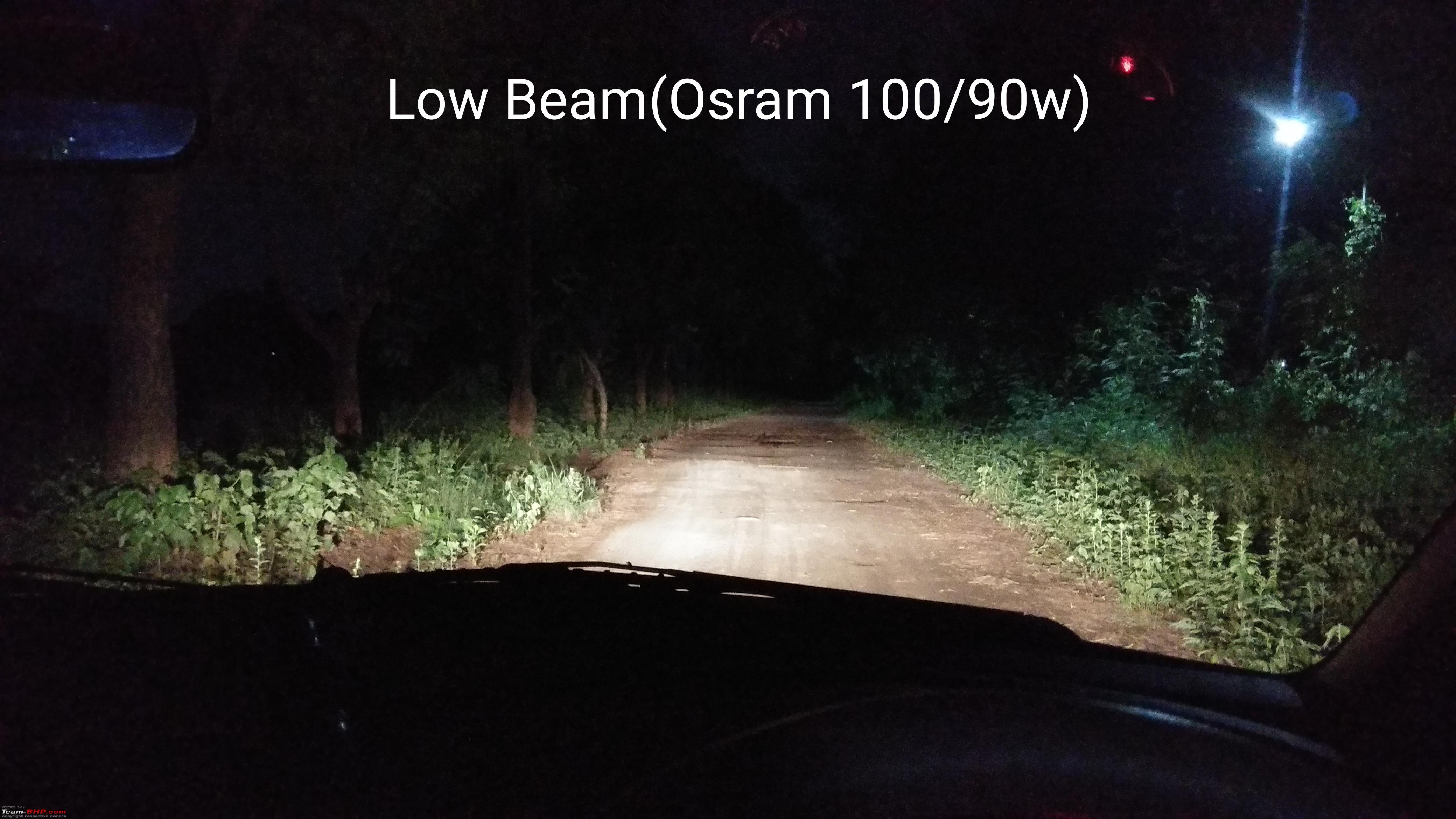

Installed Uno Minda headlight relay kit with 100/90w Osram rallye H4 bulbs in my Honda Amaze. Visibility at night has improved a lot, far far better than the earlier ones. The car was earlier running with 60/55w bulbs, the worst bulbs I have ever seen, can't even see a pothole 10 meters away with those bulbs.
The cost of the relay kit is Rs.600 and cost the of a pair of Osram rallye H4 bulbs is Rs. 350. Attaching pictures of the upgraded bulbs.
Auto Lighting thread : Post all queries about automobile lighting here-img_20201012_211711.jpg
Auto Lighting thread : Post all queries about automobile lighting here-img_20201012_211631.jpg
Thanks for sharing, i am planning to install in my swift the 130/100w Philips or Osram. I had installed leds from AliExpress that were recommended here but find the white light insufficient and also very poor throw. Any reason you didn't opt for the 130/100?
As per my knowledge the normal reflectors headlamps which uses halogen will not work effectively with led. They are designed only for halogens bulbs, which spread light in 360°. On the other hand the leds has two strips, each on opposite sides. So the light spread on the reflectors will be less than 360°. This is why you are facing poor light throw. The led must be used only in the headlamps which are specially designed for the the leds.
I had earlier planned to install 130/100w, but my mechanic and the spare parts shop owner told me not to do so. They said 130/100w can damage the reflectors due to excessive heat produced and will also drain the battery fast. So i went ahead with much safer option i.e. 100/90w.
pawank is offline
