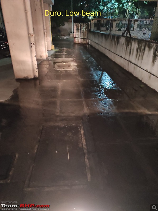

The problem with DURO looks like a bad reflector design. Have you checked with other DURO's? Do they have a better/different throw of light?
TVS headlamps have one of the best reflector design in Indian market, resulting in a good spread and focus. I have observed this among all their scooters and bikes.
I couldn't verify with another Duro; these are hardly seen on the roads. Visually I don't see any deformation on the reflector. So indeed it may be a design flaw.
I can understand if Duro doesn't have a spread like Jupiter. But mine is focussing the light at one spot like a lens under the sun!
That duro does seem to be a bad reflector. Is that how its been ever since you got it? If not, then you should check with another duro, maybe you need a new reflector itself.
And that Jupiter's low beam cut off is much too high. You might want to get it lowered to about window line on the car in front.
I did not notice for a long time after buying because it was hardly driven at night and there was always enough street light on the roads. I started noticing this since last 2 - 3 years when I had to drive it in the dark, returning from dark remote industrial areas. Anyway, I have ordered a new headlamp assembly; let us see if it spreads the light properly.
I too noticed that the Jupiter's low beam cut off is high. But can it be lowered? I don't see any headlamp adjustment in the scooters.

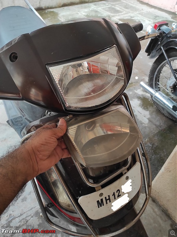

Old 20th July 2021, 22:50   #12102
Posts: 1,155
Thanked: 1,950 Times
Originally Posted by Rahul Bhalgat View Post
The headlight of my Mahindra Duro always felt insufficient and not spread properly. When I ride in the dark, I see the light focussed more on one spot and not spread enough over an area.
I had posted the pictures of low beam and high beam of my Mahindra Duro in the above post. It was like the concentrated spot of light seen under the lens held in the sunlight.
Changed the headlight today and it brought smiles to my face. You can compare the old headlight with the new one in the picture below. All these days I thought that the old headlight wasn't that bad; we come to know only when we buy a new one and compare.
To understand how happy I am, you need to see the pictures from the post quoted above. It was terrible.
I changed the headlight myself at home with my son to assist. I have also adjusted the headlight aim.
Auto Lighting thread : Post all queries about automobile lighting here-img20210720wa0009.jpg
Auto Lighting thread : Post all queries about automobile lighting here-img20210720wa0007.jpg
Auto Lighting thread : Post all queries about automobile lighting here-img20210720wa0008.jpg
Auto Lighting thread : Post all queries about automobile lighting here-img20210720wa0010.jpg
Rahul Bhalgat is offline
