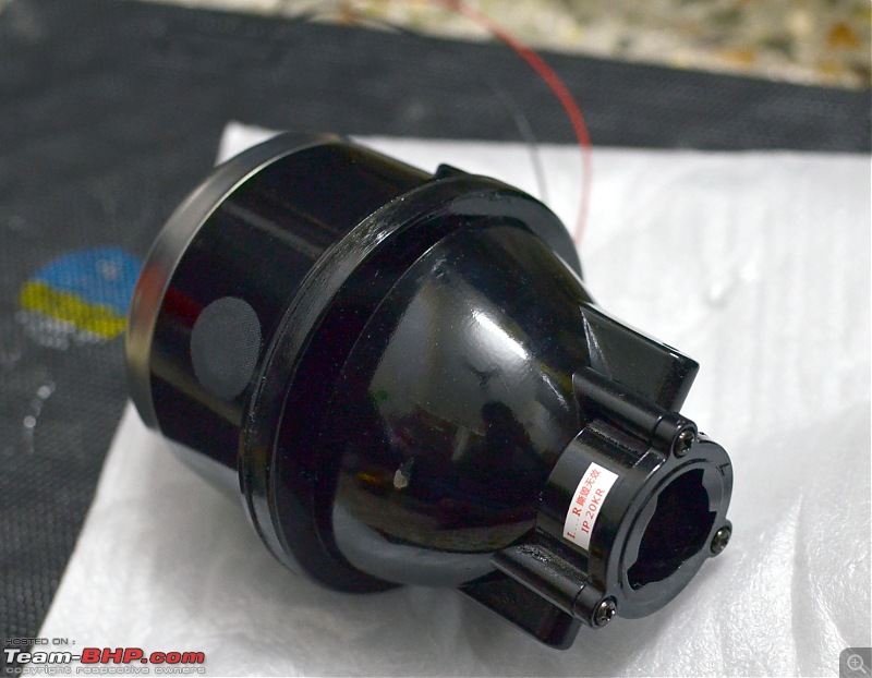

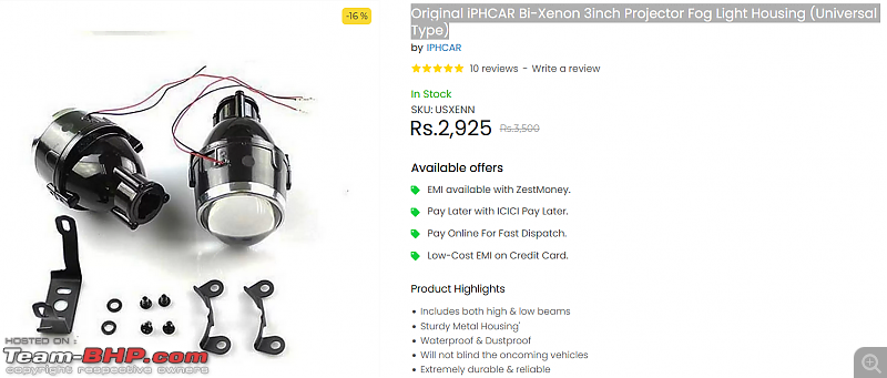

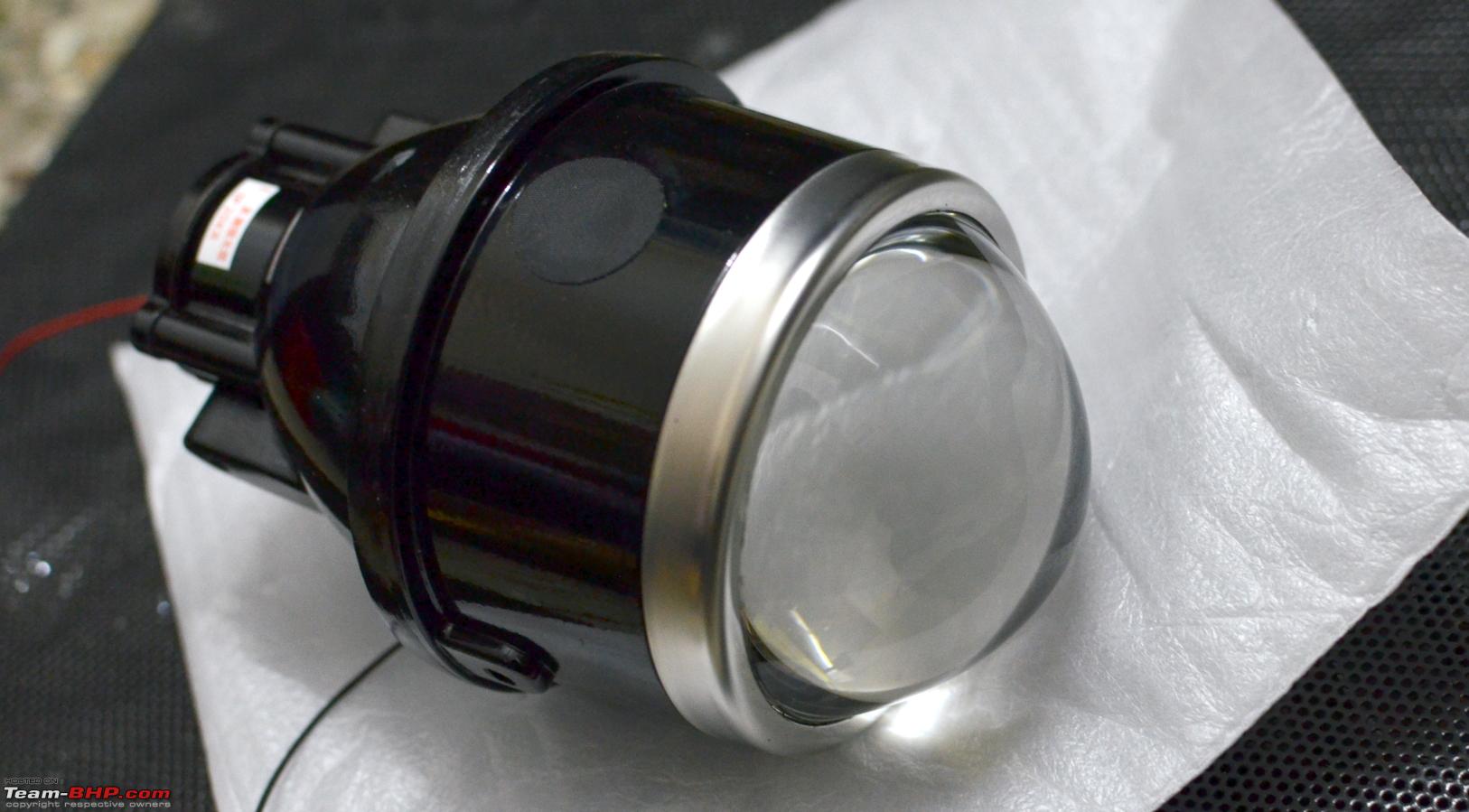

Guys, please help I have one doubt.
I just got the iPhcar projector fog lamp for my car (Baleno Alpha model comes with fog lamps). It looks like it is just a projector without a bulb. Also the wiring diagram in the box shows some ballast and other connections.
Do I need to purchase bulb, ballast and other connectors separately? The contents of the box are: Projector as shown below, some clamps and bolts. The projector comes with a couple of wires.
p.s I have zero knowledge on this subject.
4[/ATTACH]
This is the one I got:
https://carhatke.com/iphcar-bi-xenon...-for-fog-light
Read up, and I think you can use h8/11 halogens with it. The wiring shown is for HID, you have to draw the connection for electricity as well as a connection from the switch for high low beam where it connects with the main headlight. This is not a DIY for you, but any mechanic can do this job for a pittance. Your extra cost will be for a pair of bulbs and the labour charges.
mayankk is offline   (1) Thanks
