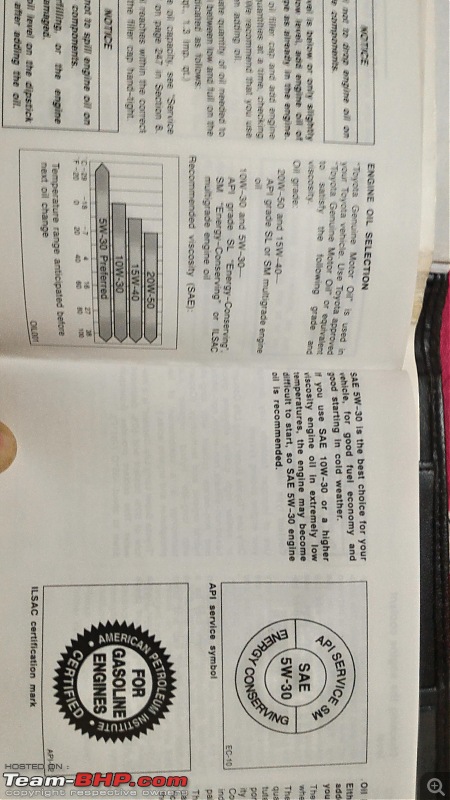

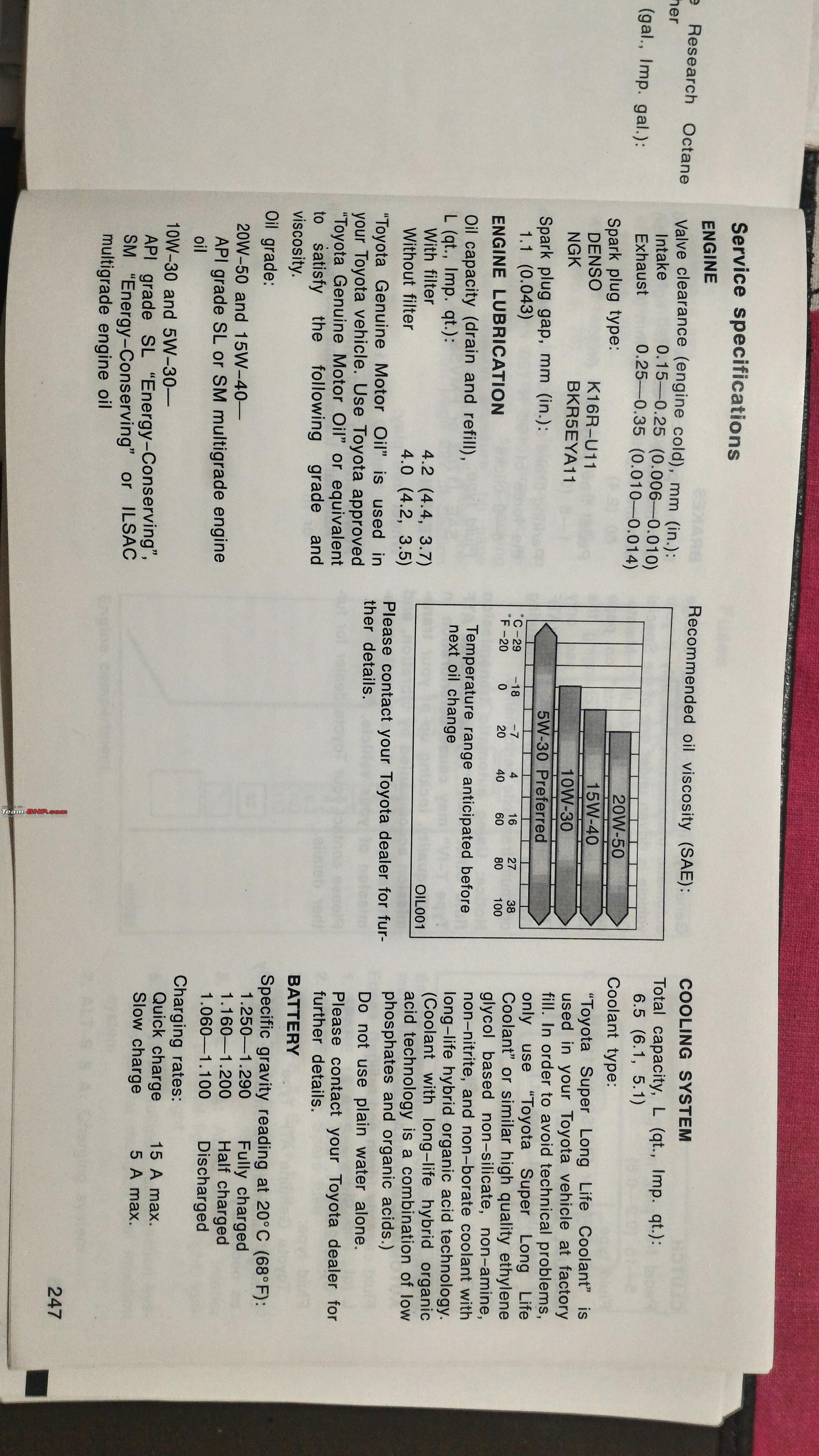

Old 25th January 2016, 19:22   #4350
KK_HakunaMatata's Avatar
Join Date: Jan 2016
Posts: 715
Thanked: 1,009 Times
Re: ARTICLE: Synthetic oil vs Mineral oil
Depending on ambient temps, the oil grades recommended for this engine are:
a) 20W-50
b) 15W-40
c) 10W-30
d) 5W-30
That last 2 are fuel saving oils.
So, any grade of synthetic starting at 5W (cold viscosity) and up to SAE 50 @ operating temp is ok for this engine. I do not recommend using SAE 50 as it is too viscous for normal driving. IMO it's best used in cars that experience sustained high speed running (which is where synthetic comes in) or in engines past their prime.
I hesitate to use M1 0W-40, even though there may be hardly an difference between a 0W and 5W. As I have mentioned so many times before I don't recommend experiments with a critical fluid like engine oil. So it's always been 5W-40 synthetic in my car, and now with a possibility of trying M1 ESP during the next service at the end of 2016.
Attaching the screenshots from the owners manual for the benefit of all. Till last year the previous owner was using 5w30 mineral oil and recently I got the 5w30 synthetic oil filled during the annual service, since I didn't wanted to change the grade preferred by the manufacturer.
ARTICLE: Synthetic oil vs Mineral oil-p_20160125_183714_hdr.jpg
ARTICLE: Synthetic oil vs Mineral oil-p_20160125_184034_hdr.jpg
