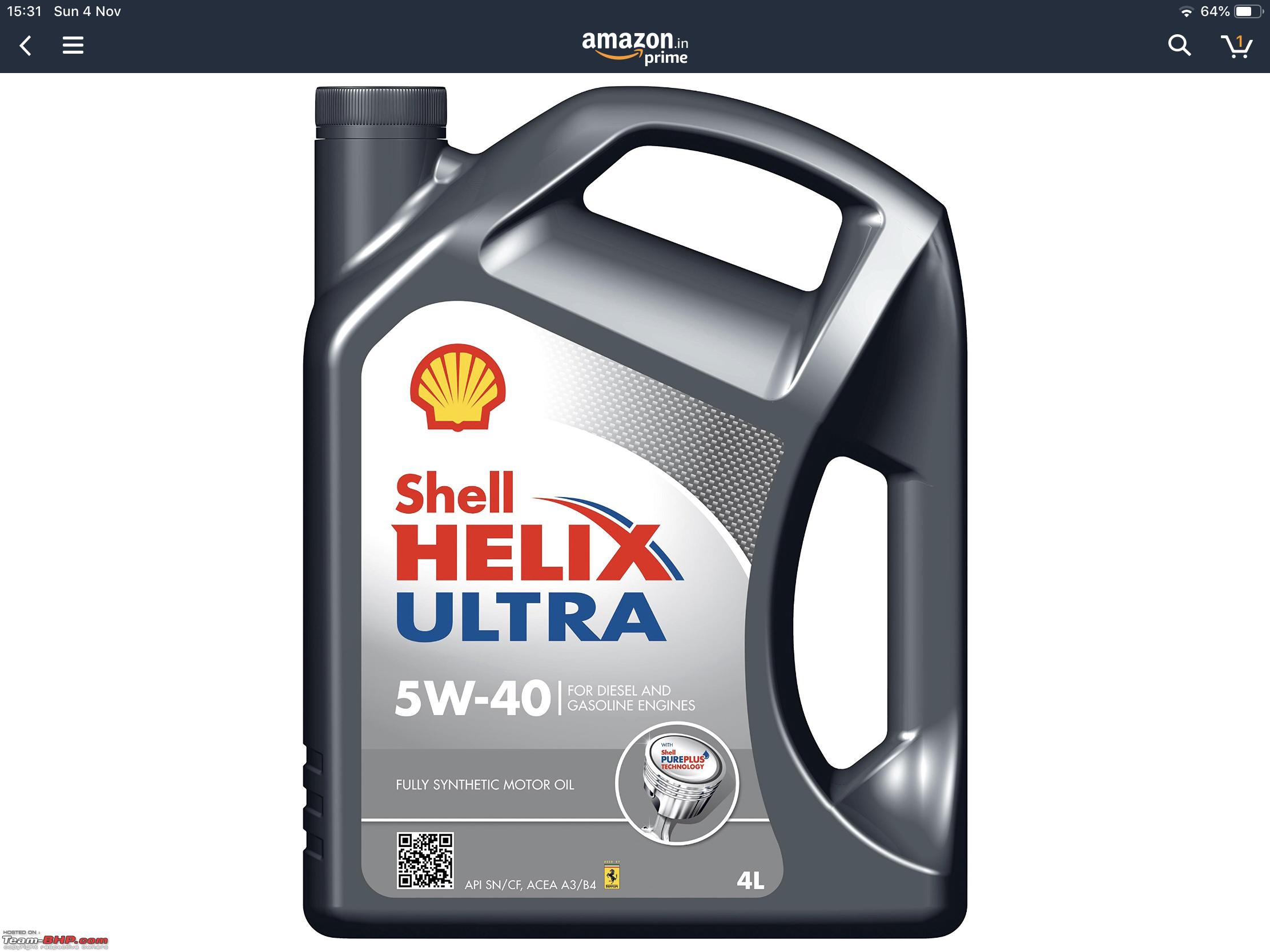

Tell you the truth. I love Gypsys. And this one in Dark green and khaki is a long standing dream. Hence this urge to restore. Even at a cost.
And I have bought quite a few of the requisite oils and flushes and metal gel revitalising treatments for the engine and gearbox etc already.
Yes, if I need to change those old oil seals and things, I shall definitely be better off having done so, and perhaps this will enable me to enjoy the old Gypsy more.

You're just fine with the engine oil (as you already bought it) and the spirax gear oil (which Maruti also recommends as its oem). You'd have done well to have bought coolant and all other lubes required as well. I'd suggest that you pass on the various Liqui Moly treatments and additives though.
