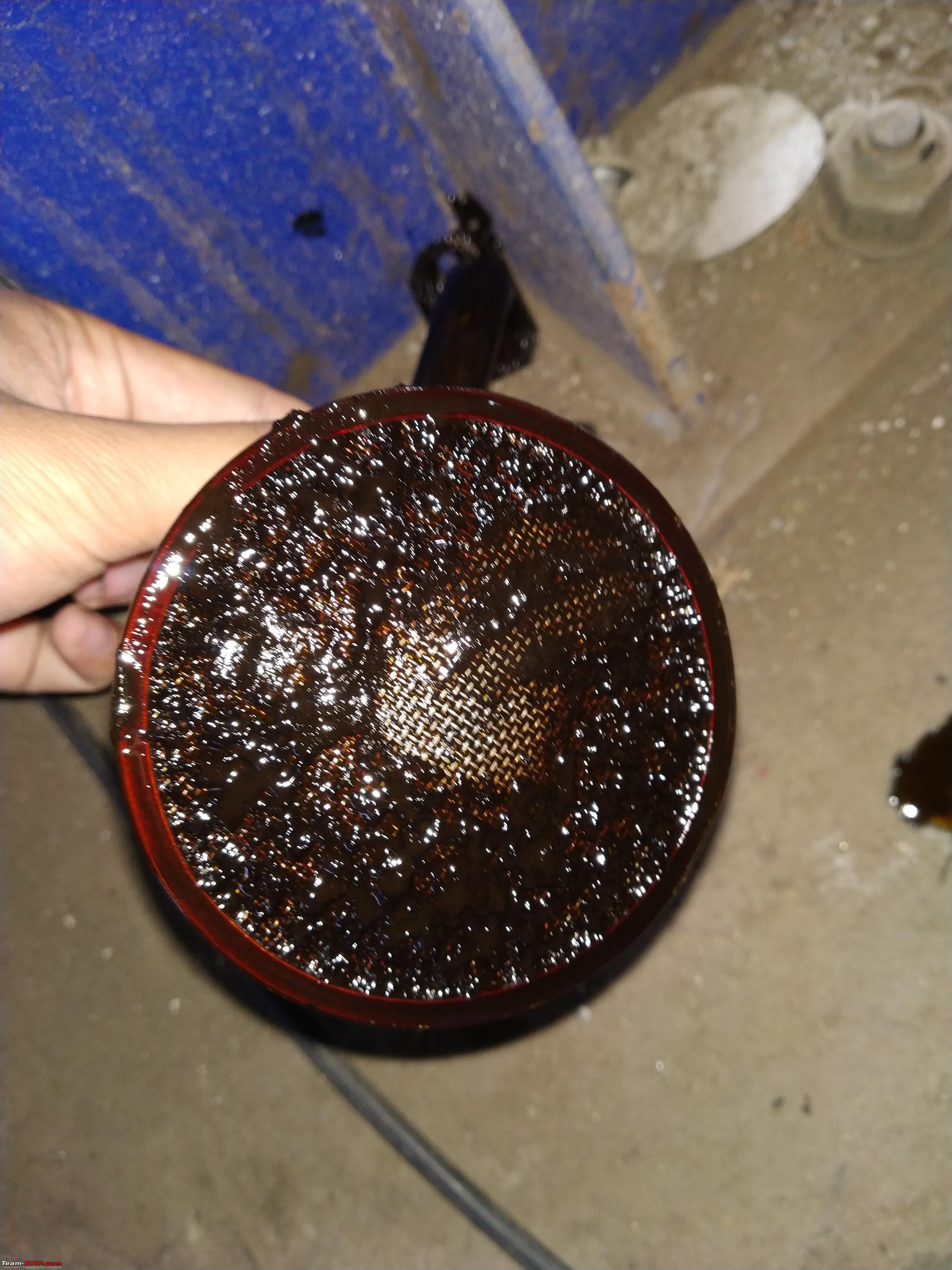

Guys,
A close friend recently picked up a Swift ZXi, with the G13B Petrol engine. The car has done approximately 1.4Lac kms. The car drives beautifully, hence he didn't think twice before getting her home. However, he now faces two issues, and I am posting his questions in BOLD:
1. Sludge: He had to change the tappet cover gasket, and that's when he saw loads of sludge inside.
Action taken: Based on my recommendation, he cleaned the sludge whatever was physically accessible on the head, and the sump and strainer was also cleaned. The logic behind this action was to ensure that the engine doesn't get starved of oil due to chocked strainer.
2. Dipstick popping up: The dipstick keeps popping up after few days, also there is warm air coming from the dipstick always.
Action Taken: This issue can often happen if the PCV valve is chocked, and the pressure gets relieved from the dipstick. I told him to clean the PCV and check. That stopped the hot air coming out issue, but unfortunately the plastic bodied PCV broke. He has installed Zen MPFI's PCV valve for the time being and the issue is back. We are waiting for the Swift's recommended PCV to arrive.
Anything else to check??
Regarding Sludge:
1. Will it be safe to use Synthetic oil on this car?? We aren't much concerned about the oil seal leaks which happens in old cars, can be fixed easily, but will it affect the compression in any way? Synthetic oil is being given a thought as it has detergents which help cleaning the sludge.
2. Mechanic advised against using any flush, as it may cause new noises to surface. Is this claim authentic??
Some more info about the car:
1. Engine has good pep and acceleration.
2. No Blue smoke or soot in tailpipe.
3. No oil consumption
Some pics of the engine taken during Tappet cover gasket change and the sump cleaning:

I would say at least ensure that the spark plugs are removed and cleaned, change all the filters. Then maybe use semi synthetic oil from someone like Shell that has a ton of additives.
As for flush the new problem is generally leaky old seals that were plugged by the flush and now start to leak in earnest.
I am a bit confused about how a BHPian's former car could have so much sludge, unless MSIL's service centres used less than optimal engine oils e.g. Servo by IOC. I had virtually the same engine in my 2000 MPFI Esteem (G13BB IIRC) and like most Jap petrol engines it's a beauty. Just feed her good quality oil and see the difference.
So, should you use synthetic - I'd say no in a car with 1.4 lakh kms on the clock. Use a nice mineral oil like Shell HX 5 or a semi synthetic HX7 even Castrol's Magnatec (both 10W-40)
I would not recommend using an xW-30 oil with this engine, only xW-40 or even xW-50. I can't remember the default oil viscosity for my MPFI Esteem (an old memory now) but I think it was 20W-50 as was the case for my 2002 Honda City 1.5 EXI Type II. Please check the manual to be sure. At one point we had 2 Esteems in the family..the first a maroon 1995 carburettor model and the 2000 MPFI.
He's right. Using a flush in an engine is like washing your hands with Nirma washing powder. The same job done by one of the engine oils mentioned above will be gentle and gradual over a period of time, like using Dove soap. Use a good mineral oil, run for about 500-1000 kms, drain and refill each time changing the filter which is sure to trap any muck in the oil. Repeat as required. Shift to semi synthetic thereafter. A Maruti is not expensive to run and maintain. This and the superb after sales network remain key positive points of the ownership experience.
