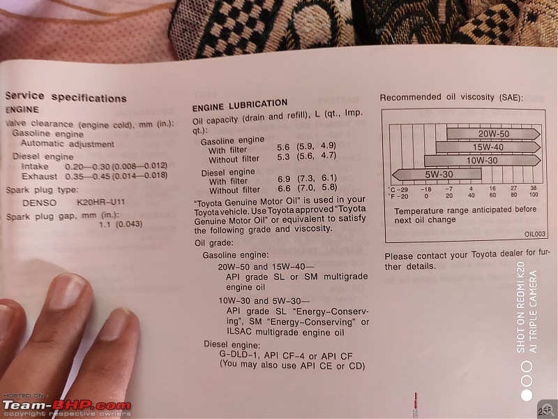

Need your help guys.
I have a Toyota Innova V 2010 diesel model. It has completed 2,40,000 KM's and 10.5 Yrs.
I have attached a picture from the manual which shows the oils that we can use. For our temperature range( We live in Mumbai) 20w-50 oil can be used.
I have read on the forum and on google as well but could not find any answer for old Innova. I am confused which oil should be used as some say 20w-50 will be too viscous.
But some say for older vehicles its best. Even castrol website says for vehicles with more than 75,000 miles, 20w-50 is recommended.
Kindly provide your suggestion as to which one should be used.

Re: ARTICLE: Synthetic oil vs Mineral oil
If you go to Toyota service centres they’ll fill 15w40 mineral or 5w30 synthetic and both will do just fine for your car if the oil is changed as per service intervals.
If you’re doing your own oil changes just get a 15w40 mineral like Shell Rimula R4 or similar.
Thanks! I wanted to know especially since the car has done 2,40,000 km now and is running about 100 -120 km daily, will 20w-50 have any significant advantage?
We usually change oil at every 10,000 or 11,000 km. Lately the engine has been making a lot of noise since last 1 year. We will not be going to service center as they are charging too much, we will get the servicing done at local garage.
He usually used Castrol brand. Regarding other brands , I will have to find out.
If you’re filling mineral change out at max 7500 km especially if you are doing this 100-120 on city or suburban roads. As for noise get it investigated as to just what is causing it.
Going thicker will make the car quieter but at the same time it'll make the car slower.
A good engine oil of the same viscosity you're using will reduce the sound( experienced it but I can't explain why).I suggest you to procure high quality oil and give it to the FNG for replacement. Don't exceed Toyota recommended intervals.
Noise could also be due to partially blocked injectors which will also have symptoms such as more vibrations and lower fuel efficiency. If this is so, check out the fuel additives thread, add your choice additive into the tank before a long high speed drive(Liqui Moly Diesel Purge is supposed to be good). Ensure the car gets only clean and pure diesel.
Your Innova has barely run-in
