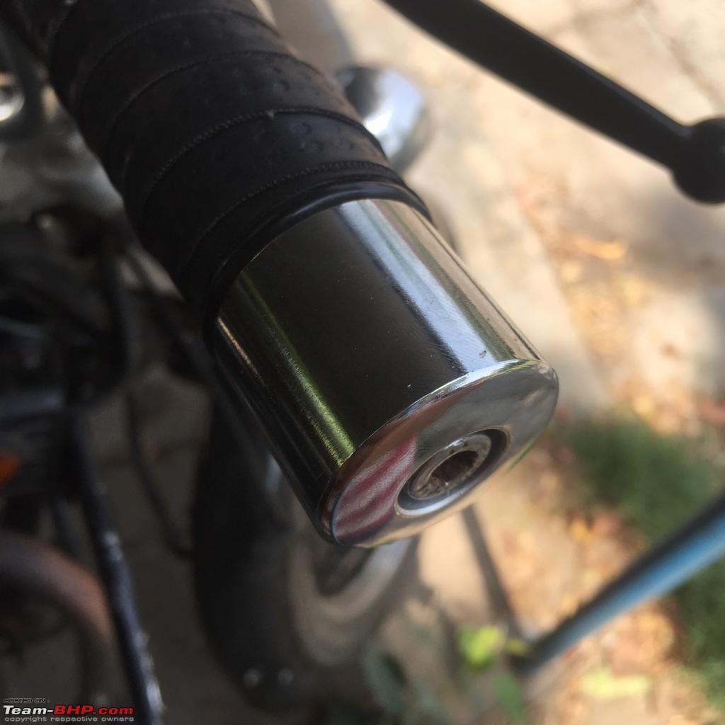

5. Replaced the bar end weights
Take 3 - 2009 Royal Enfield Thunderbird (Ownership Experience)-whatsapp-image-20200502-13.58.41-1.jpeg
Ordered these while they were in stock just to increase the order value and make the shipping free.
