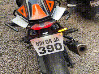

7. Tail Tidy - Link
Tail tidy is another mod that greatly enhances the look. However this particular one does leave some wires exposed. I've seen other tail tidys which are cleaner and also tucked in further.
P.S. I know about the missing 0, please don't bash me about it.

8. Hazard Module by Race Dynamics - Link
This is a coupler to coupler accessory and involves no wire cutting. The hazard mechanism is controlled by stock indicator switches. Must have accessory during rains/fog and especially if you do highways a lot.
