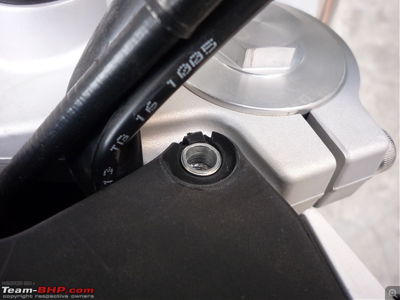

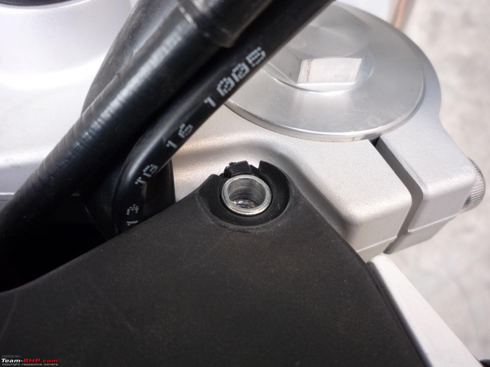

You need to get two of these allen key bolts out first.
Here's what it looks like once you get the bolts out.

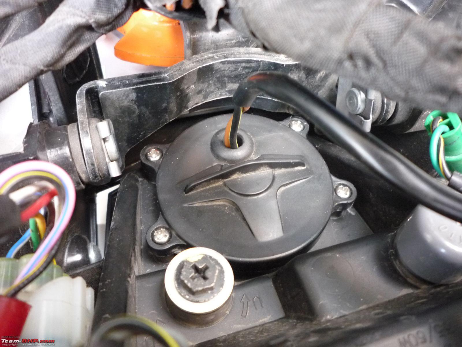

Area circled in blue is what we need to open and requires a star screw driver.
I did manage to open this with the supplied screw driver from the tool kit. It is better to use a smaller star screw driver with a shorter length and something that will fit in that small area.
After you get the screws out, don't yank hard on the wires. You have to put your hand between the gap of the bulb holder cover and gently pull out the bulb holder that is secured on the reflector.
