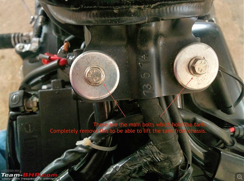

Default The Eklipes Cobra Charger Fitment - DIY
When I returned from the recent USA trip (business), I bought along this hefty thing with me - http://www.eklipes.com/All-Products/EK1-110
Thanks to the recommendations from Mahesh Kora and pointer from few others to carry this DIY. A colleague and ex-Bhpian (not active) helped do this too.
Here are the stepwise pics to illustrate what was done -
The Unit -
My foray into the biking world - Royal Enfield Thunderbird 500. EDIT: Charger DIY too-0.-eklipes-package.jpg
Bought this for 29$. It comes with the unit, fitting/ insert mount rings, Actual charger unit and cable to draw power from battery along with jump starting unit of BMW type.
To complete the fitment, you have to run the cable from battery, leaving the connections closer to rider's seat, away from battery and then the charged on the handle. The way I ran the cable was from battery compartment, below seat and then beneath the tank. The jump start outlet and cable connectors are kept on the right side of the seat in such a way that they can be left unconnected for when not in use.
Here are the few important pics to help you understand how tank is unmounted -
My foray into the biking world - Royal Enfield Thunderbird 500. EDIT: Charger DIY too-1.-removetankstep1tanknuts.jpg
My foray into the biking world - Royal Enfield Thunderbird 500. EDIT: Charger DIY too-2.-removetankstep2.jpg
Connect to the battery terminal.
My foray into the biking world - Royal Enfield Thunderbird 500. EDIT: Charger DIY too-3.-batteryconnection.jpg
Tie the running cable to chassis/ other cables as needed. Ensure you dont mess up with existing cables/ joints and couplers!
My foray into the biking world - Royal Enfield Thunderbird 500. EDIT: Charger DIY too-5.-tietochasis.jpg
My foray into the biking world - Royal Enfield Thunderbird 500. EDIT: Charger DIY too-4.-cablebelowtanktiedonchasis.jpg
The actual charging unit and cables that run along with others on handlebar -
My foray into the biking world - Royal Enfield Thunderbird 500. EDIT: Charger DIY too-6.-theunit.jpg
My foray into the biking world - Royal Enfield Thunderbird 500. EDIT: Charger DIY too-7.-unitcabling.jpg
This is the connection point I leave open when not in use. This is to avoid someone setting charger switch to ON when parked! I will connect this only when I need to head on long drive.
My foray into the biking world - Royal Enfield Thunderbird 500. EDIT: Charger DIY too-8.-chargerconnector.jpg
My foray into the biking world - Royal Enfield Thunderbird 500. EDIT: Charger DIY too-9.-connectingjumpcable.jpg
My foray into the biking world - Royal Enfield Thunderbird 500. EDIT: Charger DIY too-10.-connectors.jpg
I will now need a good phone holder to mount on the handlebar and a BMW type jump cable when in distress to start the bike! This is a very simple DIY but took me time to figure out how exactly this should be done!
A very handy tool on long rides and to start the bike with jump cables when in distress!
abirnale is offline   (4) Thanks
