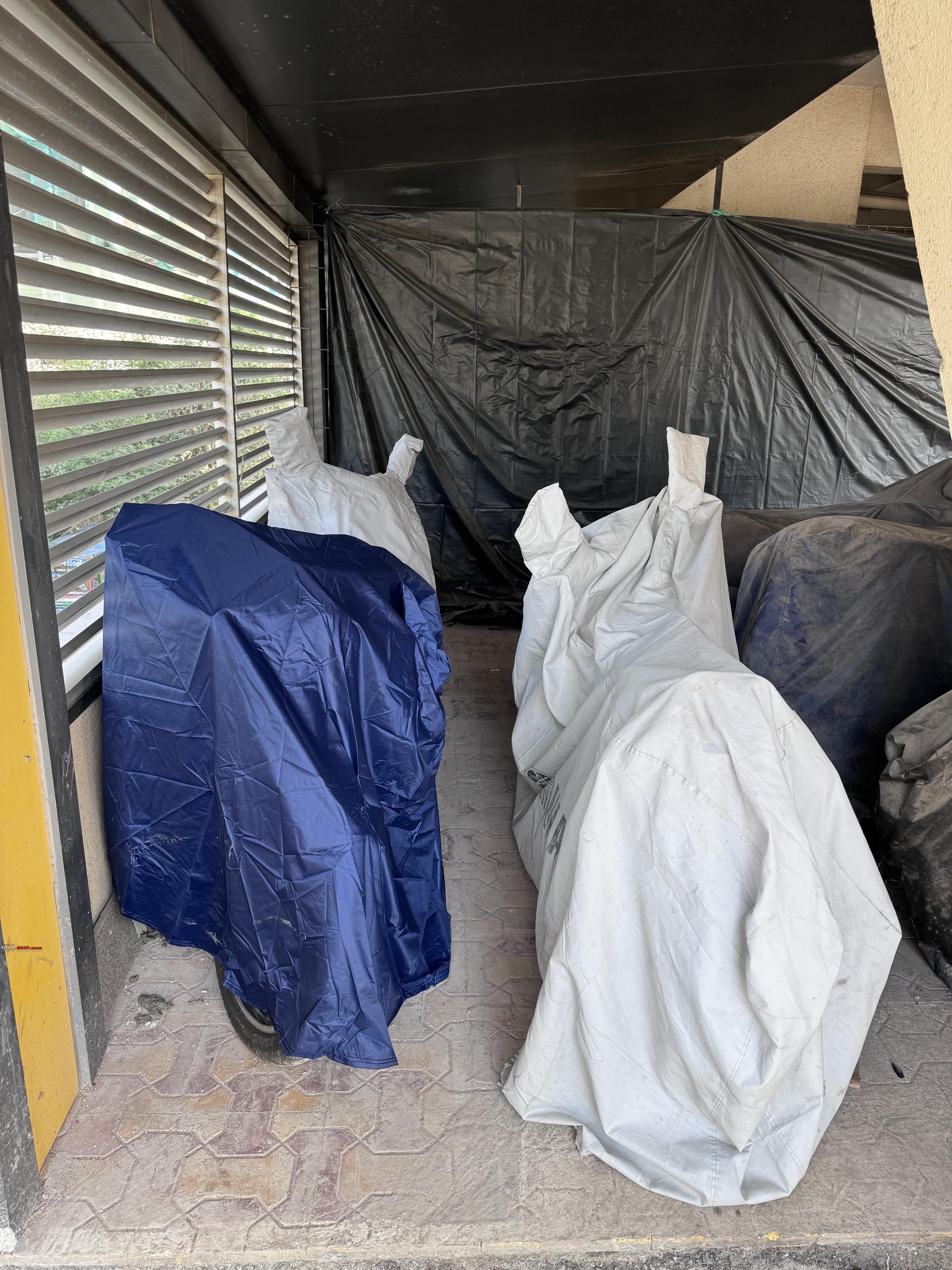

Like all my big bikes the RD 350 was parked under two covers to protect it from the elements.

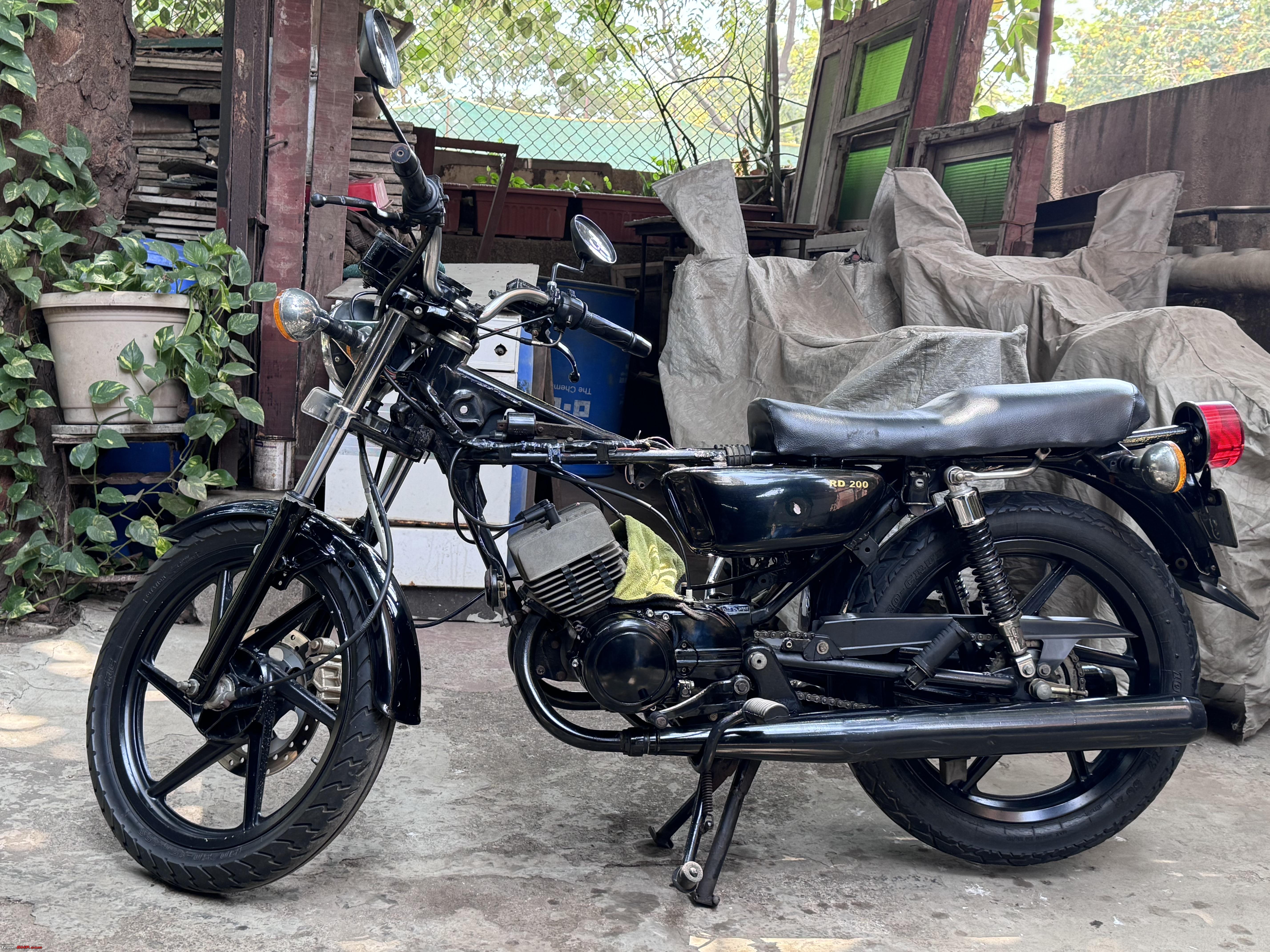

Just needed basic maintenance and it now starts on the first kick. Mechanically it works like a charm. Mr RX is giving it company as had taken to get the rear shock absorbers changed along with the old Michelin Pilot Sport tyres.

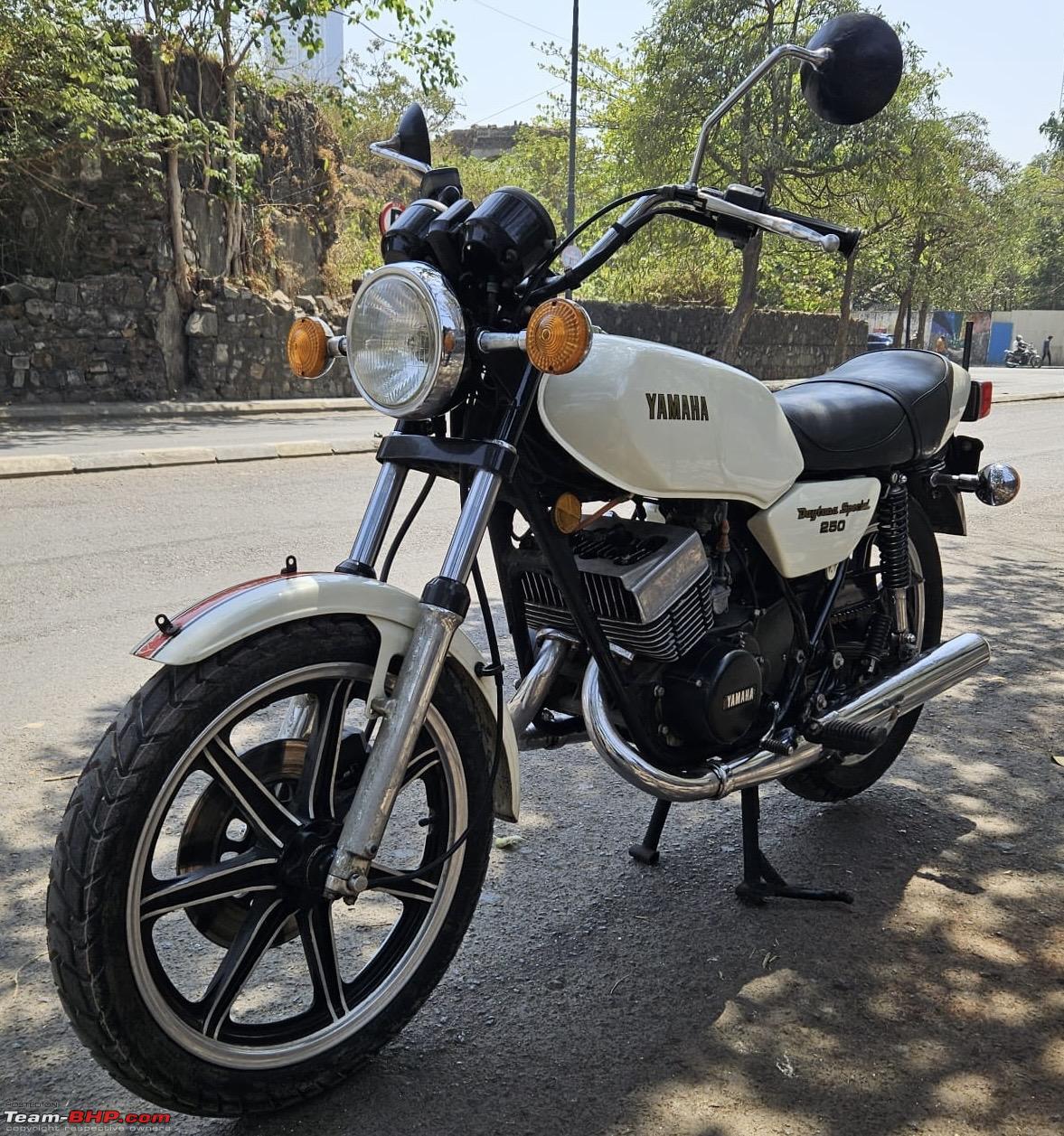

The RD 200 and RD 350 are back home with the 350 just requiring a basic service and new battery and on the RD 200 the left manifold had gone hard and developed cracks which is the reason for the 2T oil leak and replacing that fixed it. Further the front suspension inner tubes were changed as the left oil seal would leak after every replacement along with new air filter set, battery and new tyres. The bike now rides like a dream.
Some pictures…
Shining and running like new again

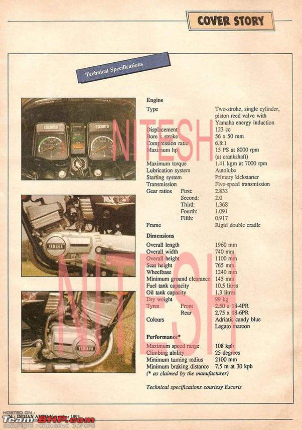

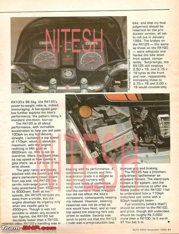

I learned about the Indian RX 125 from Team-bhp Years back. Initially, I also thought it was a myth but it turned out to be real. The details can be found on Team-Bhp, I am attaching some of the Indian Magazine reports of the same. They planned to launch the RX 125 and later decided against it. It is rumoured that around 100 were sold.

IThey planned to launch the RX 125 and later decided against it. It is rumoured that around 100 were sold.
Yes. RX125 in India is not a myth. It was supposed to be launched in 1993 as the successor to RX100, before Yamaha dropped the plan and went ahead with the RXG. It was a 15 hp - 5 speed mean machine, with rectangular headlamp, indicators and a headlamp cowl. It had the split speedo and tachometer type instrument cluster, which was later introduced in RXZ. Very, very few were actually sold. Infact, a Bhpian had managed to acquire it's engine. It's cylinder block had 'Y1' series marking, same as initial Japan made RX100's.
Yes as seen in the article posted above .
I have shared the Teambhp thread name in previous post which have the engine photographs and other details about the 125 .Credit goes to Bhpian Alok who shared these informations on Team Bhp Years back .

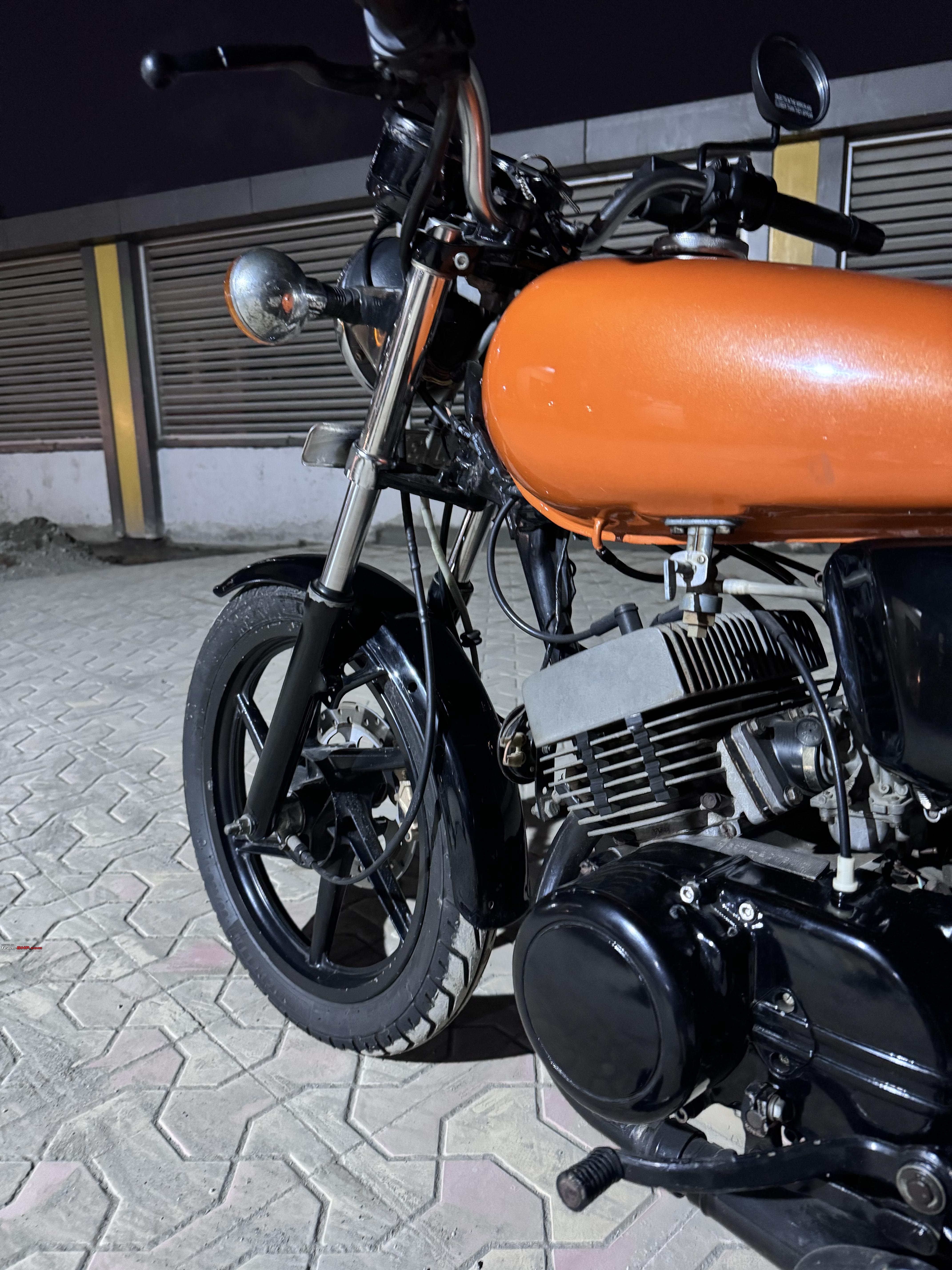

Trying to squeeze in one last ride on all my bikes before they go into their annual monsoon hibernation. Repair works around my parking is still ongoing but at least I can take the bikes out now.
Thanks to all the dust with the repair work not only I had to clean the bikes but even the covers and moving so many bikes around in a tight space is one hell of a task especially in this warm weather which is nothing short of a proper cardio session. Spent almost 3+ hours and managed to ride the 200 within the complex and also warm up the 350. Will be taking out the Italian out on the street first after almost two months and all the two strokes will follow next..
