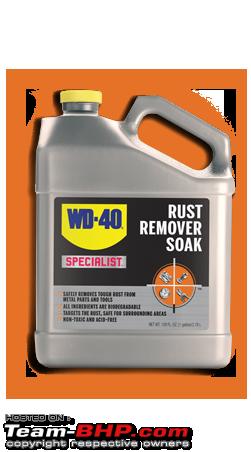

I have every detailing & polishing chemical & tool imaginable in my garage. But when it comes to lightly oxidised rust specks removal from chrome, nothing is simpler and effective than a combo of the items already mentioned in this thread - Diet Coke and aluminium foil from the kitchen.
For removing heavy oxidation cleanly, I recommend using any application specific chemical. Most such methods involve soaking the object for hours or electrolysis of some kind. Here's one such product:
