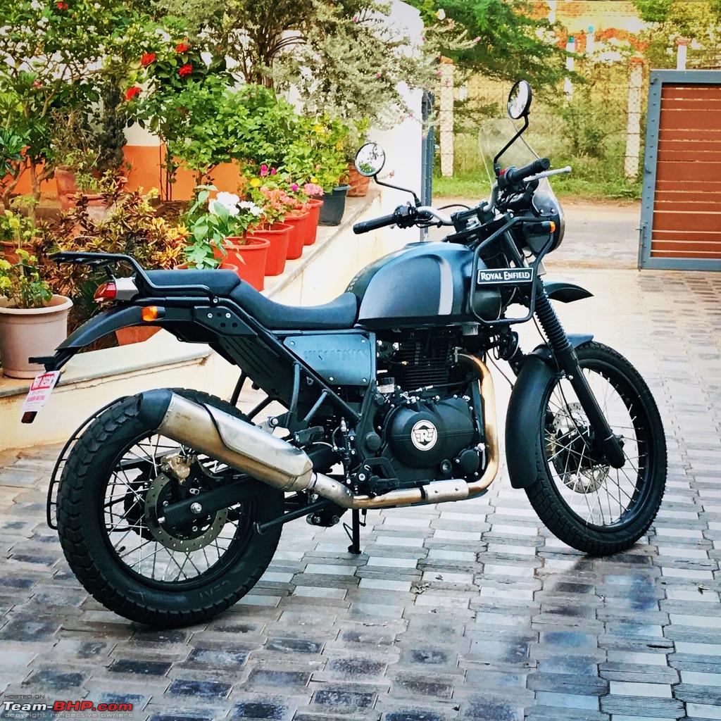

Got my new REH finally. Received the call from the dealer around 3:30pm and the Mrs. & myself were at the dealership at 4:30pm sharp as needed.
This particular dealer's attitude towards the delivery process was hardly much to talk about or remember.
After my 'personal' PDI, they handed over the entire process to a junior staff - who looked quite bored and led us out to where an equally bored looking retail manager stood for a handing over pic and then quickly scooted off.
The junior then ran through (just couldn't follow a word the chap was saying) the mandatory explanations of the controls, etc...including a goof up by mentioning that the tank capacity was 20 litres (didn't bother correcting him - lest I break his pace), handed over the free (joke-of-a) helmet and then ended the ceremony with an abrupt, "okay sir, you can go now".
No kidding...it's not like we wanted to stay longer with these exciting folks!! To be honest, after 57 days of waiting I was happy enough that there wasn't any long drama to put up with.
We left the dealership, the REH hit the road and the joy seeped in, washing away the rather forgettable delivery experience.
I used the ride back to my place to get used to bike's handling and particularly it's seating position. We took a long route home which was a good 20km ride - with the initial part putting us through the evening rush with a couple of traffic signals & the latter part of it taking us through some rural roads with almost zero traffic.
Things seemed to be in order pretty much. The bike felt very smooth, handling through traffic was effortless and surprisingly, the clutch didn't feel very tight as I'd expected.
During the traffic stretch the heat from the new engine (as mentioned by other first time owners in this thread) was felt right through my jeans - I mean, it was that hot down there! Didn't bother me much once the open rural stretches came around.
I seriously enjoyed the unhurried ride through the rural roads, with the wonderful suspension soaking up the mild bumps and actually making me feel like heading for the smaller ditches with a smile. The Mrs. was happy too since she didn't have to hold on hard when the roads got rough. That was one of our priorities in choosing this vehicle - pillion comfort.
Landed back home to two extremely excited kids and their celebratory quick rides followed. But before dusk settled in, we headed out again to the nearby fields and the Mrs. did the mandatory 'me-on-my-new-bike' pics. Changed into a pair of khaki shorts from the jeans and boy, with the summer heat - did that feel good!
And so my Himalayan story begins - I'm hoping for a good share of touring memories which the bike is built for and less of any unwanted hassles the bike was previously infamous for...
Cheers, everyone!
