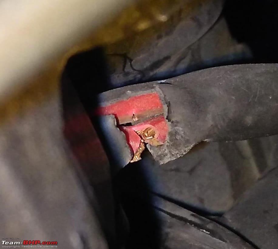

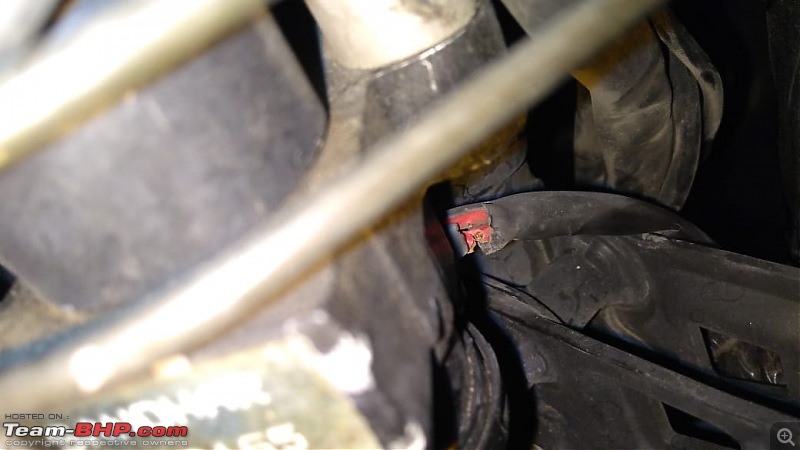

Any one having ignition switch issue?
My switch was replaced once, the replaced switch is also showing signs of fatigue failure.
Outer jacket ,insulation is already gone & copper strands are also braking.

Old 18th December 2018, 11:38   #924
adrian's Avatar
Posts: 896
Thanked: 1,102 Times
re: The Royal Enfield Himalayan thread!
Attachment 1829084
Attachment 1829085
That particular portion is getting crushed between something. Temporary solution - viny tubing. Permanent solution -Route the wire through a new path where it will not be caught between metal parts.
As i said, its causing due to handlebar turning. (wire is bending at same location every time)
Its not rubbing to anything. ( see video here https://www.facebook.com/groups/1853...4742764576862/ )
See the attached pics.

RE guys checked and didnt find any issue which is ridiculous as i know its going to burst some day.
Last time the outer jacket was intact but inner wire was broken due to stress on the wire.
This time its broken near the switch itself.

Old 18th December 2018, 12:22   #927
adrian's Avatar
Posts: 896
Re routing the cable is the only solution. For that you will have to increase the length of the wire as well. Crimp the connection with a longer wire or if you are OK with it, solder with a longer wire.
Sorry for my drawing skills - something like in the red line in the picture
adrian is offline   (3) Thanks

Old 18th December 2018, 21:25   #929
Join Date: Nov 2016
Location: Kollam
Posts: 2,018
Thanked: 6,607 Times
+1
Soldering is key here, anything less than soldering + heat-shrink tubing and you're just asking for it.
Name:  Heat Shrink.JPG
This is a picture of my headlight wire where I'd done a HS1/H4 conversion. Each line was soldered and heat-shrink'ed with a bigger heat-shrink over the area worked on.
After that I had wrapped the entire wire in electrical tape(done after snapping this picture) before fixing it back in the motorcycle.
Better safe than sorry.
Lets see, Have asked for new replacement ..
If not ill have to solder it.
