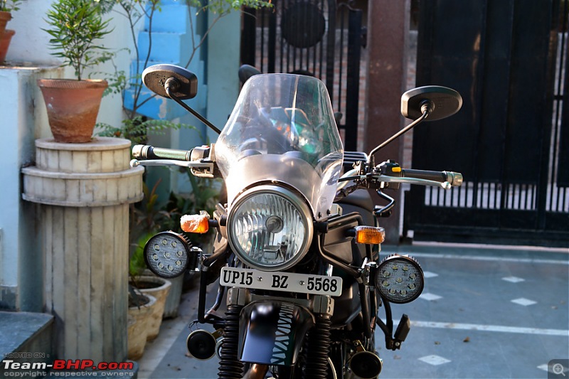

Here are the Mirrors attached to the bike. The Field of view is excellent.
Royal Enfield Himalayan - Comprehensive Review of the 'Desi' Adventure Tourer-gt-mirrors_1.jpg
View from the front
Royal Enfield Himalayan - Comprehensive Review of the 'Desi' Adventure Tourer-gt-mirrors_2.jpg
I felt a little extra vibrations than the stock mirrors while riding back from the dealership. So I checked the mirrors on reaching back home and found these 3 tightening screws at their backs behind the rubber gasket. They were quite loose and I tightened them all up and now the mirror feels quite taut and hopefully will be totally vibe free.
Royal Enfield Himalayan - Comprehensive Review of the 'Desi' Adventure Tourer-gt-mirror-tightening-screws.jpg
Also attached this Heel Guard cum Rear Brake Reservoir Guard from the Continental GT. Besides the functionality it looks quite cool.
Royal Enfield Himalayan - Comprehensive Review of the 'Desi' Adventure Tourer-gt-heel-guard-rh_2.jpg
Here's a broader view of the same
Royal Enfield Himalayan - Comprehensive Review of the 'Desi' Adventure Tourer-gt-heel-guard-rh_1.jpg
