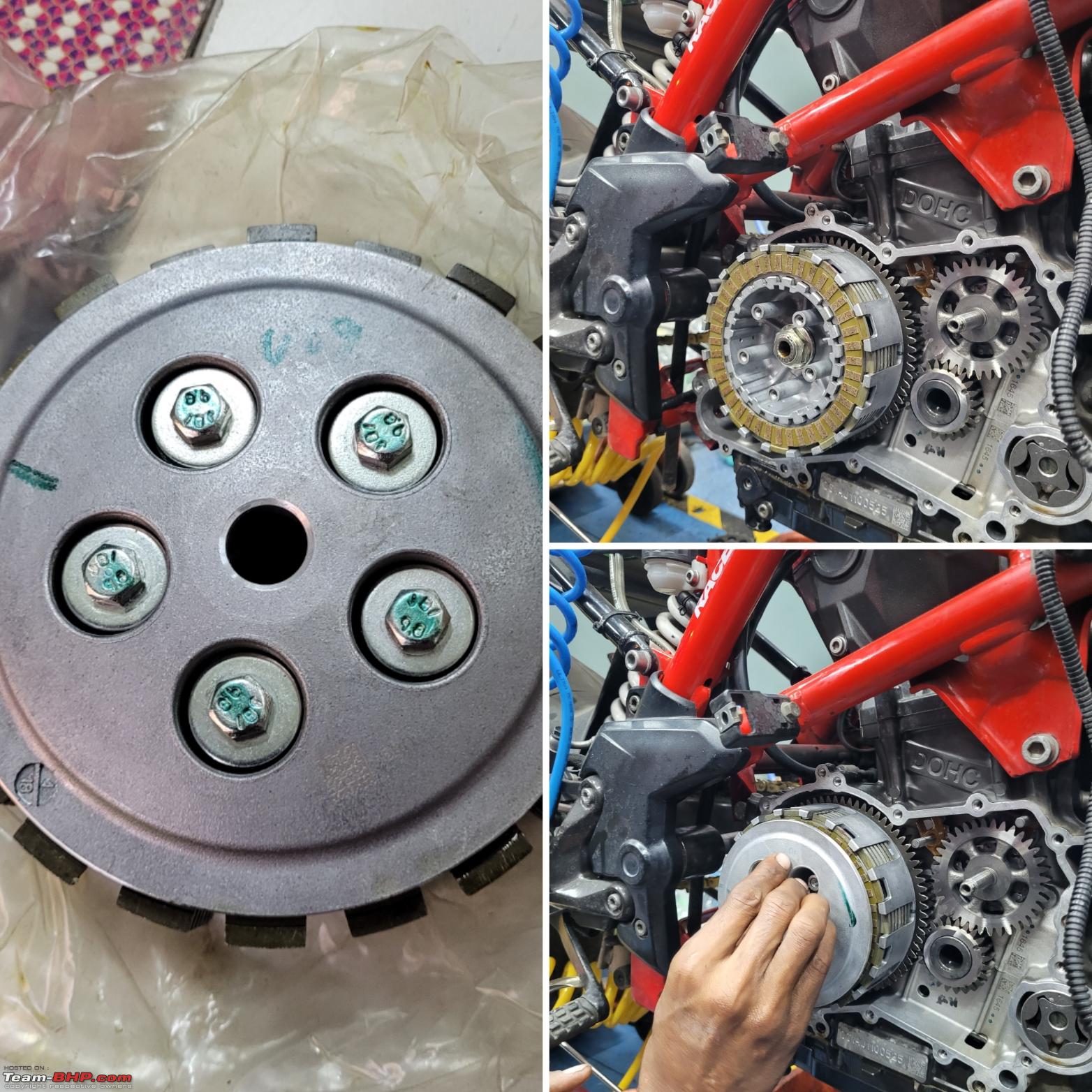

No time was wasted in draining the coolant to remove the clutch cover and check the clutch plate's condition. After almost 35k kms, the plates showed signs of wear. I decided to go for a replacement since anyway a number of parts were getting changed on the bike, and adding a new clutch assembly will contribute to the performance.
Clutch assembly check
Fury in all its glory - My TVS Apache RR310 Ownership Review-img_20221222_111519.jpg

I did not fancy the slipper clutch in the RR310, having ridden bikes assisted with the slipper clutch, I felt they had lesser engine braking, which is obvious. I liked how my bike felt with the standard clutch assembly. After enquiring with a lot of contacts for a standard clutch plate assembly, I was informed that TVS was not sending out standard sets but only slipper assemblies. A good week was spent in trying to source a standard clutch assembly, which we finally caught hold of.
A new non slipper clutch plates assembly goes in
