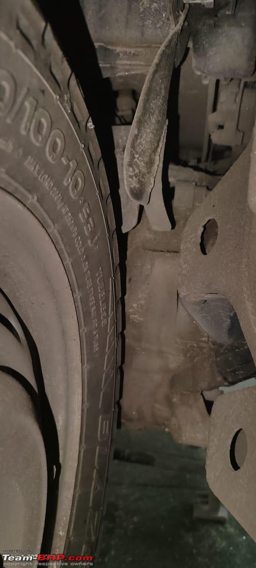

  • I had to install a tube in the rear tyre earlier due to a sidewall puncture. I had thought that when I changed the tyre I'll make it tubeless again. Now at the time of tyre replacement, I noticed that the new rim I purchased had a couple of dents on the side due to the excellent quality of roads I ride on. So the new tyre also had to be tubed. Re-using the tube from the old tyre.

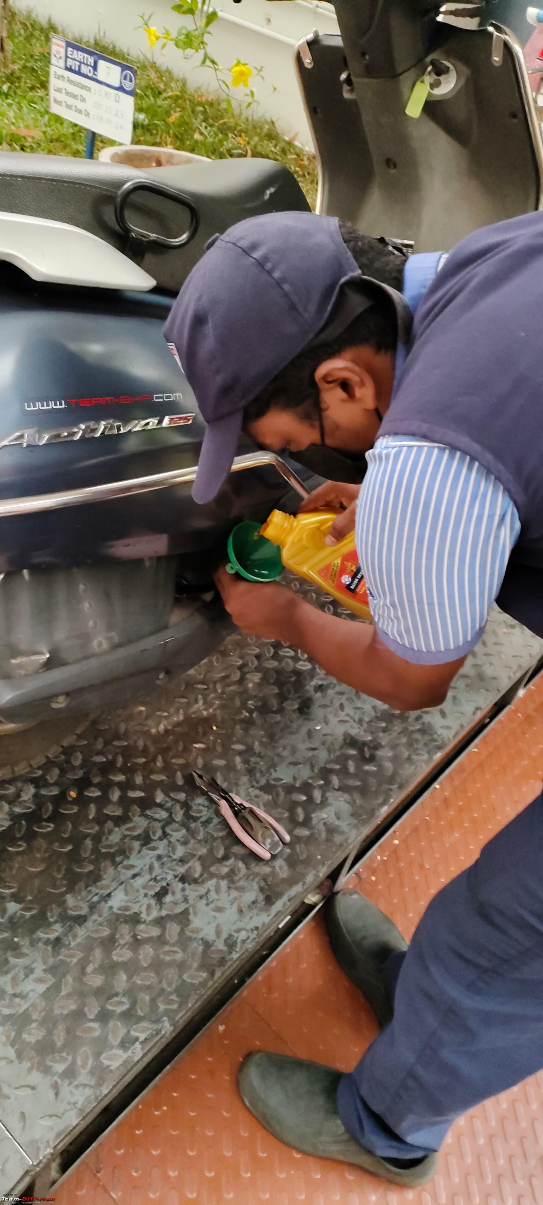

Oil change at HP COCO Pump, Kowadiar, Trivandrum.
Last service for Blu was done at a little over 58k kms and it was almost 3.5k kms since that. Also, last time around the SA had said about engine oil being too low at the time of draining. I was not using Blu much since the accident in March and hence I was not aware of the performance. But Blu was being regularly used by my FIL at my request.
Odo at the time of Oil change.
Blu: The blue eyed boy - My Honda Activa 125 STD-1.jpeg
On the first Sunday of May, I decided to take Blu for a ride since it was the longest I haven't used him since I brought him home and also I kind of missed riding Blu. Immediately up on start up, I was greeted with more than usual vibrations and gruff sounding engine. I shut it down and removed the oil dipstick and to my horror the oil level was at the minimum. There was no oil leaks visible near the exhaust and there were no oil drips where Blu was parked. As far as I know there is no bluish white smoke from the tailpipe too. Now, I don't know how oil levels are dropping.
Anyway, I asked my FIL to not use Blu as the oil level is too low and I decided to get the oil changed at the next possible day as I had to be out of town for work for a couple of days. Since every other part was working fine I decided to get only the oil changed. I had done the same thing in September 2022 and the results were decent so this time around also I thought, why not?
On 8th I took Blu for my office commute and decided I'll get the oil changed on the return journey. I did ride around 20kms before the oil change and hopefully I have not done any damage to Blu's engine. The ride was a little rough with pronounced vibrations on the floorboard and handles. Engine sounded a bit rough and throttle response also felt a little dull.
After I reached the pump, I first topped up Blu and then put him up for the oil change. The technician this time around used the machine to suck out the oil through the dipstick hole and even though I couldn't see much there could not have been more than 200ml of oil. When asked the technician also said the oil level was low but there is no way to ascertain as the old oil is collected in a common tank.
Blu: The blue eyed boy - My Honda Activa 125 STD-2.jpeg
Blu: The blue eyed boy - My Honda Activa 125 STD-3.jpeg
Blu: The blue eyed boy - My Honda Activa 125 STD-4.jpeg
This time around, they used a different HP Racer Skutex 10W-30 oil which came in a yellow (golden?) bottle with 'synthetic technology' written on it. The quantity was same at 800ml. I'm not sure if this is a semi synthetic or fully synthetic or if at all synthetic. This one cost Rs. 375/- (printed MRP on the bottle) which is Rs.55/- more than the one which came in the grey bottle.

The whole bottle was emptied in to Blu and I paid the sticker price on the bottle for the job and we were done. On the ride home I observed that the vibrations have gone down to their normal levels and the throttle response also improved but reminds you that it is still a 7.5 year old. Will update the condition and performance once I ride some more.

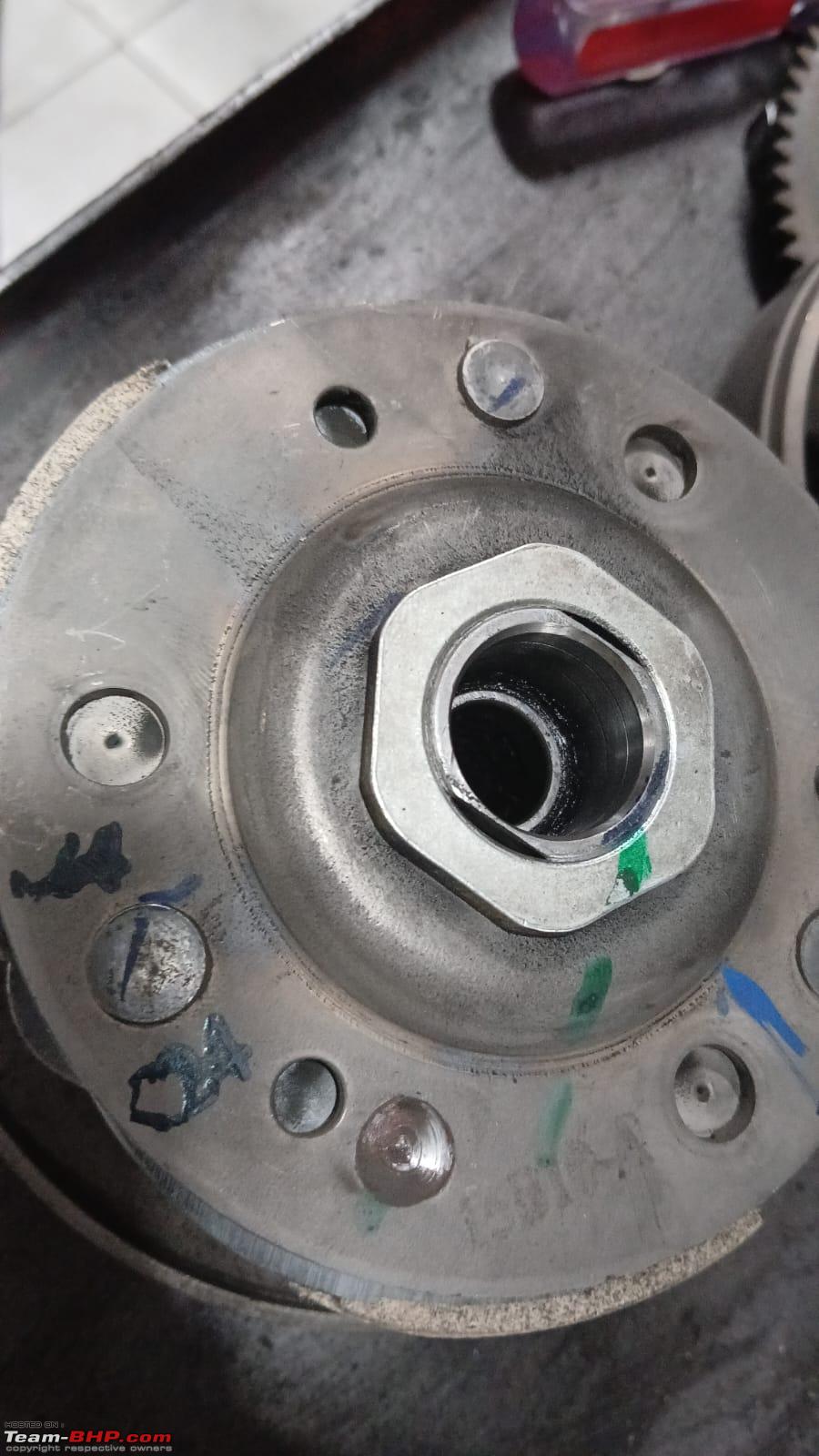

My activa 125 is now almost 9 years old. 32k on the odo. A few months back it failed to start and I gave it to a local mechanic who cleaned the carburettor and changed oil and air filter. It was good for a couple of months. Then rpm started increasing and had a rough feel.
So I took it to the Honda service centre and they are giving me an estimate of over 7000. Excluding AMC.
The parts they are going to replace are in the images. Is it possible for so many parts to get worn out at the same time?
From your post I gather that except the air filter none of the other items were ever replaced in the 9 years of ownership. If that is the case, I wanted to say that rubber parts even when unused tends to wear out by 7-8 years. They will become hard, brittle and tend to crack. It's prudent to change your drive belt and clutch by that time. Believe me, a good clutch in a scooter gives day and night difference in ride quality and power delivery.
From the picture there seems too much dust accumulated in the air filter that has been supposedly used only for a few months. If your riding conditions are not too dusty, then there is a good chance that your local mechanic didn't replace the old air filter. And if that's the case, I'll not be sure as to what all repair/ work he did. Maybe the minimum work would have been done to get the scooter back to riding conditions.
As for the clutch and drive belt, better to replace the 9 year old rubbers. My clutch lasted to around 45k kms and 6 years and I rode with a bad clutch for another 9k kms which I wish I hadn't. Performance dropped and fuel efficiency dropped and it became so hard to accelerate on inclines that when I gave it for replacement, in the 7th year of ownership, the service technician told that the rubber parts in the clutch had been pulverized. My drive belt snapped (most of the teeth came off) at around 43k kms and 5 years. It also had become hard and had cracks in it. I regularly use Blu for 20-30 kms a day and even then the parts hardened. Unused or sparingly used rubber gets hard and crack sooner.
Regarding the brake shoe, there seems to be life left in it and you can ask the technician if it's absolutely necessary to replace it now or can you use it for another 6-8k kms. If that's the case then you will need to replace it after about 2 years, depending on how much you ride from now on.
My advice will be to not think about the losses and get the parts replaced. Then enjoy the scooter without worrying about any part failure while riding.

Thank you BLACNWYTE. Finally I took the decision to change all the recommended parts. It feels smoother than before. Incl AMC and emission cert came to 7150.
I forgot to mention in my earlier post that the mileage was also very low. I started the day with 5 bars and probably travelled 15 kms and it came down to 3 bars.
