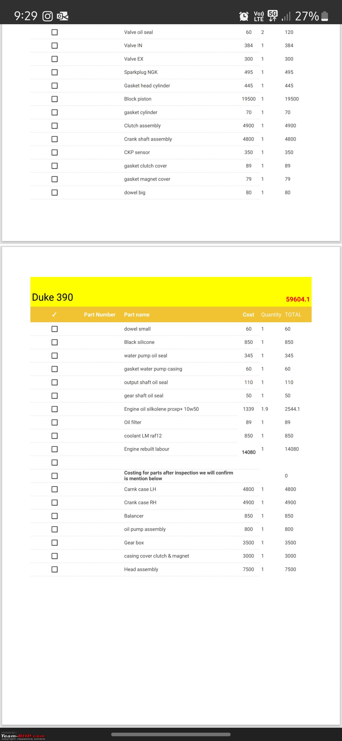

After 2 months of waiting and doing alot of back and forth with Zenngine about what parts needs to be ordered, decided to order the parts in two phases, first is to order the main parts and other small components of the engine and phase 2 will be to order the braking components and swingarm bushes and other smaller parts which might be needed.
Here's the part list which have been ordered for the engine, there's one section in the estimate which will be finalized once the engine will be opened.
My 2014 KTM Duke 390 | Ownership Review-screenshot_20241014_141710_onedrive.jpg
My 2014 KTM Duke 390 | Ownership Review-screenshot_20241014_212939_onedrive.jpg
Next update will be when the engine will be opened.

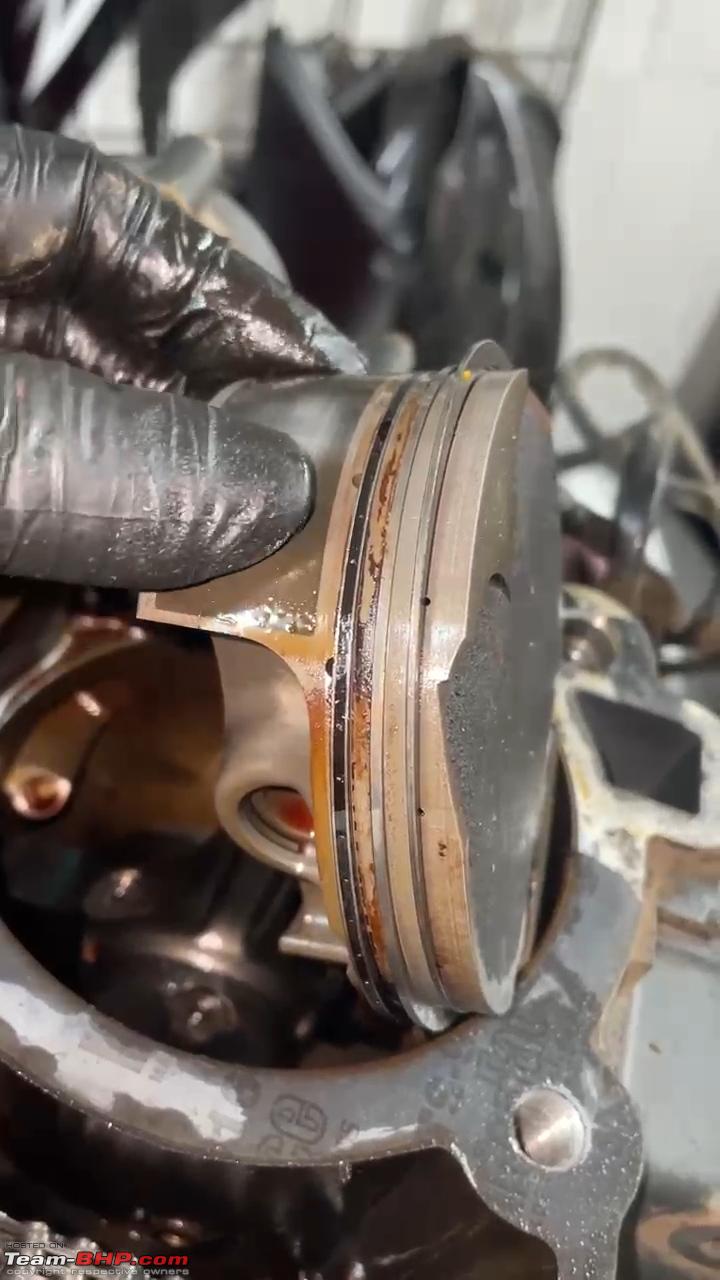

Now comes the other half where more surprises came up
This came as a surprise, the crown of the piston did not have much of carbon buildup with all the oil burning and coolant mixing which didn't show any signs in the oil.
Between the two rings, one can notice the black marks, that is the oil and coolant burning and forming a layer of something and the scratches on the cylinder walls and piston.
