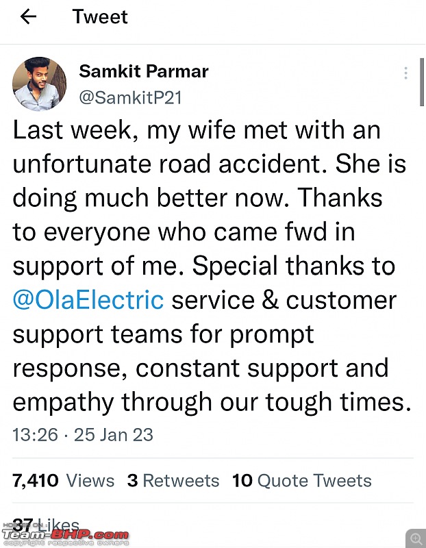

Re: OLA S1: Front Suspension breakage issue!
Not only did Samkit delete his old tweet, he added a new tweet thanking Ola for their support and helping his wife. A complete U-Turn from his original post!
OLA S1: Front Suspension breakage issue!-screenshot_2023012523155932_0b2fce7a16bf2b728d6ffa28c8d60efb.jpg
