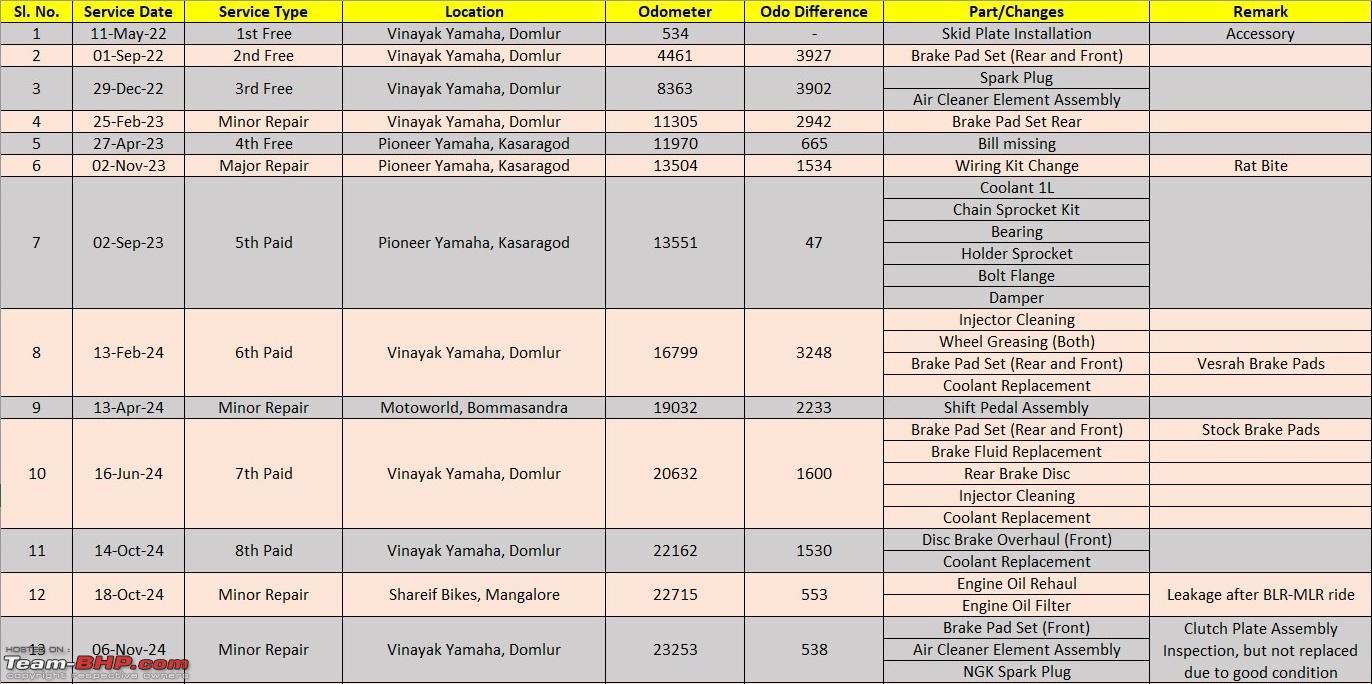

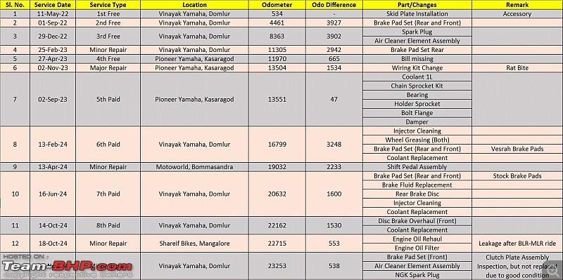

As a quick summary, till date, below parts were changed/replaced during different occasions/intervals:
Yamaha R15 v4 Review | Booking, Delivery & Ownership Report-maintenance_summary.jpg
Please note: I did not include oil change, oil top-up etc because they are taken care during all the periodic services.
