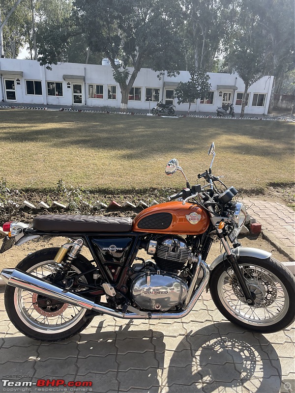

As of now everything is stock apart from few additions which I have made. Replaced the stock seats with bench seats which I found aesthetically more pleasing than touring seats and are more firmer and comfortable than the stock ones. I have replaced the stock exhausts with Powerage ones and they are working as expected.
Problems with my pre-owned Royal Enfield Interceptor | Any insights will be helpful-c7baafc23930455e841460b0bc72d492.jpeg
