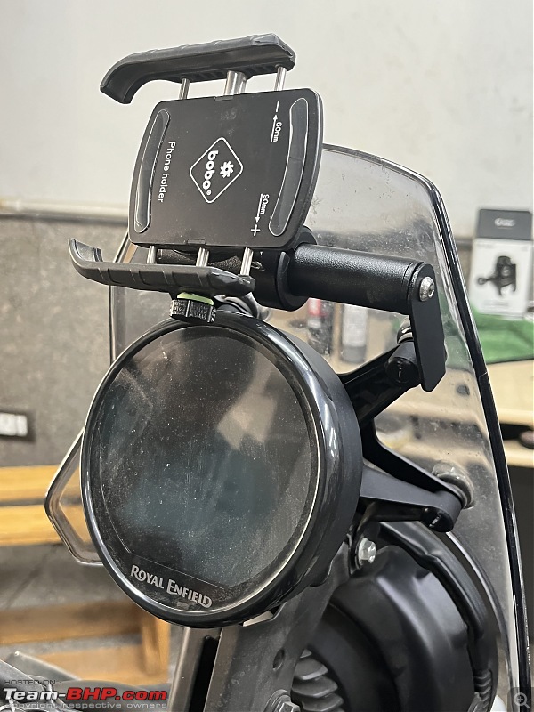

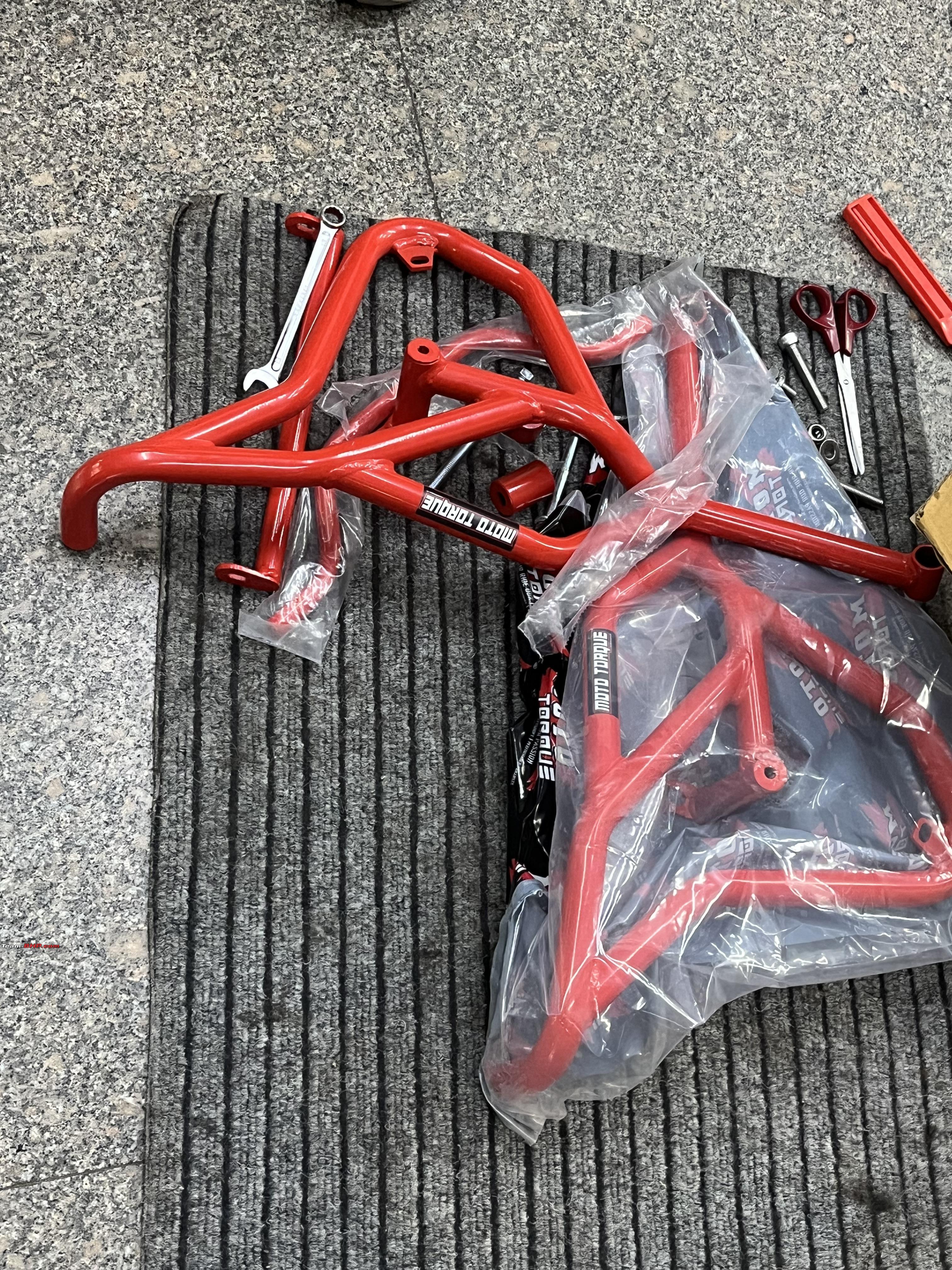

Finally got Moto Torque crash guards installed from Riderz Planet - Naraina. My colour of choice was Red, the guard was ordered and took a week to arrive.
Also moved the maddogs to the crash guard. Got the moto torque GPS mount installed as well.

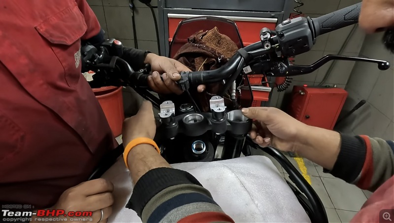

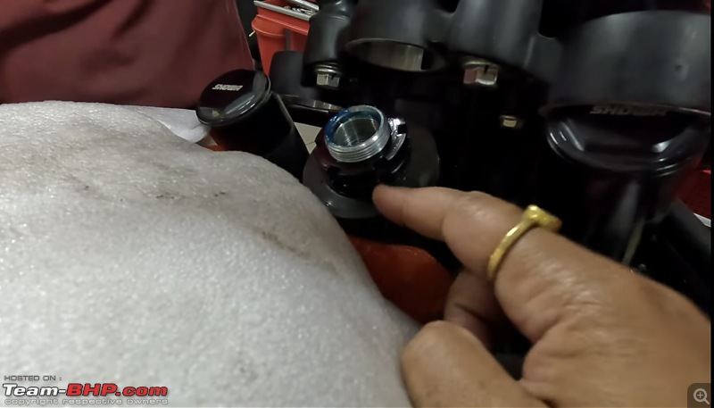

A quick update on fixing the handlebar noise or coneset noise for the Himalayan 450.
I had the handlebar noise “khet khet” sound repeating every 1000 kms approx. This was showing up regardless of the riding conditions as one period of 1000 kms was done in and around city and another close to 1000 was done in a highway route full of off-road elements as seen in the previous post.
The ASS in my place was always quick to respond to the issue and have tried their best to tighten the centre nut or opening it and tightening the coneset nut underneath. There are 2 tightening nuts underneath there - FYI.
Now, during the last iteration I had officially raised a complaint to RE and the service centre team dedicated an entire day to sort out the issue. Finally the issue was identified to be with the tightening nuts.
There is a thin rubber washer between the tightening nuts; it is more like a o-ring gasket which we use with the oil filter cover. Now, this gasket was splitting up whenever the upper nut was being tightened. So since it wasn’t allowing it to be fully tightened, the same was getting loose within a couple of hundred kms.
The solution now is a local jugaad solution. The thin rubber gasket is replaced with a aluminium ring of the same thin size (quite difficult to find one, involved some fabrication work as well from outside). Post that, both the tightening nuts could be set correctly without any issues of washer or gasket moving out of place and upon riding and jumping around on the great indian roads the feel from the handle is absolutely like brand new.
Just wanted to share this. Apologies for the messed up writing.
Since I don’t have the proper pics from my case; here I am sharing the video link of a similar case for better understanding:
Watch from 3:50 mins to 4:10 mins in the video.
