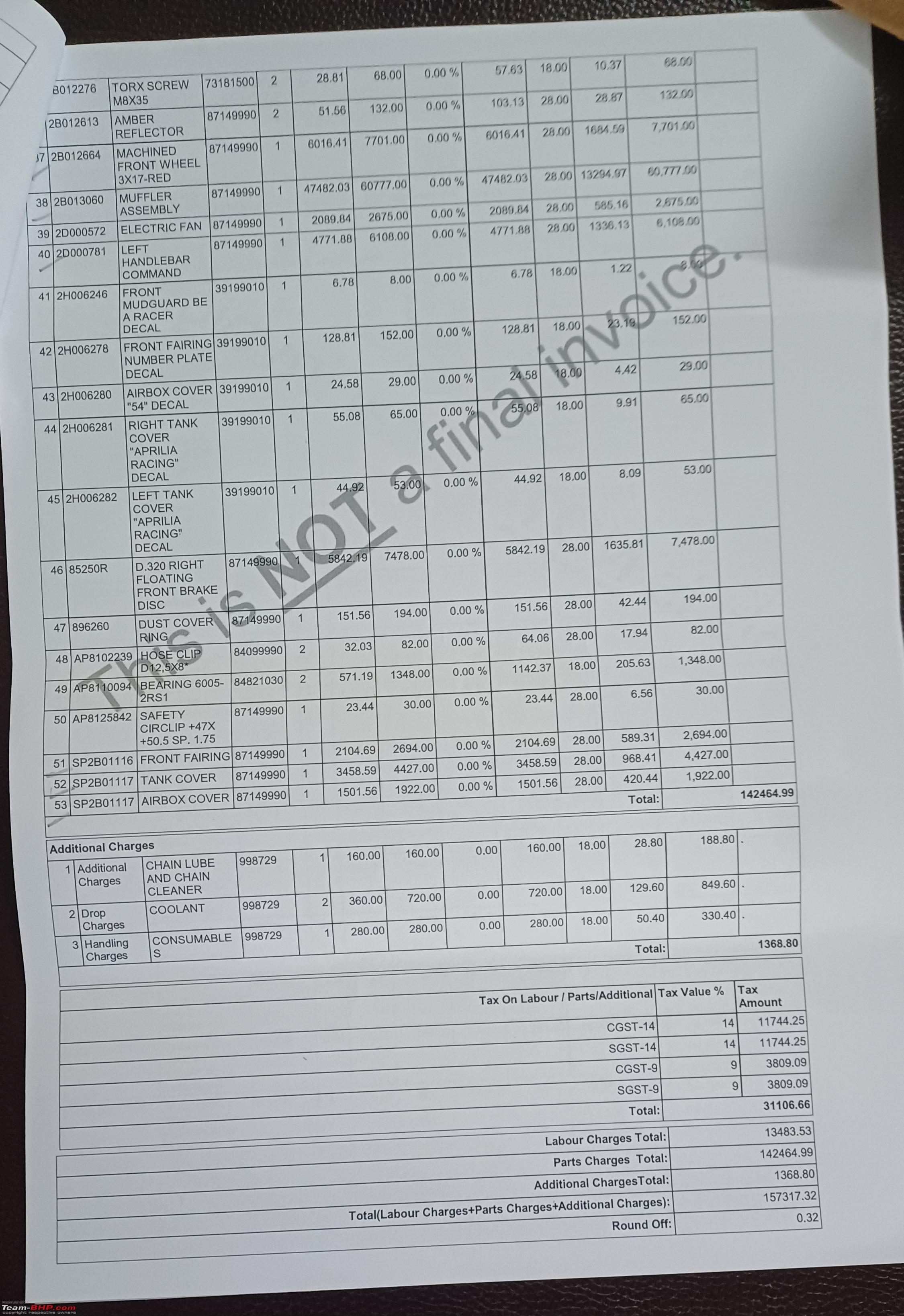

The exhaust muffler assembly is a single unit and costs an eye watering ₹60,777. A supplementary estimate was given which was submitted to the insurance.
Accident repair experience of my Aprilia RS457-screenshot_20250417_164520_samsung-notes.jpg
There was another agonizing wait of three weeks for the exhaust to arrive from the factory. I shot a mail to Aprilia India by early March in an attempt to speed things up. Eventually the work got completed on 18 March 2025, 75 days after the bike went in for repair.
I came from Bangalore to collect the bike, took a test ride and paid the amount. The final bill including labour came to ₹1,57,317.
Final bill Page1
Final bill Page2
Final bill Page3

Thanks for sharing the bill. The parts seem well priced.

BTW, the cost of the exhaust and downpipe is in line with modern BS6 motorcycles. A Dominar exhaust system without the muffler costs 40k + AFAIK. Blame the emission norms and multiple catalytic converters.
