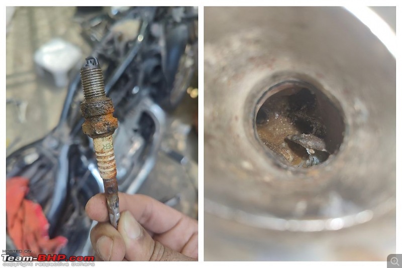

Old spark plugs
That evening as work load was not much, I managed to come home early and went out to pick a fresh set of spark plugs. One thing I noticed was, whoever had worked on this bike prior to me had installed 2 different spark plugs on each of its cylinder head. Although they all shared the same dimensions, it was clear they weren't identical as per the bike's spec sheet. I cross-referenced both the spark plug models and identified a single compatible spark plug. To ensure consistency, I went ahead and picked up a full set of 4 matching plugs. Came home and right away fitted the new spark plugs.

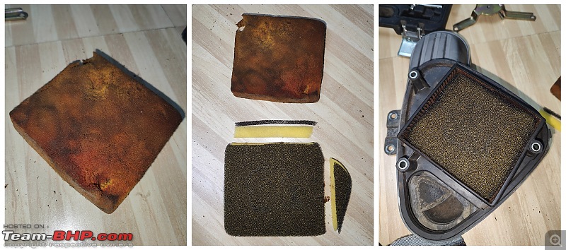

Along with the plugs, I also picked up a compatible air filter, something that had been missing all this while, as she'd been running open without one. According to the manual, the bike was meant to use a paper filter, but at some point ma be during some service interval, it was swapped out for a foam one. That foam, by now, had begun to deteriorateand crumble away. Since an exact replacement was not available, neither in paper nor foam, opted for a larger foam filter and cut it out to fit in the air filter housing.
Installing the spark plugs was a straight forward job. As expected they fit perfectly in the cylinder head threads. After reconnecting all the HT cables, I turned ON the ignition. With a press of the starter button, she roared back to life with a sound track different than previously heard. The engine note was smoother, more refined and far more even, a typical Honda note. I let her idle for a while, then gave her a few revs. The back fires had completely gone, she sounded more strong, steady and full of life. Taking her out for a short spin, I returned home with a wide smile. She wasn't just running, she was thriving.

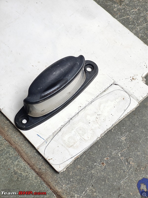

The Number plate lamp also required a replacement. I think sometime back the complete number plate unit was fabricated because original one I found is a complete plastic unit. This unit comes with lamp too. Whatever reason it was, the complete assmelby was changed and with that the lamp too. The lamp used did not have any back plate, so lamp was all dirty from inside and which had also affected the bulb holder. The harness also was not in good shape, So I had to change the complete harness and also make a back plate for the lamp to avoid any water and dirt penetration.
See how the fabrication was done for the number plate mounting. Just above the number plate was the fitment of the lamp
The state of the bulb holder
Used foam board to make the back plate. An easy fix.
Night time illumination of the number plate lamp.
LED is pasted inside the housing facing downwards which is now illuminating even the rear surrounding area
