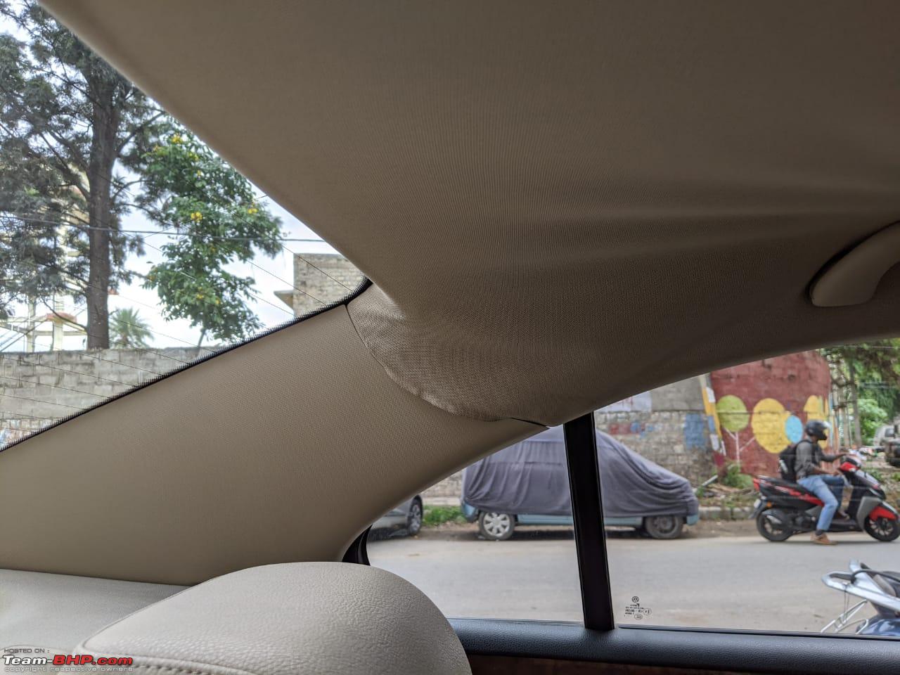

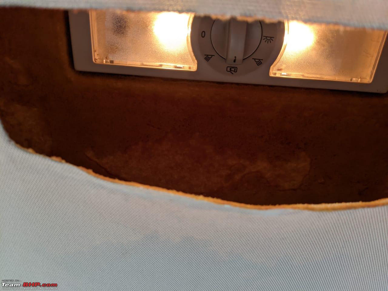

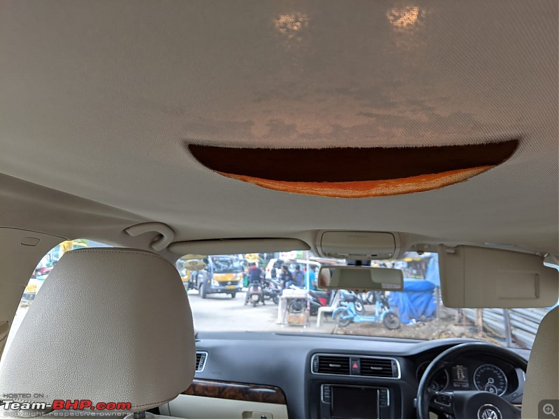

After living with my car's sagging headliner for more than a year, I finally got it replaced. I asked my FNG to get this done since they had done this for a few other cars as well. The fabric color is not a perfect match but the pattern is almost identical. He couldn't source the exact color and told me that this is Skoda OEM; can't verify this claim but the material looks like it's good quality. Posting a few before and after pics.
After my recent trip to Goa, the headliner had almost given up.
The rear reading light playing peek-a-boo
It had started to come out from everywhere
After replacement:
Didn't know the headliner had contours :)
Fitment could have been better around the front dome light/sunglass holder but I can live with it.
The color difference is also visible in the above pic but then again, what would you rather have...a drooping ugly color matched headliner or a slightly different colored but a good fitting one? I know what I wanted.

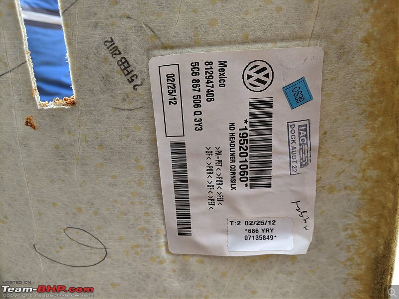

Also, if someone wants to go the OEM route and order the headliner from somewhere, following is the code:
I got the job done for 10k. If you're in Bangalore and around the HSR/Kormangala area, you can get in touch with Ravi from Motovise at +91 9663689392 if you're interested in getting this done.
