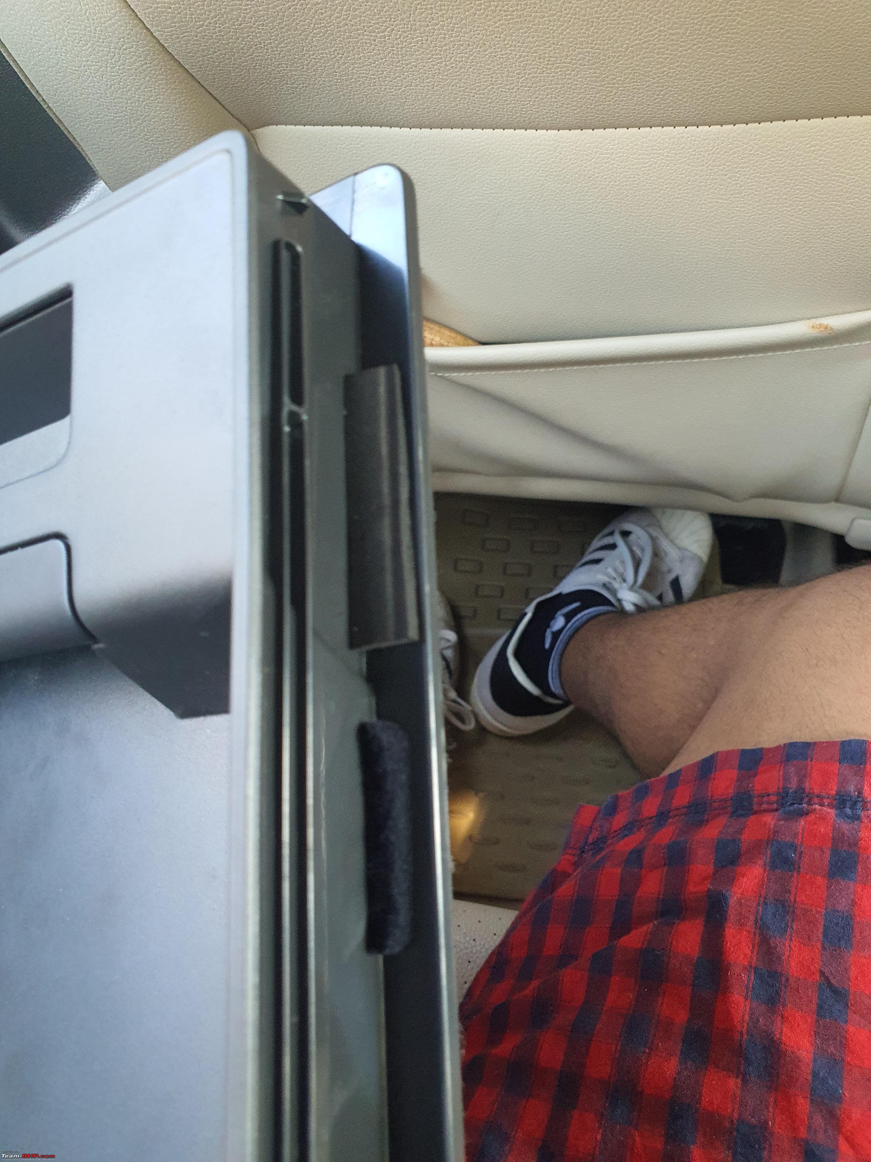

Are you a Jetta owner? Do you like to use the rear armrest while being seated at the back? Do you get irritated by the rattle that the boot pass through plastic trim makes?
If your answer is yes to the above questions, get yourself this product and make your life rattle free-
https://www.amazon.in/gp/product/B08...?ie=UTF8&psc=1
I went with the 20mm width and 5mm thick version though now I feel that even the 3mm version would have most probably done the job. I'd let the pictures do the talking now-
Volkswagen Jetta : Test Drive & Review-20211030_152001.jpg
Volkswagen Jetta : Test Drive & Review-20211030_152137.jpg
Volkswagen Jetta : Test Drive & Review-20211030_152006.jpg
Basically, you need to stick a small patch of the product at the upper part of the plastic trim. It might be difficult to close it the first time after applying the adhesive foam but post that, pressure plays its part(you can see the crease in the foam) and compresses the foam. Money well spent!
