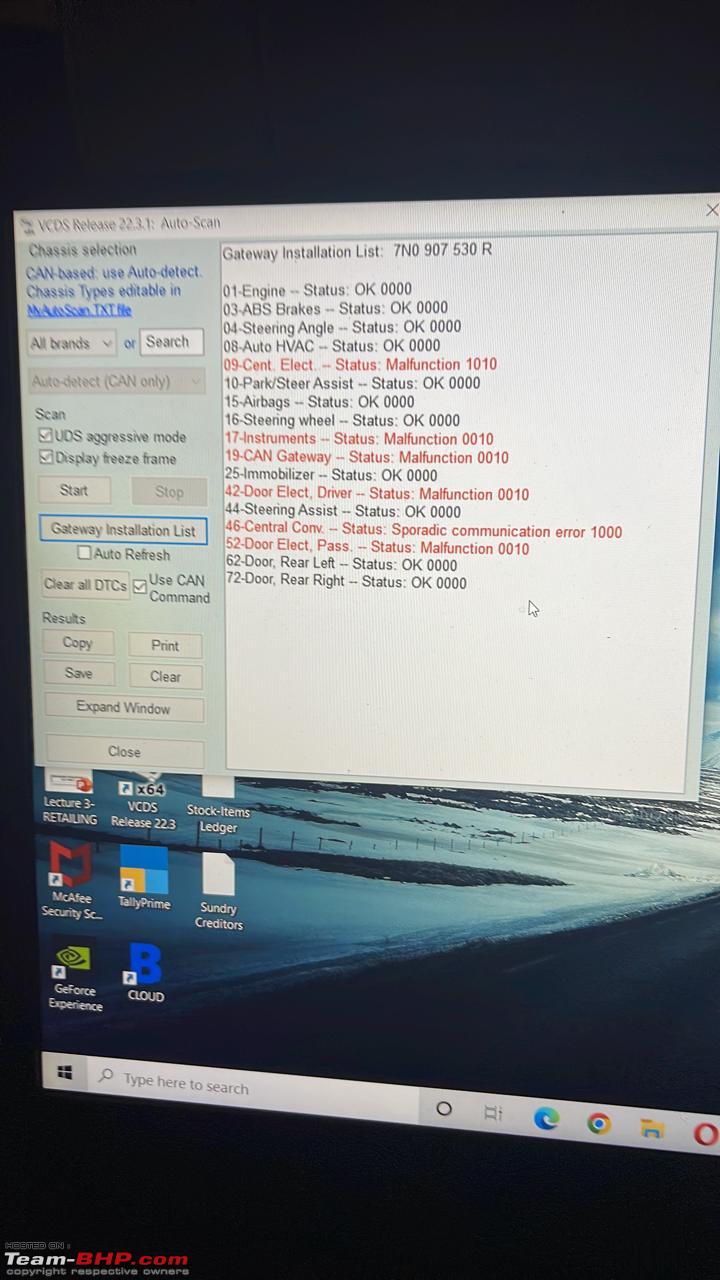

I wholeheartedly relate to this thread, especially with the last few posts, particularly in regard to the "vintage" aspect of an asset like Jetta.
I'll focus on the issue in hand straightaway. The car is fitted with RCD 330G and I had ordered a rear camera from a seller based out of Delhi.
Volkswagen Jetta : Test Drive & Review-whatsapp-image-20220502-12.49.31-pm.jpeg
I was glad to know that the camera fitment wouldn't require drilling any hole of sorts and would simply bolt up on the rear license plate housing.
Volkswagen Jetta : Test Drive & Review-whatsapp-image-20220423-10.49.39-am.jpeg

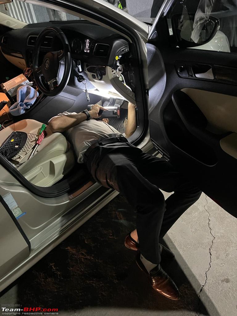

It was supposed to be a straightforward fit. I sought help from a guy working at VW Bhopal who came to my place and wired the camera from the license plate housing to the HU. Post plugging the VCDS cable, I went to Module 56 (Radio) and got the "No response from Controller" error.
The seller (Eurocar retrofits) suggested that I'll have to connect the can wires to the BCM connection so as to gain recognition of Module 56 by the VCDS. The lack of proper pins/connectors proved to be the eventual bummer and we had to call it a day.

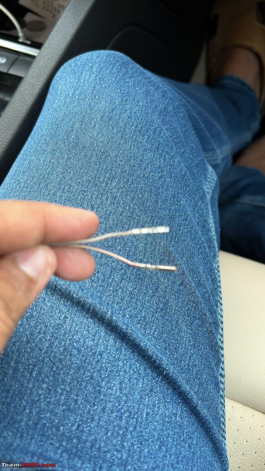

Luckily the seller shipped me the wires with correct pins (sourced from a scrapyard in Mayapuri) couple of days later.
Volkswagen Jetta : Test Drive & Review-whatsapp-image-20220510-5.09.28-pm.jpeg

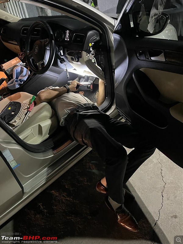

The next task was to access the BCM and subsequently figure out the corresponding pins which took a good bit of effort and patience. The VW guy himself had no prior experience in this regard.
Volkswagen Jetta : Test Drive & Review-whatsapp-image-20220514-3.51.33-pm.jpeg
As per the instructions from the seller, we focused on the 52 pin Connector C
and made the following connections: (entailed splicing of wires)
Pin 15: Orange-green wire
Pin 16: Orange brown
Volkswagen Jetta : Test Drive & Review-whatsapp-image-20220508-10.44.49-pm.jpeg
The pin diagram which we referred to: (not for the Highline variant)
Volkswagen Jetta : Test Drive & Review-whatsapp-image-20220508-10.30.30-pm.jpeg
Conclusively, I'm getting the following errors on VCDS and I've seemingly hit a roadblock as of now.
Volkswagen Jetta : Test Drive & Review-whatsapp-image-20220511-11.29.41-pm.jpeg
Can someone please help me in tackling this issue? I'm based out of Bhopal currently and don't have access to good garages with people having a good deal of experience with VAG cars.
Would deeply appreciate any sort of help in comprehending the attached scan log and in figuring out the way forward.
It seems one of your BCM connectors is loose or not seated properly. I had the same kind of issue with my car when I installed the multi-function steering wheel.
nithishsaba is offline   (1) Thanks

Since the Jetta in India was never natively sold with an RCD330, would you know which radio your car came with before? If possible, please share a few pictures of your radio and the stock radio connectors on your car. This would be helpful to identify if all connections and pins are correct with respect to your car's present wiring. Some sellers have been illegally labelling Chinese RCD360 Radios and selling them as RCD330s and RCD340s which have a different Quadlock compared to RCD330.
On the other hand, not all Jetta owners have been able to get the RCD330 to communicate with the car despite having the appropriate Quadlock and CAN Convenience wiring built onto the vehicle. I feel this has got to do with the version or the firmware of the CAN Gateway. BHPian Vishy76 also faced a similar issue on his RCD330 although his car had a Quadlock right from the factory.
As for the rest of the errors on the autoscan, it could very well be a loose connection on the BCM Connector as BHPian NithishSaba suggested, so please make sure the BCM connectors are properly seated and locked in place, with the help of the locking tabs. The connector might seem to be fully seated, and all pins should be locked into the connector, but there is always a chance of some loose contact even then.
If the rest of the errors go away due to a loose connection and the Radio communication error persists, then it'd perhaps be faster to connect the RCD330 in a compatible Polo Vento and change the coding to accept a Reverse Camera and then transfer the radio back to the car. Hope your issue is resolved soon.
fluidicjoy is offline   (1) Thanks

Going through your log, it appears as though some of the errors have been there from a while, clear all faults, take a short drive and take a scan and post again, as right now it appears as though you have other issues in address 9 which might be the reason for your radio being unable to communicate.
sarfraz1997 is offline   (1) Thanks

Yes you're correct. For a normal video signal input, there is no CAN connection for the camera. However, any OEM radio like RCD330 connected to the car should be CAN connected so it can be coded, tweaked and picked up by diagnostics. The seller perhaps assumed the Quadlock Connnector had no CAN-Convenience wiring inside it. However, a VW car with a Quadlock does have CAN wires in it.
From the scans, I could see that the issue at hand is that the Radio RCD330 is not being read, and hence the seller perhaps tried suggesting connecting CAN wires. Without being detected, it would not be possible to code the 'Reverse Camera Enabled' byte.
