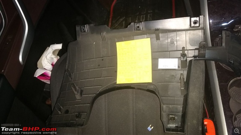

Instrument cluster fuse box panel

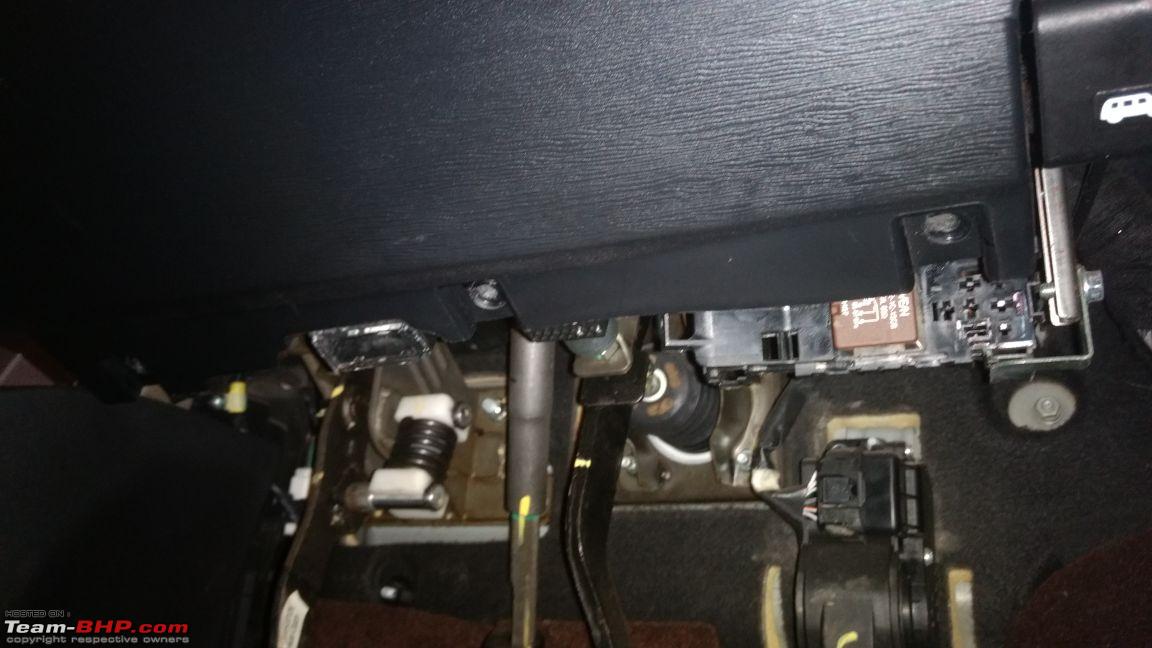

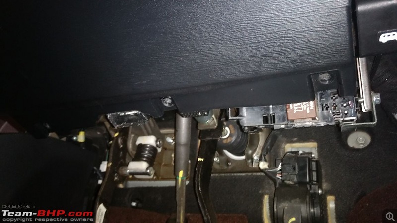

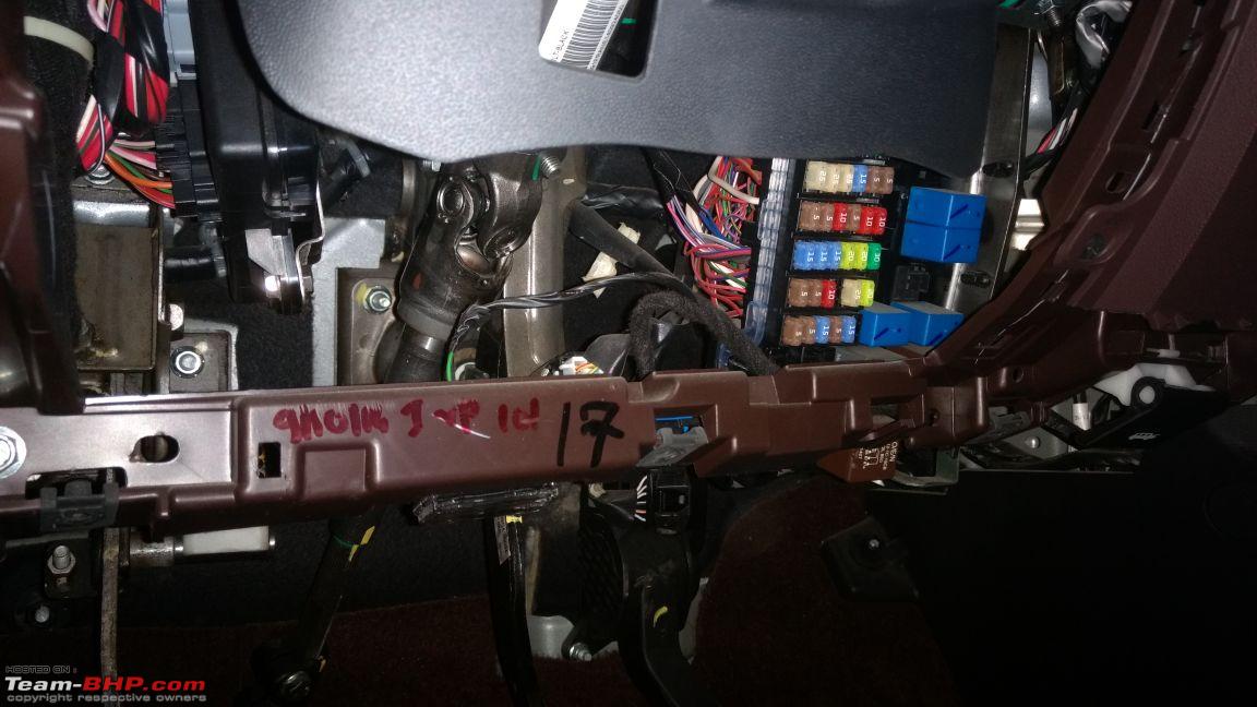

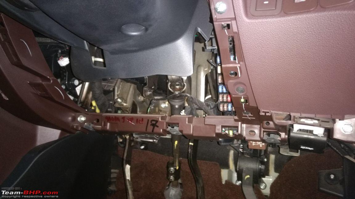

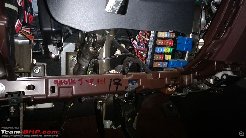

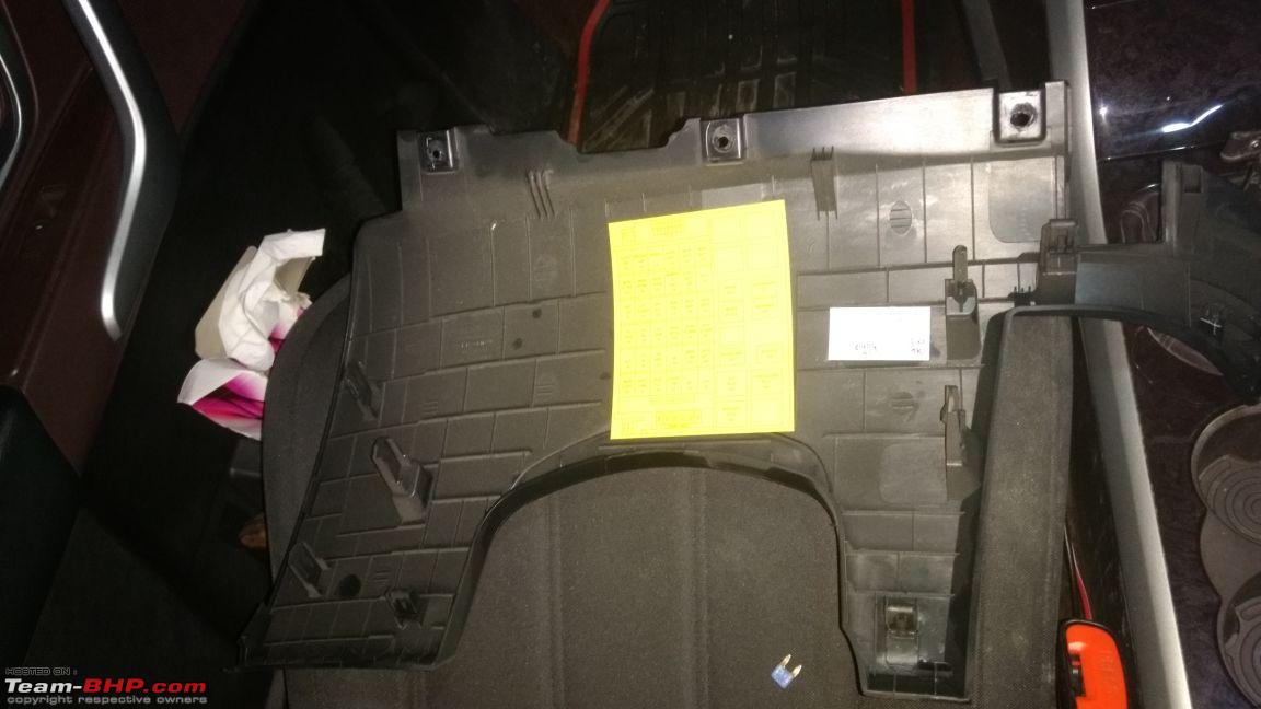

The mid row 12v power outlet was not working in my vehicle, so i thought of checking the fuse. The manual (the book I have and the one online) displayed the following picture for the fuse box location. But it is not the fuse box location in my vehicle(2014 W6). I am guessing it was changed later. Owners of newer vehicles please confirm.
Mahindra XUV500 : Test Drive & Review-instrumentalpanel.png
Saw some relays from below the footwell panel in what seemed to be a fuse panel.
Mahindra XUV500 : Test Drive & Review-xuv500fuseboxpanellocation.jpeg
Mahindra XUV500 : Test Drive & Review-xuv500fuseboxpanelopened.jpeg
Removed 3 screws that was holding the panel and somehow managed to pry open the cover. You need a chunky screwdriver or a ratchet driver to remove the screws as it was pretty tight. Remove the panel from the right corner and believe me, it is not an easy job.
15A fuse for the 12 power outlet was blown.
Mahindra XUV500 : Test Drive & Review-xuv500fuseboxpanelopened2.jpeg
"Driver side panel"
Mahindra XUV500 : Test Drive & Review-xuv500fuseboxpanelbackside.jpeg
The Fuse layout
Mahindra XUV500 : Test Drive & Review-xuv500fuseboxpanelfuselayout.jpeg
Overall a very tedious job for a simple fuse replacement. May be the reason why the location was changed later.
