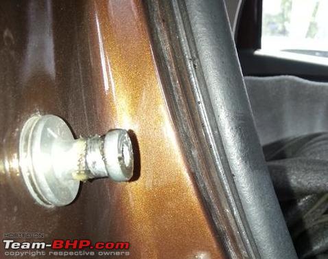

I just got my 10K second service completed though my odo reads only 6073Km. Mine is a 85ps and of Aug 2013 make.
Some updates regarding door rattling and steering kick back which is a common feature of all old gen Dusters.
Total cost of service is Rs.3844/- which includes all the periodical works to be carried out for the second service. I got the rear door beedings changed free of cost. One point mentioned by service advisor on the front door rattling is that the size of the hook on to which the door latches has been increased so that the doors are more securely held tight. He was mentioning some size of 13 which I am not sure of. Attaching pic of what I am referring to. Fortunately my vehicle was already with the updated hook.
Another important update which made me happy is the solution for steering kick back and rattling while turning. The power steering pressure pipe was changed to a latest version which is basically a bigger pipe, so that the pressure does not kick back (as narrated by the SA). I should say it does make a difference and I dont feel any kick back now an the steering itself feels much more lighter. This was done free of cost under warranty.

From my observation, the weatherstrips beneath all four doors are fixed on the doors using rivets. The part has not arrived in the dealership yet, and I haven't bothered to check the price 1300 for a front door piece is exorbitant, I will enquire the price tomorrow.

If not all, they managed to fix many of the rattles and squeaks. However the seat squeaks are back after a 1000 km trip.
I was told that they removed the seats, cleaned up the rails and lubricated them up. I'm going back to them tomorrow to see what they can do about it now.
These are the issues that were fixed:
  • Rattles from both Airbag compartments- These were caused by wires.
  • Rattles from Roof- Added paddings
These are the issues that needs attention:
  • Squeaks from driver seat
  • Creaks from doors/door strikers (Presumably)
  • Creaks from seat belt height adjuster
  • Rattles from boot (I've no clue where this comes from)

The squeaks from the seats can be really irksome. First faced this issue round 3K kms. Had taken the car to the service center and they sprayed 'Carb & Choke' on all the springs and rails. After this the noise did die down for a while completely. Though it has resurfaced (now at 5k kms), it isn't constant and as severe as earlier. Just an occasional squeak. Hope it stays that way.
The rattle from the boot - have you checked that the lug wrench and jack are fixed properly in their slot?
