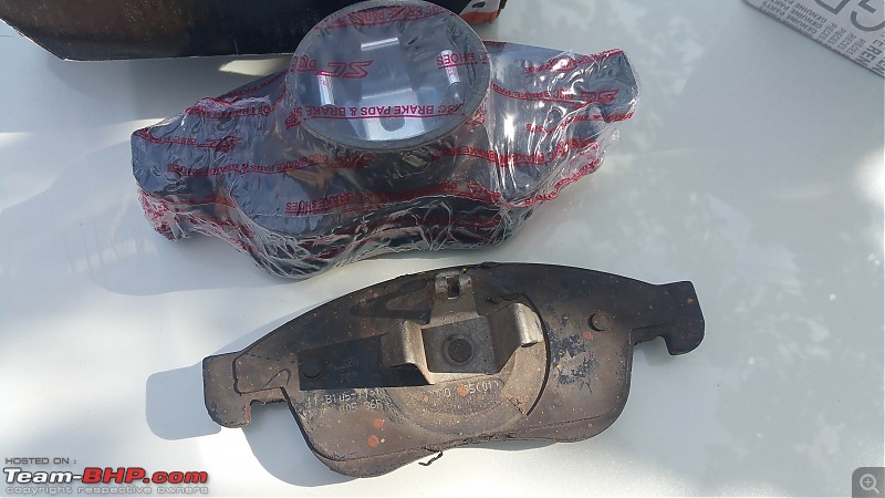

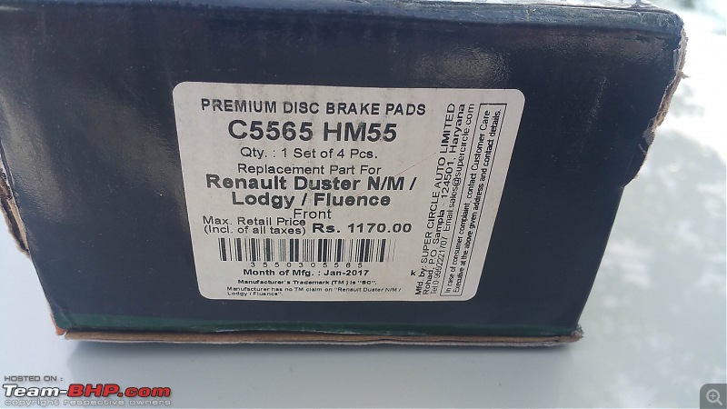

So managed to source the front brake pads locally, priced only Rs1100/- a set! extremely VFM. Though they are still running in the bite feels just like original pads not bad. The dealer just told me to replace to 10k kms before what the original lasted. That would still be 40k kms for me great deal i would say. The originals if i recall costed around Rs 3.5k+labour a set=4.5k odd.
Also got this diesel filter cartridge type for only Rs1250/- thought he box says genuine Renault but no other details, but the quality is good better than the ones i previously sourced which cost more that Rs1750/-. The dealer and my FNG mechanic say that the diesel filter can be changed every alternate service and not every service. He even showed me the older one and said there was not dirt in it at all. Is this a right procedure? as i have changed the diesel filter for every service till date.
Rotors good for another 40k kms as told by the FNG. Also changed the cabin filter, i had sourced this from partsbigboss.in for Rs450/-
Total labour charged for this was Rs500/- along with the previous oil change the total bill for the service was just Rs 4700/- for the 90K kms service. The car is already now at 98k kms. Finally i am not feeling the pinch of owning a duster!Guess my face and wallet both have a grin for owning a capable vehicle.
