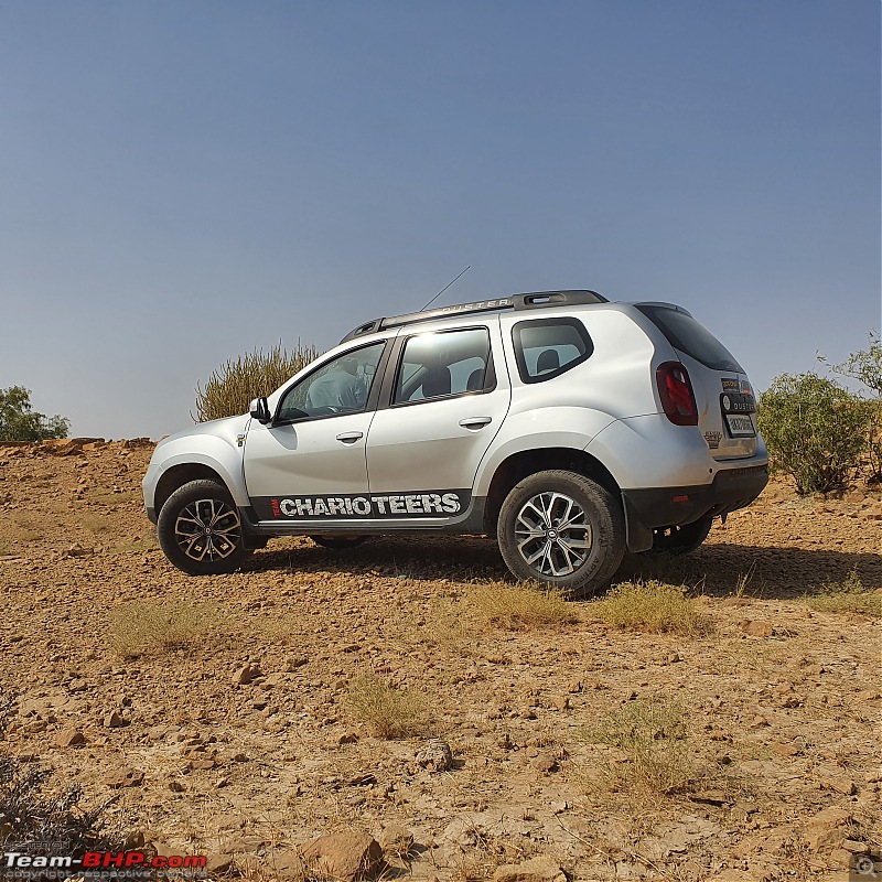

Completed one year on 27 January 2021, celebrated the completion of 20,000 km almost in the same period with a short and quick trip to Jaisalmer. The car has been performing flawlessly. 3 services have been done. Switched to synthetic oil in third service.
A few pictures from the trip:
