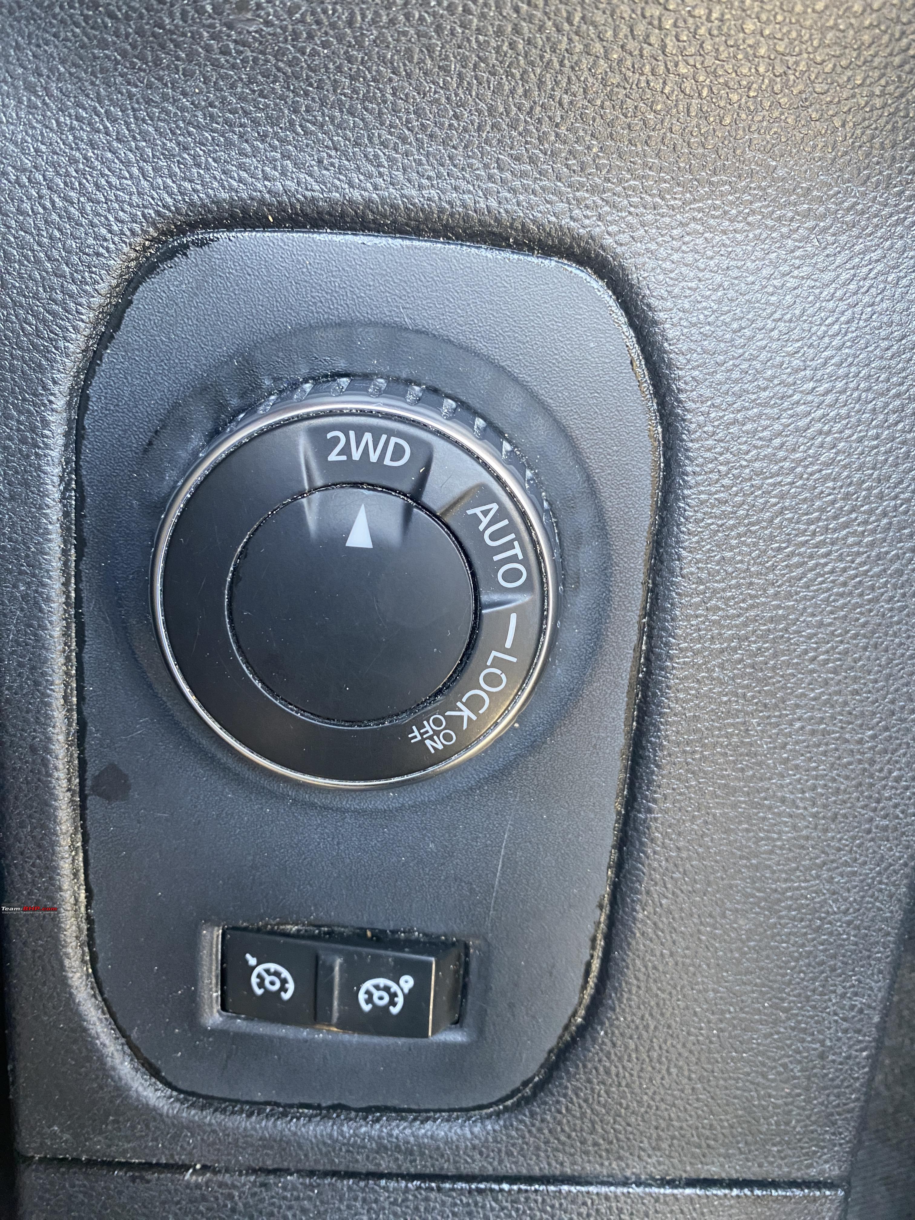

Dear Members
Need an advice for the below problem, although the model I am referring is bit different:
Model : Renault Duster PE (2020) - 4x4 - 2L Petrol - GCC Spec
Renault Duster : Official Review-tbhp.jpg
Location : UAE
Mileage : 158,000km
Usage : Both on road (cruise) at 140kmph and in 4x4 in sand dunes for work purpose.
Problem : Recently, I am encountering a strange problem. While driving without cruise control (cruise control is ON but not set on any Speed), it suddenly shows notification on MID display "Cruise Control ON" (like the button is being pressed automatically - ON-OFF) and vehicle gives a jerk.
Renault Duster : Official Review-image-5.jpeg
(Located behind the gear level - between two seats)
Service center checked via computer and did not find any issue and even the error log is empty.
Renault Duster : Official Review-photo20230411131007.jpg
Request your kind opinion based on your experience.
mbhalara is offline
