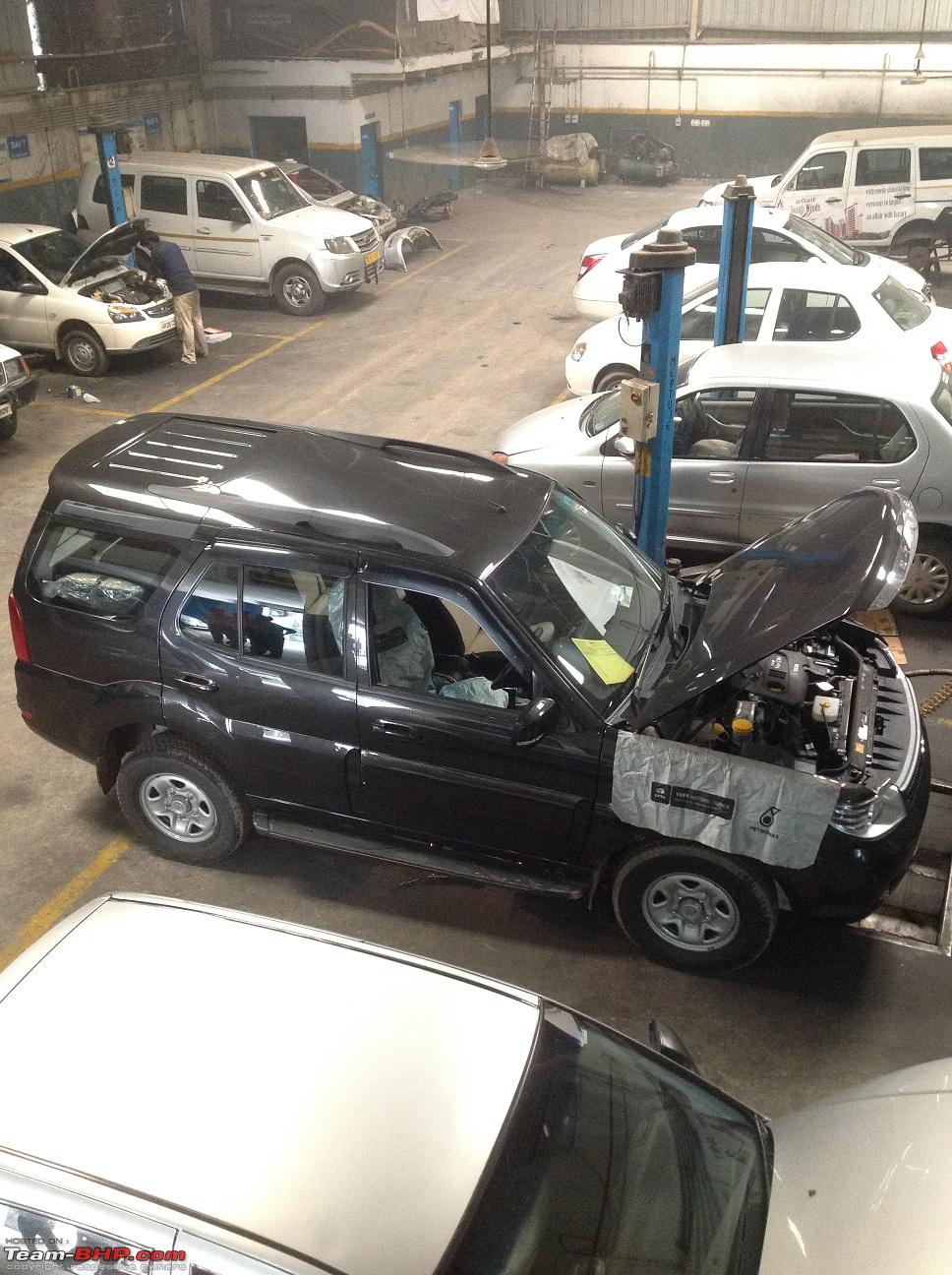

As I mentioned in my earlier post that the TASC 'miraculously' arranged for the parts, I took my Black Beauty (BB) yesterday to them and got the 'infamous' CRB replaced under warranty. By the way, I would like to share the awesome experience with the TASC - Delta Vehicle Support, Gurgaon yesterday. Although, this episode started on a bitter note, the ending was great and I guess that's the most important thing. Actually, the fault was at the dealer's end as they passed this vehicle in their PDI even though it had a CRB noise issue and when I took my vehicle to Delta for the 1st service (as its very near to my place), they could've simply washed their hands off and asked me to go to the dealer instead and they would be probably justified too. However, they took the responsibility as a TASC and went ahead to solve my problem. I found their team very confident and experienced too. The senior tech, Devender took my vehicle for an extensive TD and he immediately diagnosed the issue. Also, after changing the CRB, he again took my BB for a TD and said that there is a slight noise still (which even I failed to notice) and he took out the entire the drive shaft, checked it thoroughly and found that it had been misaligned (probably during assembly):Shockked:
Anyway, after spending the entire day at the workshop, my BB was finally handed over to me around 7:00pm and the gearbox was absolutely silent. For me even if a product is not that great but, comes with a great after sales service, I'm a happy man! So, round 1 goes to Tata! clap: Hope the service level is consistent!
Here are some pics from yesterday:
My BB waiting for the operation to begin:
