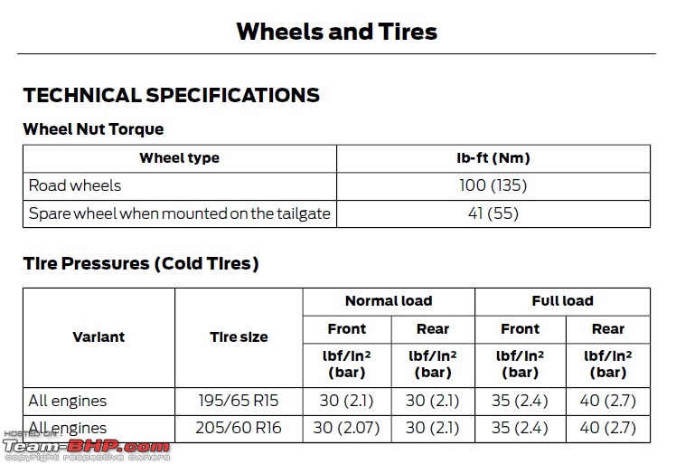

Ford recommended tyre pressure is 30 for normal load and 35/40 for full load. Attaching the section from owners manual. I also keep 32 all around and mostly travel single or with a co passenger in front.
