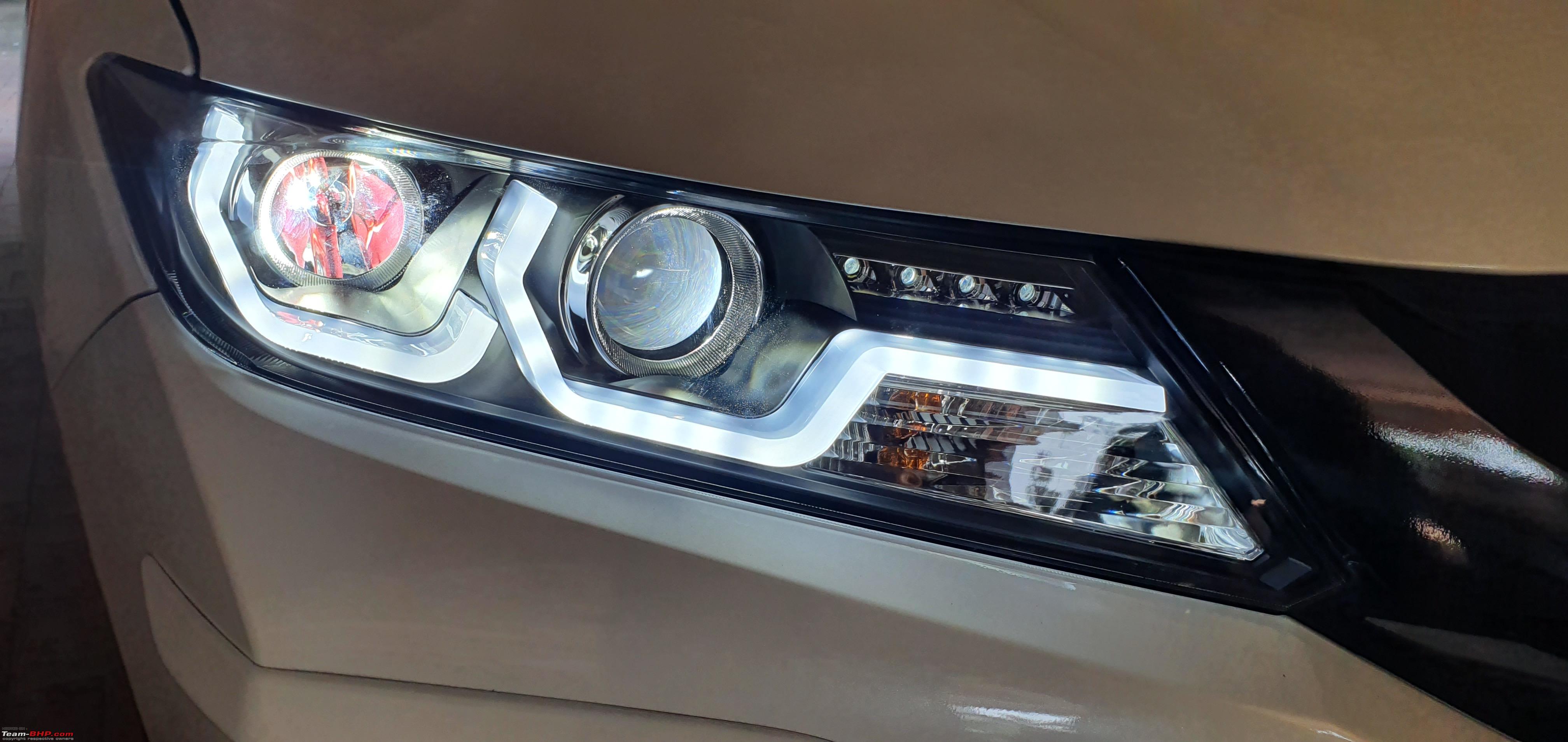

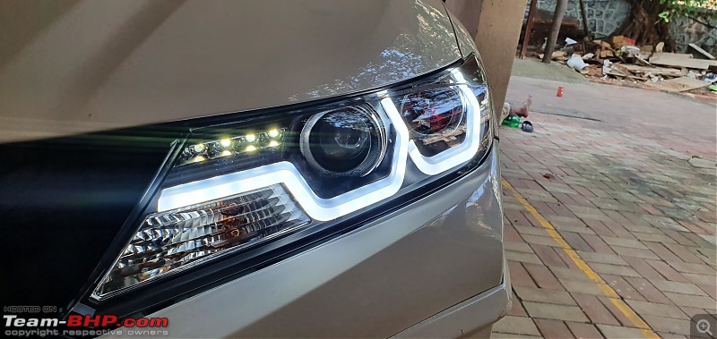

Added these fancy looking headlights to my city, easily replacing the previous best upgrade to take the throne.
The DRLs have been wired to the power window switches, which allows them to:
  • Turn on when ignition is on
  • Remain on when ignition is off
  • Turn off when either, 10 minutes have passed since ignition off, or either of the front doors are open.
This set looks really mean IMHO, while complimenting the black grill and roof.
Attaching pictures:

Hey! Just wanted to ask about the headlights. How much did it cost and is the installation easy? Because I live in a remote area, I’ll have to do it myself. Plus there were some bad reviews about the DRLs malfunctioning. Can you please clarify me about it?

Yes,
It costed me ₹22,000 for the headlight itself, and ₹5,500 per set of LED bulbs. If just installing without modifications like LED or DRL being always on, it is fairly plug and play. Bumper needs to be lowered and that’s it. You will need to reuse old mounts.
Installing LED requires the dust cap to be drilled.
For the DRL to be always on, need to take connection from the inside fuse box (OUTSIDE IS POWERED AFTER CAR IS LOCKED).
Otherwise it’s fine, I didn’t face any troubles.
DRLs are good, but bright for night time.
It also doesn’t come with beam adjustment so you have what you have.
It’s best done professionally, I’d not recommend this as a DIY

Thanks for the info sir. Have been eyeing for those headlights for a long time. Can you send me the shop's details? Also would he ship them?
