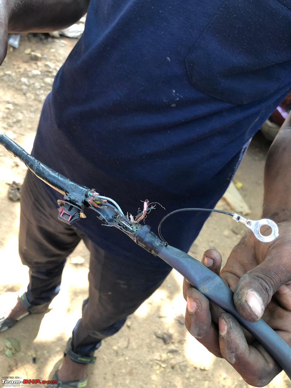

Rodents have attacked our Ciaz AT and the car is not cranking now, the fuel gauge shows empty and low fuel icon flashes constantly.
Car had a full tank of petrol on the last run. Family couldn’t smell any petrol leaks as well. Checked the fuel pump related relays, they look fine. No visually bitten wires as well, other than windshield washer tubes and the sound dampening material.
Any idea what else could I check before I call for help?
Perhaps the rats sat in the space between the fuel tank and seat and bit everything there. That answers your doubt of why the fuel gauge shows empty, and the fuel pump isnt supplying fuel to the engine. Check below the rear seat. The fuel pump harness is most probably no more. The low fuel light blinks when the data from the fuel level sensor isnt correct. If not this, then you should trace the same harness from the fuel tank to the engine bay. Somewhere in between, you will definitely come across the workmanship of the rat. Also check if the fuel pump primes when you turn on the ignition.
Thank you. Makes perfect sense.
The fuel pump doesn’t prime when I turn on the ignition. Tried removing the seat squab but it was bit tricky. Shall take it to neighboring FNG and get it checked, and the wires patched up. Shall update once done. :thumbs up
Update: Car was taken to a known FNG since the fuel tank/wiring for fuel float/fuel pump is inaccessible from within the cabin/rear seat in the Ciaz. We removed the rear seat and found that it had full metal base and no opening. In Fiats, the tank sits flush with the cabin and once the rear seat is lifted, the wiring can be accessed.
Here in the Ciaz, there is a gap between the tank and cabin good enough for rodents to live.
Fuel tank was brought down and we found 6-7 small rodents in there along with lots of paper and random stuff. The damaged wiring was patched up as getting a new harness meant more downtime (more than 20 days). Car is running good now.
Will probably get them replaced sometime later.
