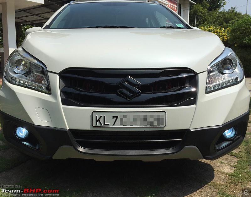

I have a 1.6 S-Cross and have made a few cosmetic changes to it. But it's face still is quite boring and the headlights seem to be out of proportion. I've been thinking about painting the black fiber trims to the body-color.
This is the current setup
Maruti S-Cross : Official Review-img_e3519.jpg
Maruti S-Cross : Official Review-img_e3521.jpg
Maruti S-Cross : Official Review-img_e5948.jpg
Maruti S-Cross : Official Review-tdgg9566.jpeg
Recently came across the face-lifted version, painted exactly how I want it to be done. IMO the car looks much bigger and classier with painted trims.
Maruti S-Cross : Official Review-img_4979.jpg
Maruti S-Cross : Official Review-img_4981.jpg
Maruti S-Cross : Official Review-img_4982.jpg
Okay, so the new one looks good from the side, front and decent from the back. The question is, would my car, with the boring face, look equally good? My cousin PS'd my car. What do you guys think? I'm also thinking smoked headlights too, along with the white inserts.
Maruti S-Cross : Official Review-img_4998.jpg
Maruti S-Cross : Official Review-img_5010.jpg
Jose Peter's Stealth-Cross PS'd to white
Or should I stick to the current setup?
PS : Moderators, please remove the post if required.

Hi, IMHO the modified face-lift S-Cross that you have posted looks overdone.
Please get the below done on your steed.
a) Smoked Headlights/Taillights
b) Piano Black ORVM
c) Piano Black Roof Wrap
d) Roof Bicycle Carrier
e) Painted Brake Calipers

I quite like the current set up - the car looks menacing to say the least.
I fear painting the trims may just make the car look too bulky from the front and rear where the black sort of helps it look that much slimmer.
What about other options like smoking the headlights and tail lights (only the chrome trim inside, not the actual glass - Kinda like the Rapid Black edition), along with the roof, mirrors, and spoiler?
I had considered painting the headlight assembly to black. But I’m not exactly sure whether they’d look good in flesh, on a white car. On a darker shade, it would have blended in perfectly. The headlights are awfully big. Still confused whether to go for it.
Trying the get the euro spec spoiler. It’s smaller than the ones available in the ainsian market.
Roof and mirrors? I’m not sure. Black mirrors and then white support stalks would look out of place, IMO. I’d have painted them otherwise. Not a fan of black roof :P
Thank you for your inputs :)
